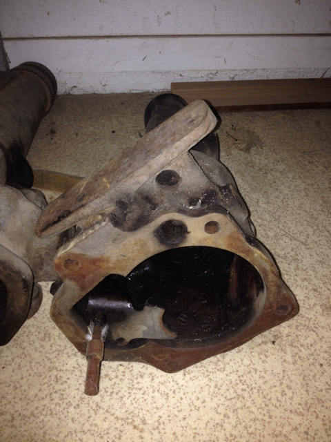

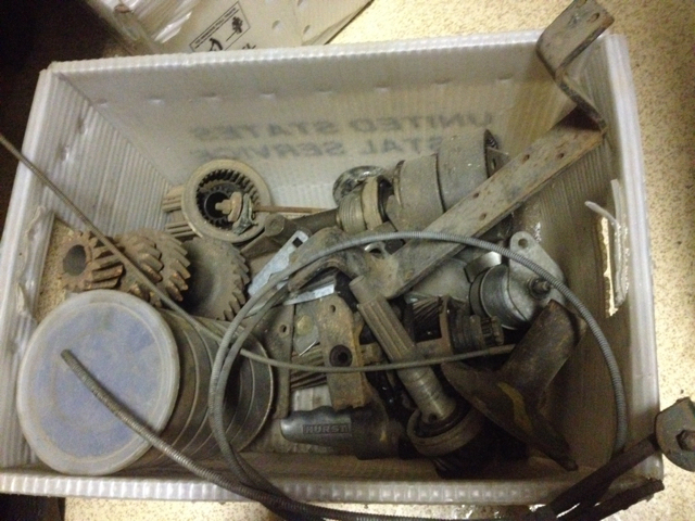

    A friend of mine has a couple of boxes of that stuff he wanted to sell me, but I don't have a trans to attach it to... ImageUploadedByH.A.M.B.1436245757.445072.jpg

    Sell? "Give" would be more like it. Seriously, over the last few years, I have come across a couple of complete OD transmissions that I was able to purchase at very reasonable prices Folks these days don't seem to understand what they are, and want to get rid of them because of the unknown "levers and cans" on them..

    I think if it were me, I'd probably not post pics of stolen MTE (material transport equipment) that I had ripped off from the federal government (USPS) on a public forum. There may be prison & fines in your future. But, like I said, "if it were me."
  21. Mike51Merc
    Joined: Dec 5, 2008
    Posts: 3,855
    Mike51Merc
    Oh crap, I hope the milk crate police never visit my place!
