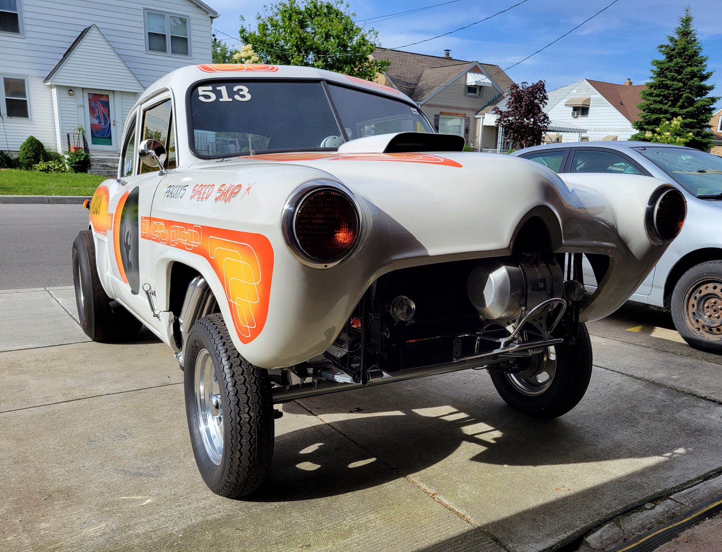

    If you decide to go tube axle, 48 inch king pin width is almost identical to stock Henry J width.
  6. Such a *****in car!!! I've seen this before but dont know much about it. Is this your HJ?

    I used an F1 axle and springs on my Henry J. It's not a direct fit but with some fabricated mounts it worked well. IMG_3900.JPG IMG_3901.JPG
    Psycho Deville likes this.
  11. Awesome!!! I'll be doing the same. @28rpu What did you do with your rear suspension?
