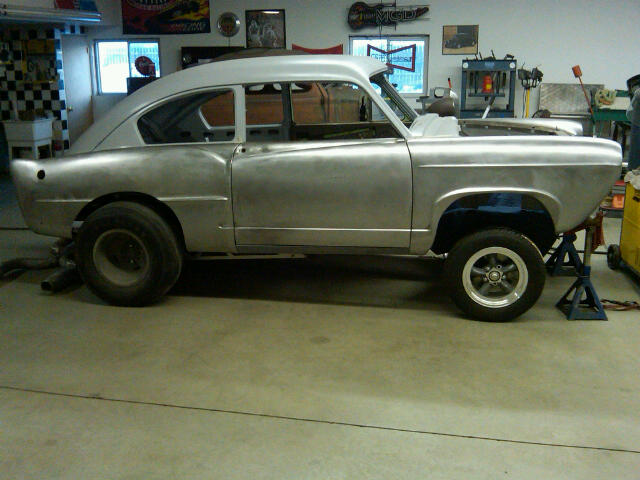

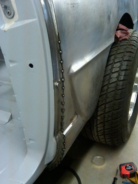

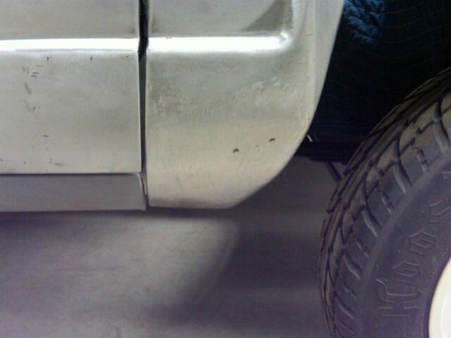

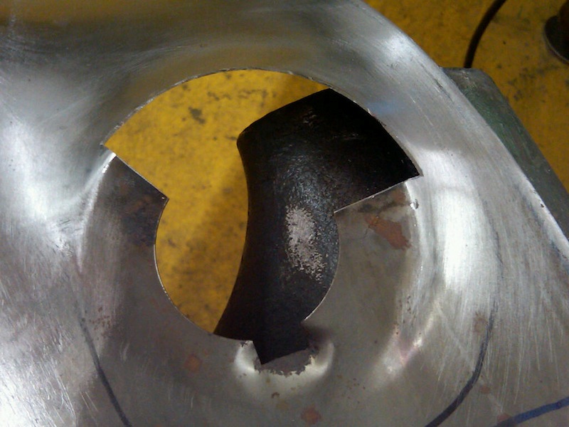

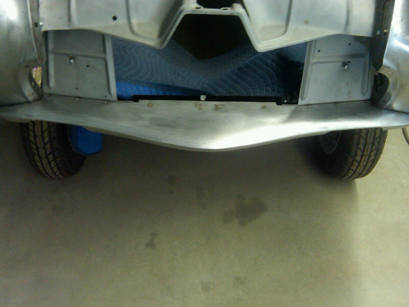

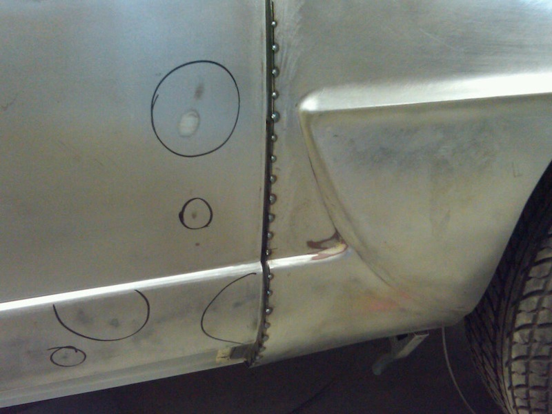

    Well i have finally started work again on the HJ.:D It has been awhile. The thumb took way longer to heal than what the Doc said and it is still not what it use to be before the damage. Don't think it will ever be 100% again. So here are some pics to up date you all.
    I had some help from my son one of his friends and a good friend of mine, setting the body back on the finished frame i then started the metal work on the p***engers side. This included removing all the dings and dents, two lower patches on the door, front and rear patches on the quarter panel, lower patch on front fender, extending the bolt flange on the rear quarter, and cutting the front edge of the quarter to reset the door gap. All i have left to do on p***. side is finish the radius on the quarter and make a new mounting bracket for the lower front fender to be bolted up. I have posted more pics of the progress in my album. Hope you all enjoy!

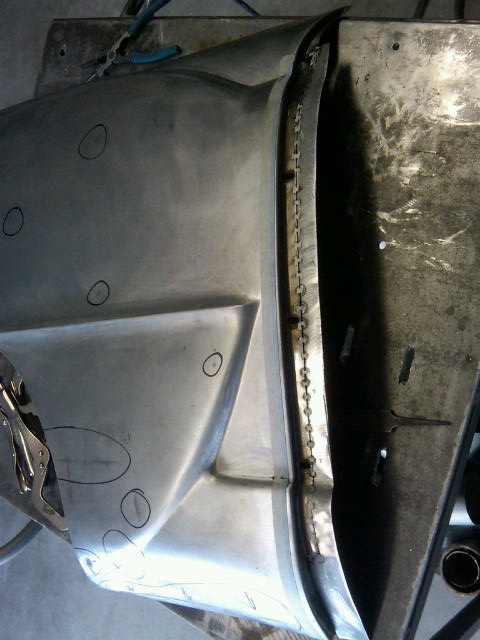

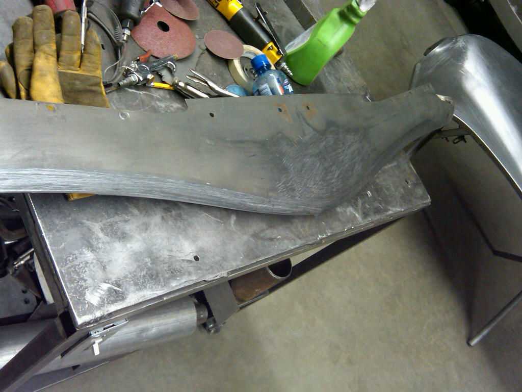

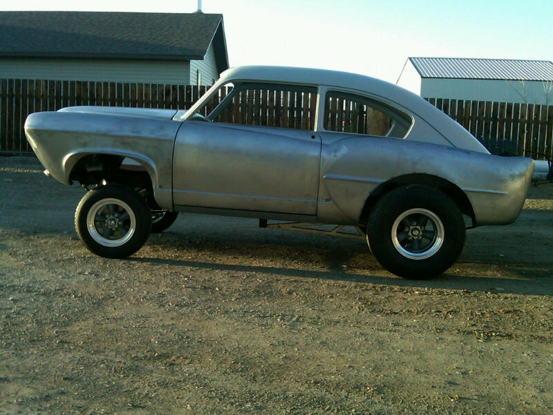

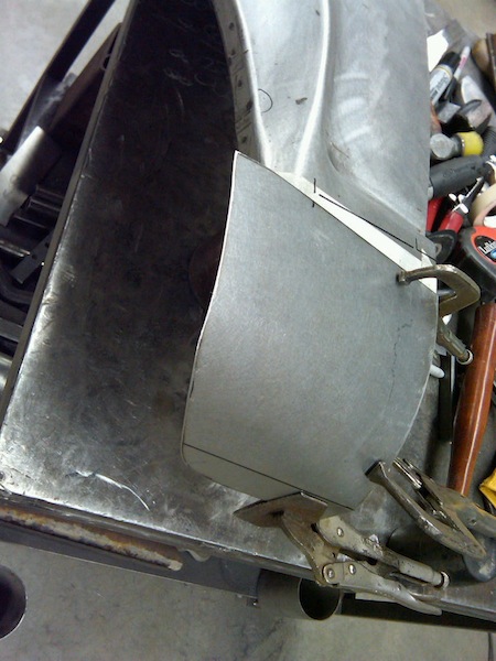

    Here are the latest pics of the sheet metal work that has been done on the drivers side. It has been about 3 months and a lot of hammer, dolly, slappin and shrinking but i am just about to the end of the metal work. All that is left is to finish mounting the outer rocker on the drivers side and finish the flair extensions on the quarter radius's. I will post more pics of the hood and front valance this weekend once i get them down loaded from the camera. Hope you all enjoy!!!!!!!

    A few more of the metal work on the drivers side.

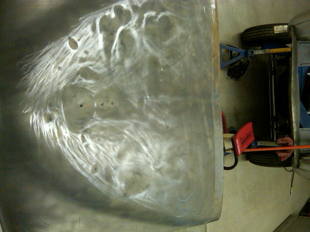

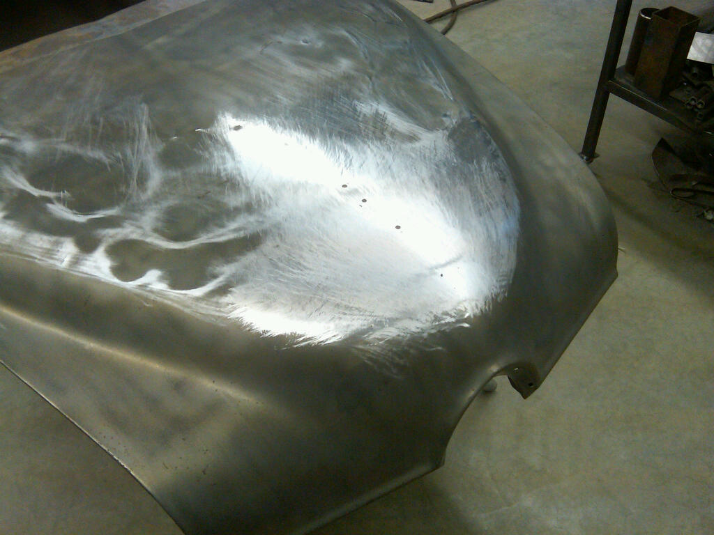

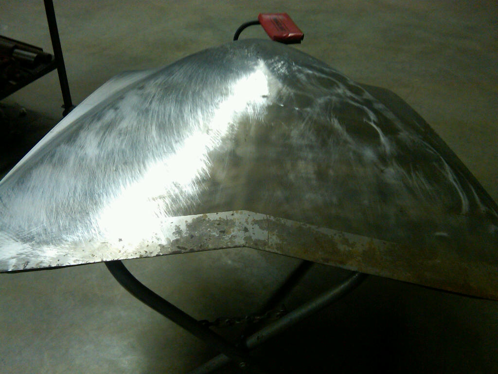

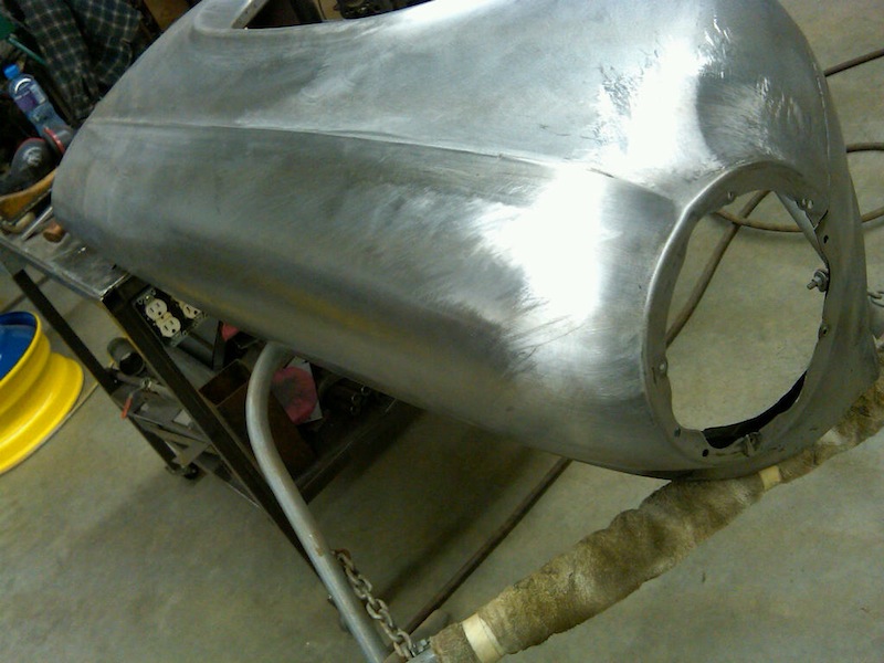

    More pics of late nights and weekend work. As you can see before starting on the hood it looked like somebody was learning how to dance. It was the worst body panel on the car.

    More pics!

    Was that all hammer n dolly work on the hood ?
  25. hemipwd41willys
    Joined: Mar 18, 2010
    Posts: 179
    hemipwd41willys
    from Wyoming
    It was a combination of a hammer, dolly, *******, large stainless shrinking disk and metal body files. I worked on it off and on for 3 different weekends. It took a lot of time to get it straightened out. This is the first car that i have ever done this kind of metal finishing. It has been fun learning as i go but the finished product is well worth the extra time.
