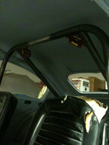

    Here are the latest updated pics. I finished the steering column mount along with the custom built brake pedal ***embly, Offy gas pedal, B&M shifter, mustang seats, stewart warner tach & gauge panel and the roll bar. It is all ready to be removed and will start to get ready to paint the inside of the car.
  17. langy
    Joined: Apr 27, 2006
    Posts: 5,730
    langy
    Looking very cool Ken, love the pedal setup and cage looks nice, love the Mustang seats, been after a pair myself.

    I built the brake pedal ***. The gas pedal came from Speedway. A good friend gave me the seats they fit the car perfect, had to build new bases to get the right seat angle, should work out good though. Need to get them recovered. Motor is at the machine shop :D and should be done very soon. I will post an update on that soon.

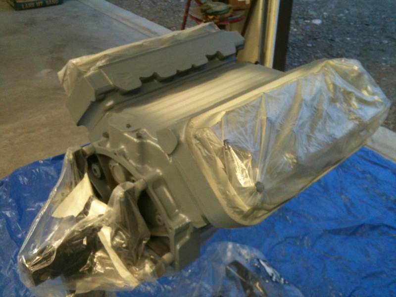

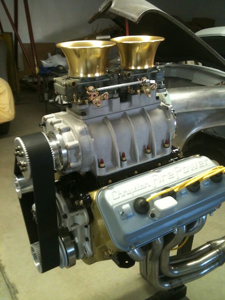

    Well, it has been a very long and busy summer with work. Haven't had much time to work on the J. We have finished the machine work on the motor and i brought it home for a coat of paint and final ***embly. Once i finished with that it was back out to the machine shop for break in and a dyno run. Everything went well with the break in, just before shutting down for the day to come back the next to do full dyno runs we lost a head gasket.
    Took a couple days to get that all repaired. Fired it back up and was running great, but now we are having problems with the ignition. So working to correct that problem. Will be back on this after the Thanksgiving weekend.

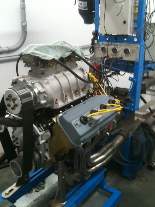

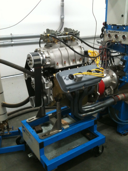

  30. hemipwd41willys
    Joined: Mar 18, 2010
    Posts: 179
    hemipwd41willys
    from Wyoming
    Here are the pics at the dyno shop. Hopefully we will be done with it next week. As we are waiting on ignition parts. I am video taping the dyno runs and will post that once we are done. Everyone have a wonderful THANKSGIVING!!!!!!!!!!!!!
