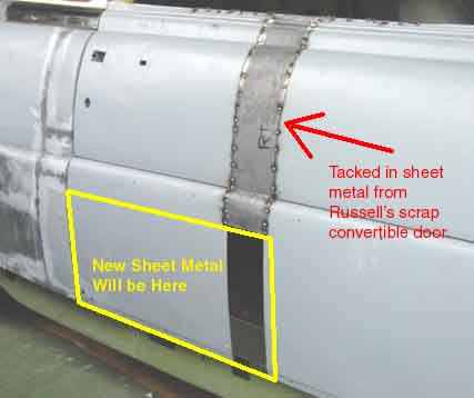

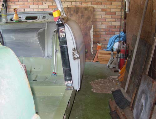

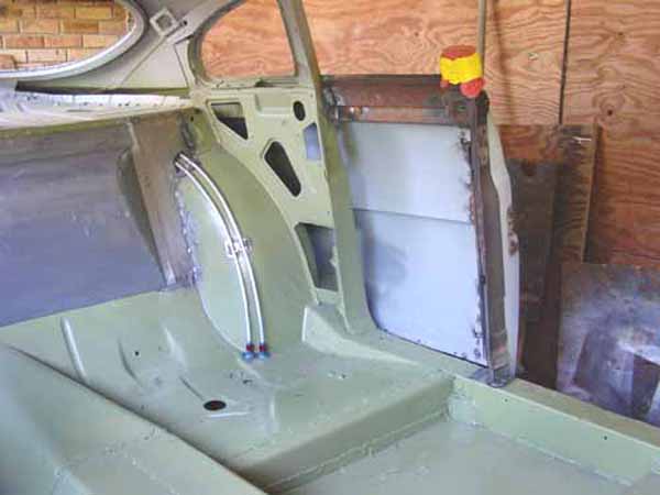

    As far as the conversion of the Hudson in the pictures. We did use imported doors and outer 1/4 panel skins from a Hudson parts supplier in America. A full set of good condition matching panels from the same car were requested. What arrived was four panels from four different cars and year models. All panels were rusty and damaged. The 1/4 panels looked like they had been driven over by a truck!!!!.
    All the internal panels and rear 1/4 windows were either fabricated from 4 door pieces or made up to suit

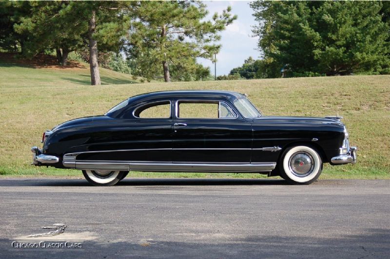

    Personally, if I were going to go to the trouble of chopping a Hudson I would shorten up the roof to give it proportions more like a coupe. They just look so much better than the sedans. I'll post photos in a second.
  15. atomickustom
    Joined: Aug 30, 2005
    Posts: 3,407
    atomickustom

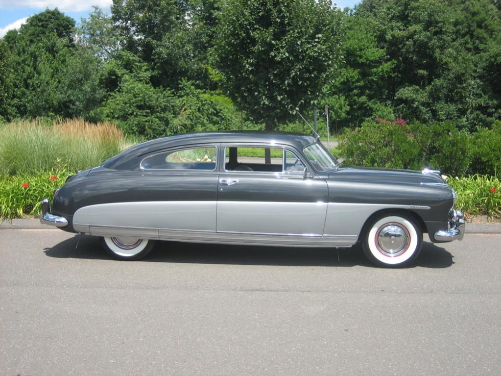

    Here is a coupe vs. a sedan. You can see what I mean about the length of the roof.
    It would take some major surgery to do that; I ***ume the rear seat will have to be moved way forward, but you're already doing major surgery anyway. In for a penny, in for a pound!
  16. The actual roof sheet metal panel is exactly the same on all '48-54 Hudson Stepdown 4 door sedans and 2 door sedans (which Hudson called "broughams" like the two tone gray pictured). The coupe roof tin is obviously shorter.
    Just keep in mind that any place you cut into the "Monobilt" unibody structure of these stepdown Hudsons, you have compromised the structural integrity of the foundation of the car.
    The fact that the rear frame of the subject car in this thread was changed to a clip from a Ford scares the heck out of me because from Hudson these cars had perimeter frame rails that ran through the rocker panels and CONTINUED on the OUTSIDE of the rear wheels in the quarter panels. That was a truly major cut and better be addressed before thinking about building this sedan into a two door.

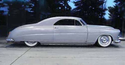

    dublaaron - what you're planning can be done, it will just take a ton of work. Sounds like you're ready for a challenge. In looking at your photoshop - it looks like the door is a bit too long to me. Perhaps measure a coupe/brougham door first, and shoot for that measurement. If you're interested, I can measure mine for you. If you're going to do all that work, make sure you get the proportions right or it will wind up looking funky.
    When I built my brougham, someone had done a partial ch***is swap on it as well. I cut out everything to the perimeter frame, then did a ch***is swap using a stretched Grand Marquis ch***is.
    The outer rockers are just a sheet metal panel attached with screws and rivets (at least mine were) to the upper quarters, and the bottom of the perimeter frame. I wound up making all new rockers for my car out of sheet metal as my originals were rusted through and repaired.
    themodernartist - your 3 window concept is interesting. The picture used is a photo of my brougham on it's first trip out of the garage after I chopped it.
