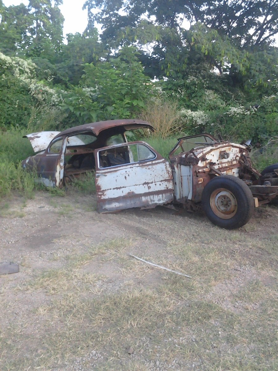

    I have been inspired by the talent on the H.A.M.B. to build myself a custom car. I never thought that I would be able to do what some of the master craftsman on here do, but I'll do the best I can with what I have to work with. I have been working on this car approximately 10 hours every week for about three years so I have a lot done already. Typing and posting pictures is not one of my strong points so I will post and comment from memory from time to time. Questions, comments, and suggestions, are always welcome. Thanks to all for posting their valuable information that I have learned so much from. I hope that this project will be informative and entertaining. I got this car and the one next to it for $650.00, from a gentleman west of Toledo Ohio.

  4. 41woodie
    Joined: Mar 3, 2004
    Posts: 1,160
    41woodie
    I think Hudsons that age are uni-body cars, if that's correct it looks like you have serious work ahead of you. Good luck, Hudsons are special cars.
