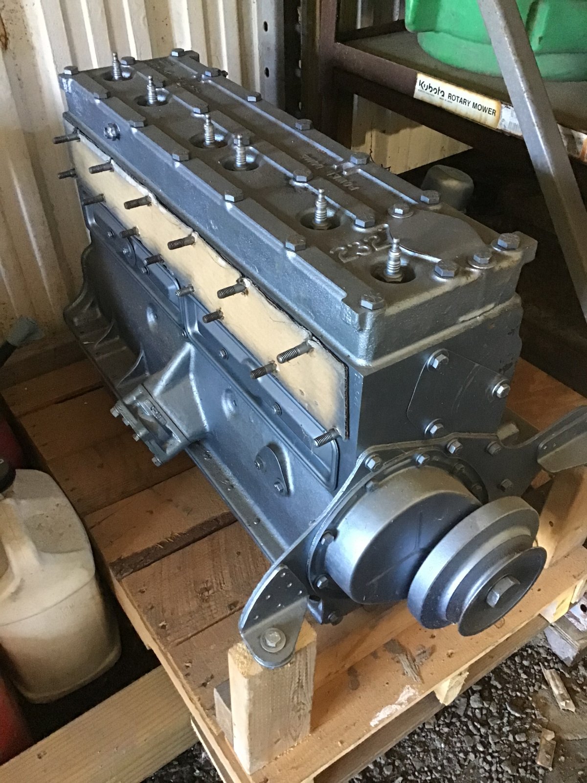

    They really are some tough engines. I'm going to replace gaskets and seals in mine while its out, I just have to look and see what makes it tick. Picture1229171605_1.jpg

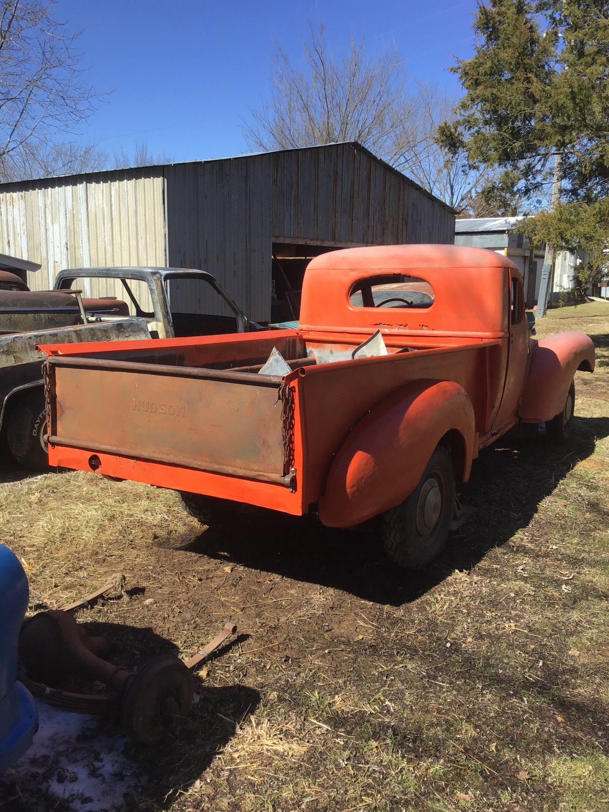

    I have been working on the projects when I could find the time. I started building a new shop when my wife decided she wanted a new house, so I built her one, just got done last fall and went back to work on the shop. I did get gaskets and rings, the bearings were new. The engine had been overhauled just before it was parked. I bought a Hudson bed for the truck and got it put on. It seems that I get to work on my projects more these days, so I will be getting more done now.
