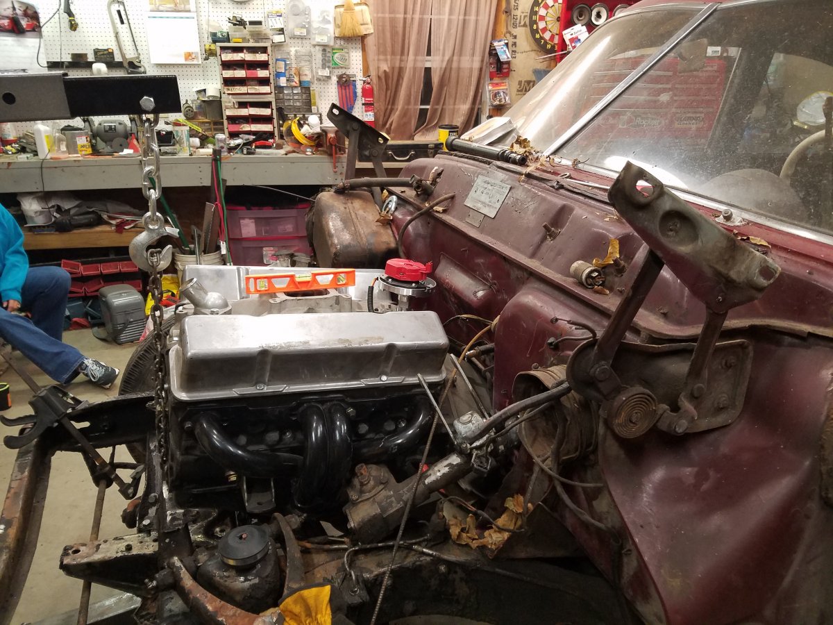

    Until you hang the engine and trans in the ch***is, you can't know what you're going to have to do to swap it, and neither do we. Why don't you, if you have a 350/350 combo, roll the cherry picker up to the front of the car, lower the combo between the rails, and get an idea. Then post photos. An X member frame doesn't preclude fitting a driveshaft, my 48 Pontiac convert, '51 Pontiac wagon, my old '48 Chev convert, and my '56 Caddy all had X members, no issues running the driveshaft, in fact, the tailshaft of in all of them was smack in the middle of the X. We ain't gonna know what'll fit, what'll be in the way, if anything.

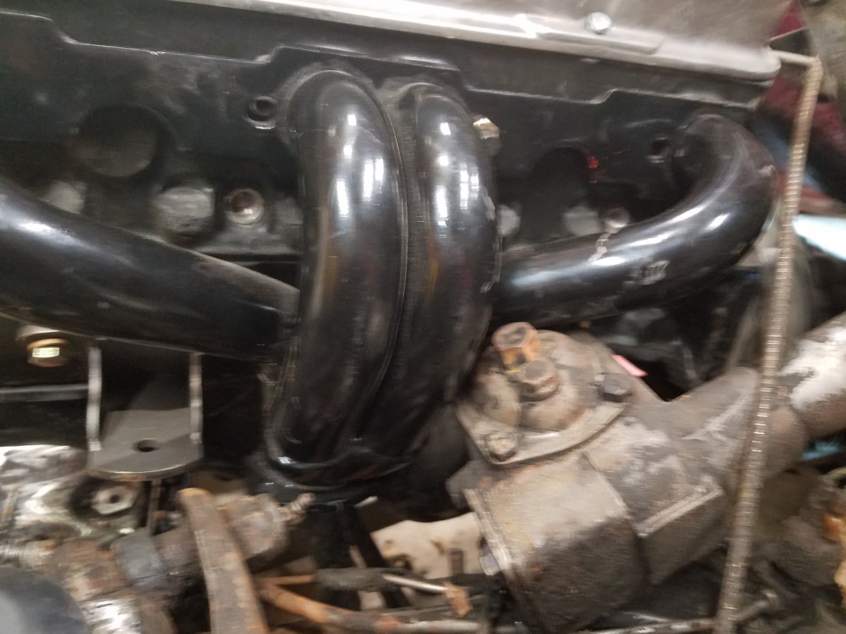

    ok this is whats stopping me.....header is hitting the steering gear box....engine needs to come down but the oil pan will hit the steering linkage.....trans needs to come down a little....here are pics and thanks everyone for all the advice

    The header has to go......there are a variety of SBC factory manifolds to choose from. Offhand, I'd say a '55/'57 era manifold that is mainly above the ports and has an outlet near the front on the left side which should clear your steering box. Or, a custom made header would do the job.
    The pan can be modified in the front to clear the steering gear. The oil pump is at the rear, so the front of the pan is easily reshaped without causing internal conflict.

    You could also offset the engine 1-2" to the right. Maybe 3", if there's room. For steering box/header clearance. Deal there is, the trans also *has* to be offset an = amount.
