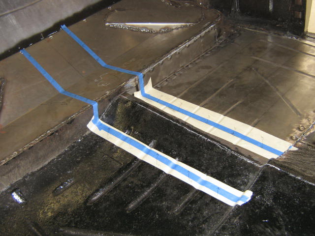

    Almost finished with the modified driveshaft tunnel installation. Some welding and finish grinding and then this task is complete.

    build is coming along great! one question though why didnt you go round on the drive line hump?
  6. enfieldjoe
    Joined: Jun 5, 2009
    Posts: 839
    enfieldjoe
    from Eustis, FL
    Did not have access to a slip roller, only a box and pan brake. So, I made the shape with the tools available to me.

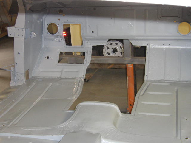

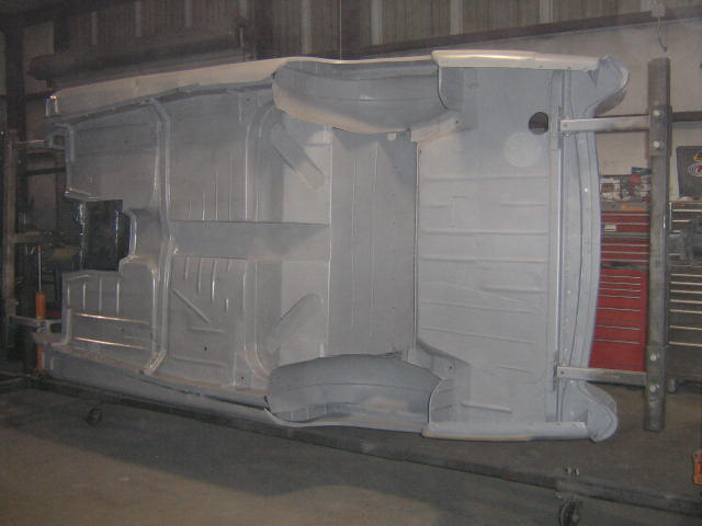

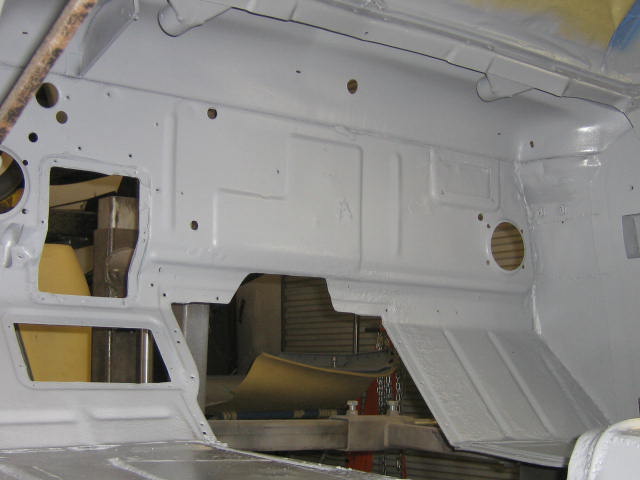

    Sprayed the underside of the body and firewall in epoxy primer. Next step will be to seal all the seams. Then I plan to spray Lizard skin sound control. Getting closer to finally installing the body on the ch***is for the last time.

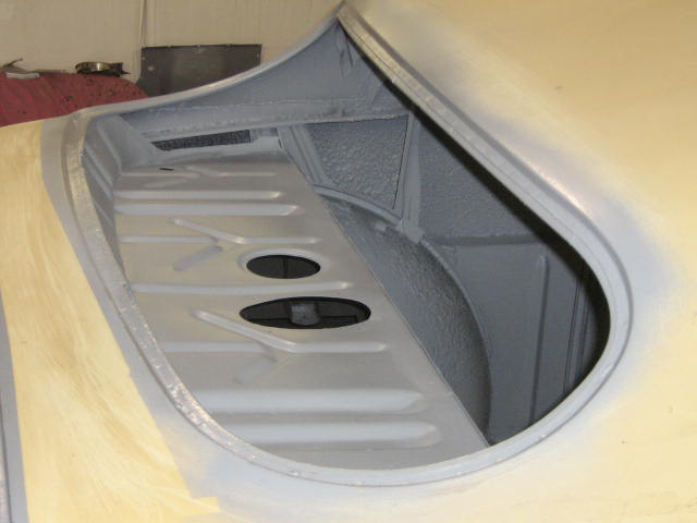

    Sprayed the Lizard Skin Sound Control coating on the underside of the body and in the trunk.

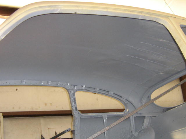

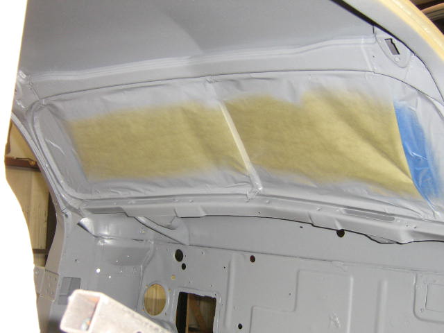

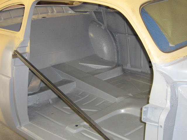

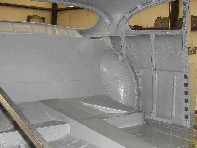

    Sprayed epoxy primer on the interior, roof, and floors today. Lots of surface area to spray. The body mounted on the rotisserie made the job alot easier because I could rotate the body for easy access to the area and for comfort.
    Next I will seal all the seams with Upol Tiger Seal and then spray Lizard Skin Sound Control.

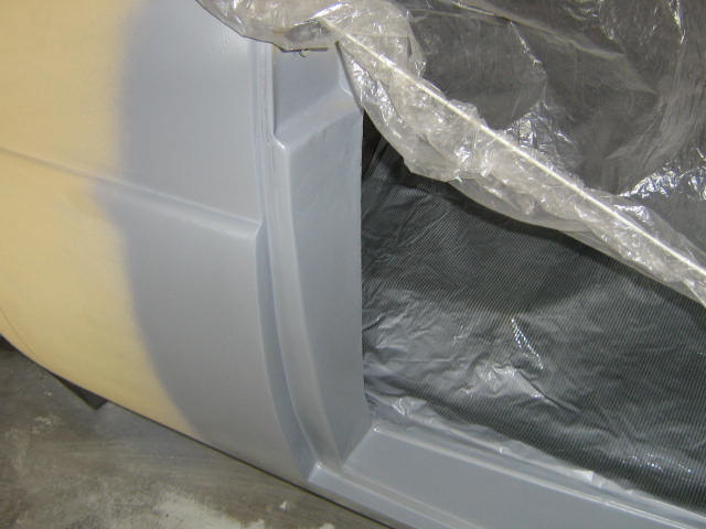

    Been busy the past weeks block sanding the high build primer. Sand, prime, sand, prime, etc, first with 180 grit and then with 320 grit, all by hand. Still working on the doors, but the deck lid, hood, and body are now complete and ready for paint.
