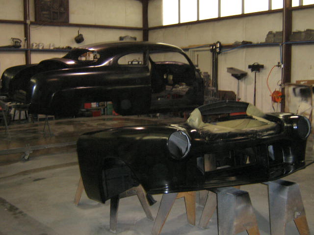

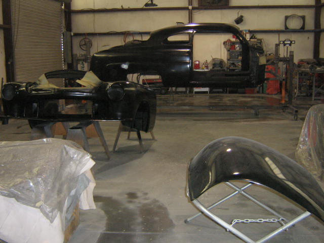

    The Merc is now in color. Sprayed one gallon of Acrylic Black Lacquer this morning.

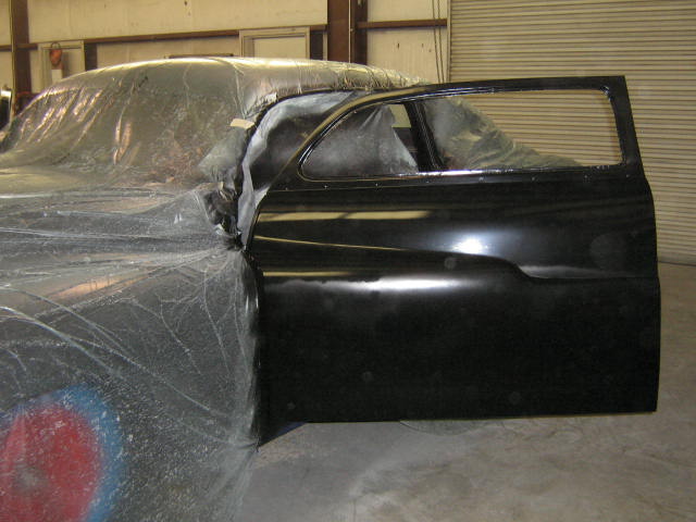

    Final ***y has begun! Wet sanded the clear lacquer with 1000 grit before I installed the body on the ch***is today. Will wait several weeks for the lacquer to cure then start buffing. Lots of work to do in the interim....

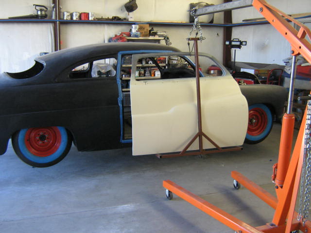

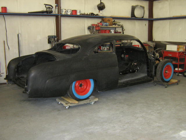

    Installed the deck lid and front clip. Installed both doors today. Doors are still in primer because the gaps at the top of the doors need more work. They just did not come out tight enough.
    SlddnMatt was kind enough to give me a couple of s**** window frame pieces so that I could cut my window frames to close the gap. Will use the scap pieces to add the extra length to the "B" pillar side of the door window frame.

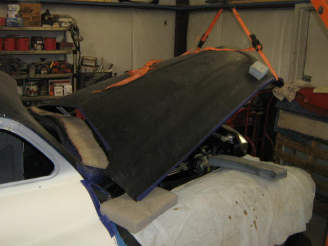

    Installed the hood today. Engine hoist provided the neccesary ***ist. Safe and convenient way to position, fasten, and adjust the hood without damaging the paint.
  20. Never thought of trying to put a hood on like that. I'll have to try it when I put my hood back on.

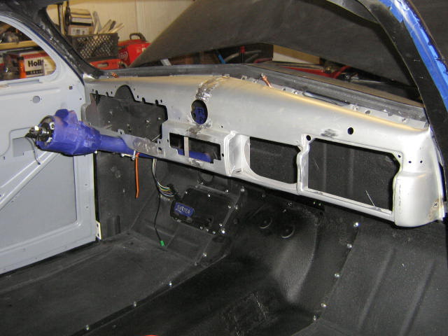

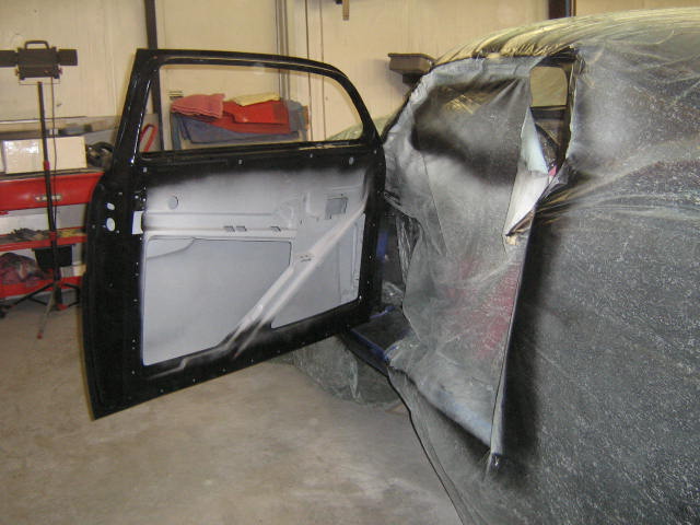

    Merc is taking shape. Getting closer to a driver. Installed the radiator, fixed the gaps on the upper window frame to body on both doors, prepped the doors for paint, and painted the doors. Mocked up the 49 Merc dash and steering column.
    Doors will need some finish sanding with 800 grit before I spray them with clear lacquer.
