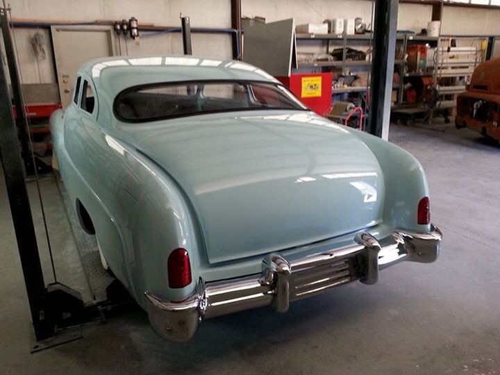

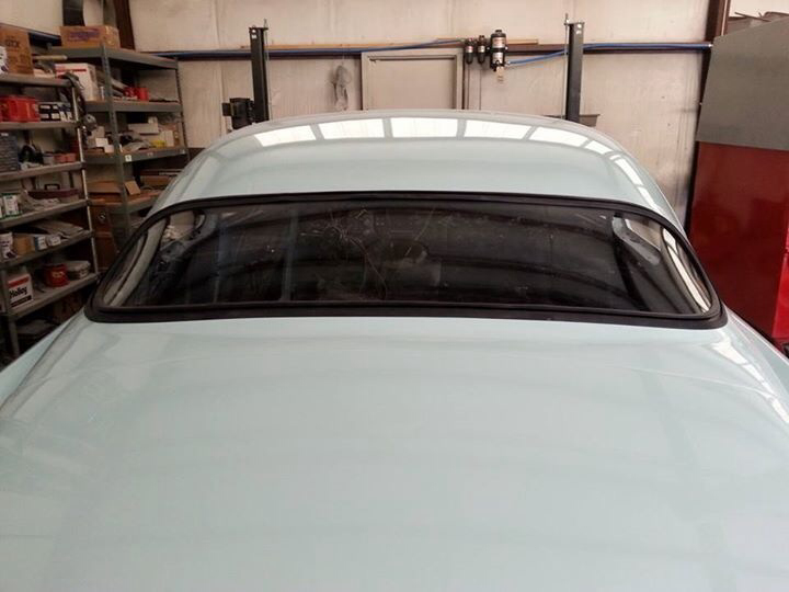

    Installed the tail lights & rear window today. Also finished off the rear bumper with the bumper guards over the license plate.
    ImageUploadedByH.A.M.B.1429655032.144346.jpg ImageUploadedByH.A.M.B.1429655047.187870.jpg ImageUploadedByH.A.M.B.1429655063.141866.jpg
