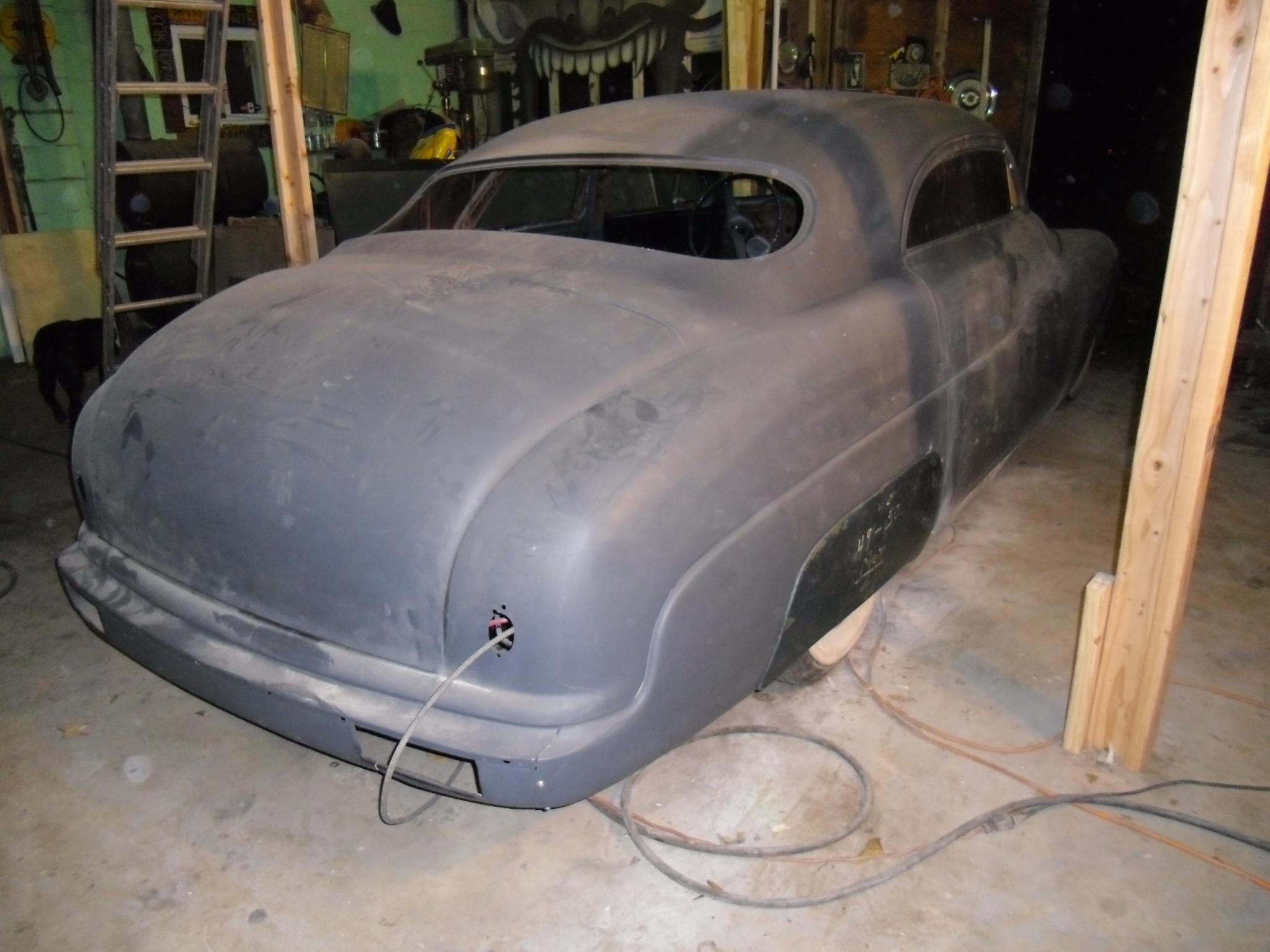

    Are you opposed to going with a stock frame, and clipping it? I think there is a guy on the HAMB selling a frame. There isnt a difference between the 2 doors and 4 doors frame, if I'm not mistaken. If you are going to clip it, go with Camaro front clip They looks awesome, and work best from popular opinion.. Here is mine. I'm a four door Merc as well..
