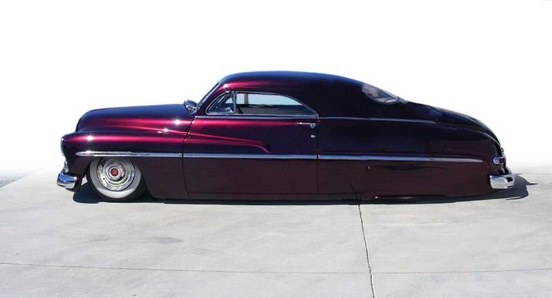

    Are ya shooting for this??
  13. michaelvz51
    Joined: May 24, 2011
    Posts: 876
    michaelvz51
    from So Cal
    Yes Matt, in a similar way but with a few added twists.

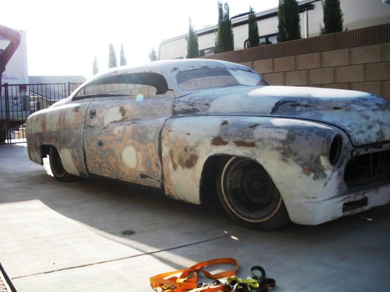

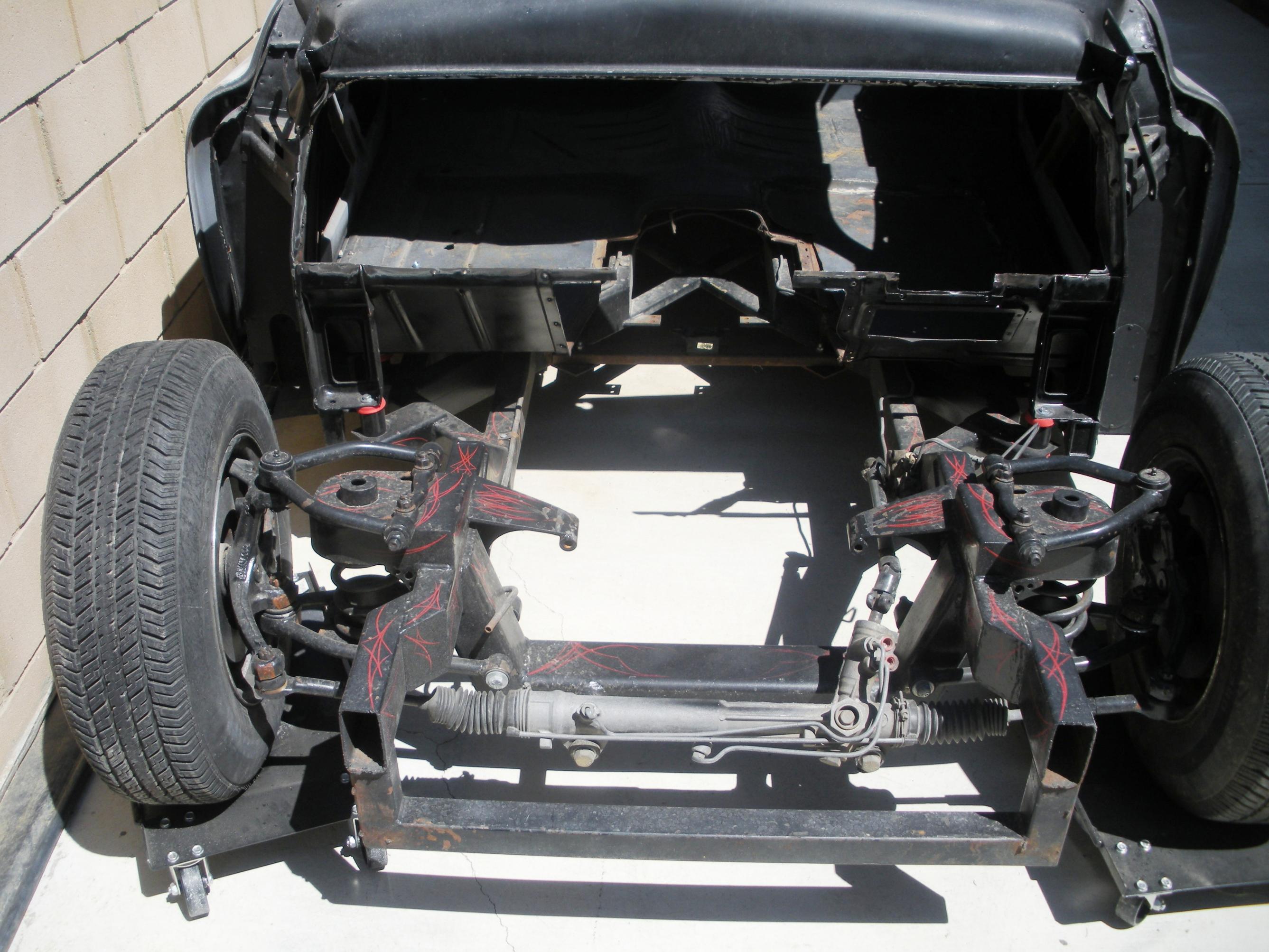

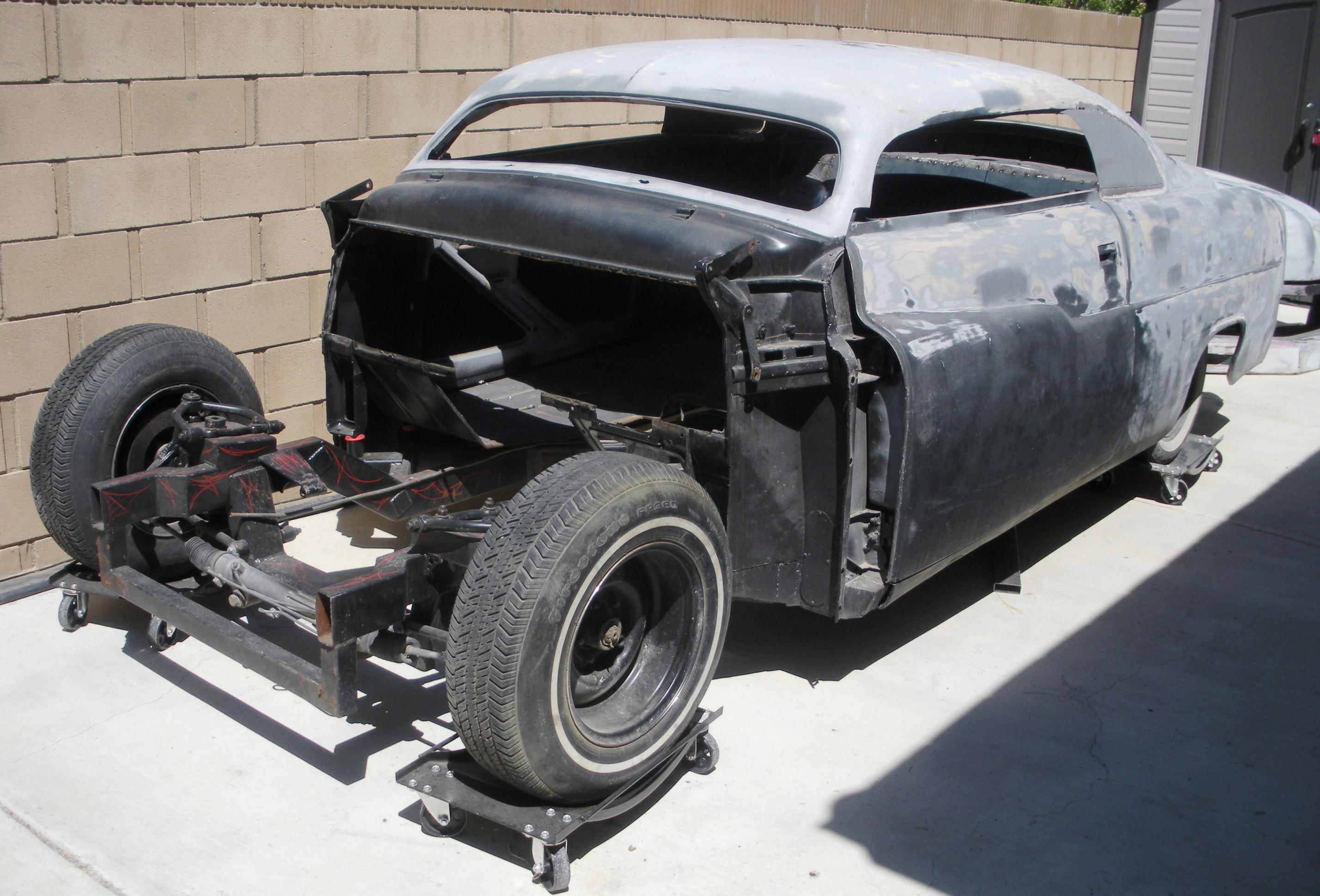

    Here are a few more:
    The Front clip, A mock up of the 3 window setup and the 55' Desoto Rear Bumper already cut down and being setup for mounts.

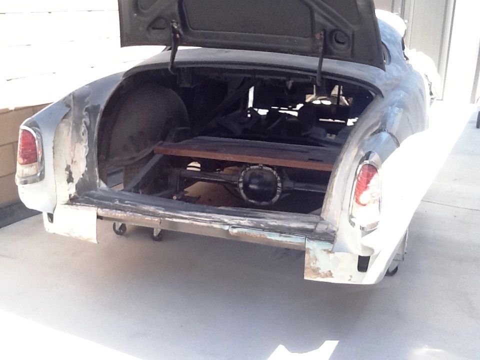

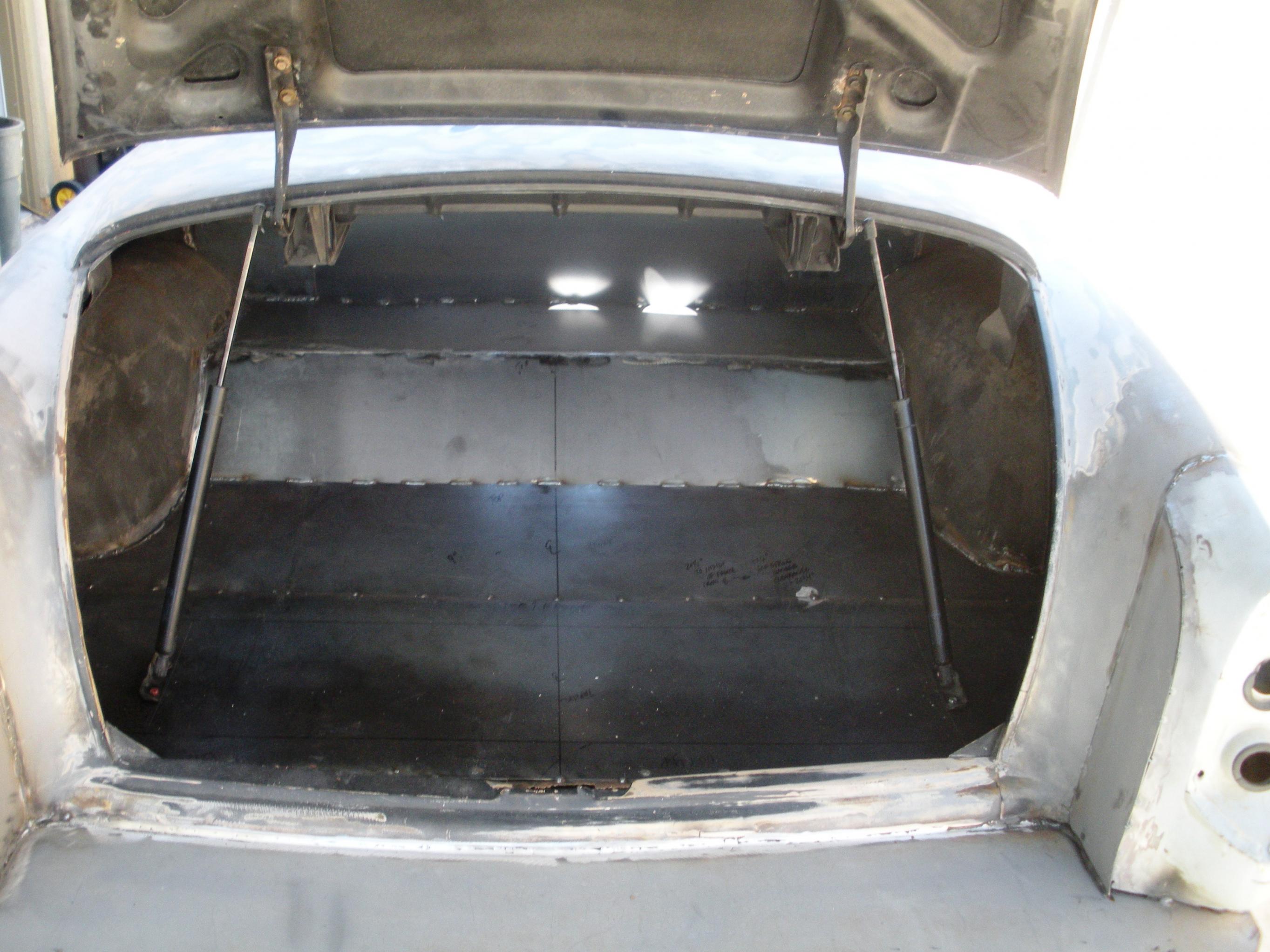

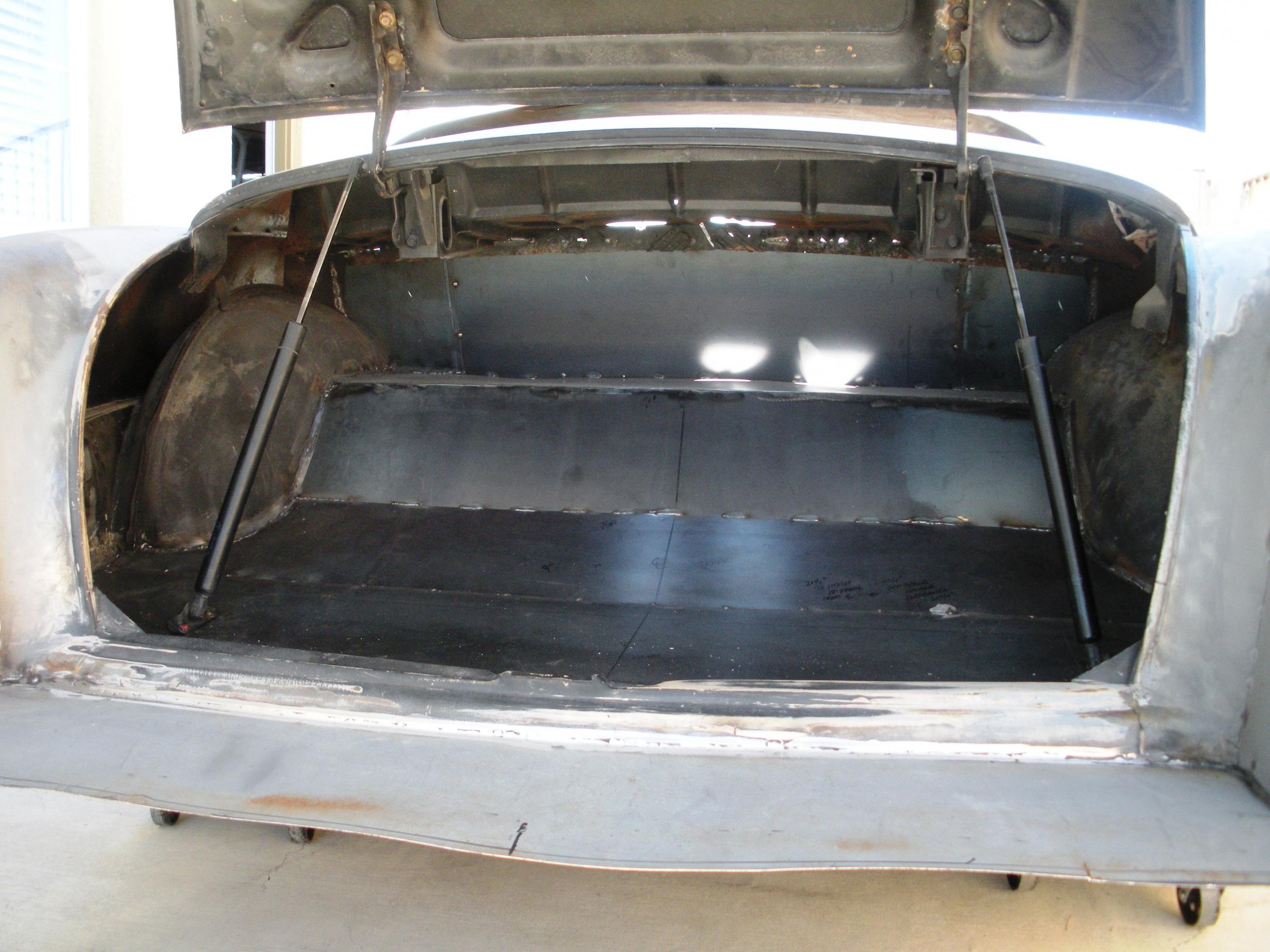

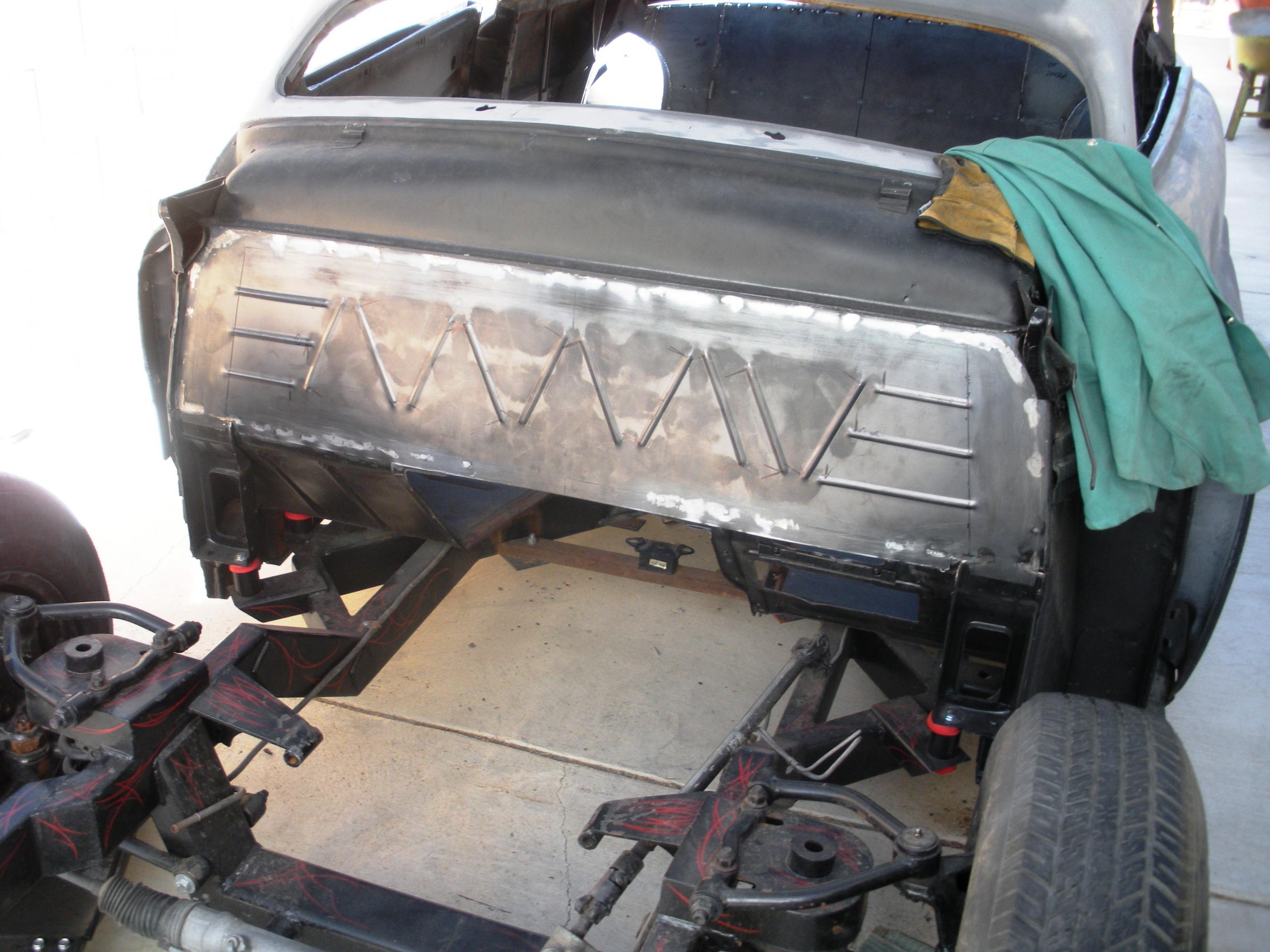

    1. Finished tacking and welding the trunk panels in place and am starting to research Fuel Tanks that will fit between my aftermarket frame rails. I will then cut out the floor, make a box enclosure and mount the tank in it.
    2. Mounted the trunk lid and added gas shocks off of a Mercury Villager mini van rear hatch setup instead of using the original spring lift. This way in the future, I can easily repalce the shocks when they wear out and they will leave me some room on the trunk the way they are mounted.
    3. Finished welding the new firewall in place. It will need to be trimmed later for the transmission tunnel I will be making once I get to the point of mocking up the FORD motor mounts and replacing the chevy motor mounts that are there now.
