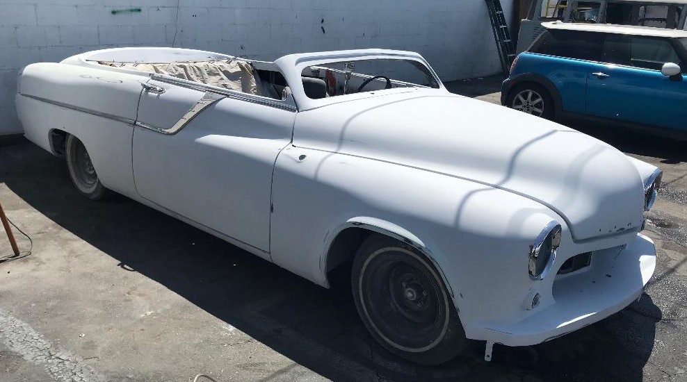

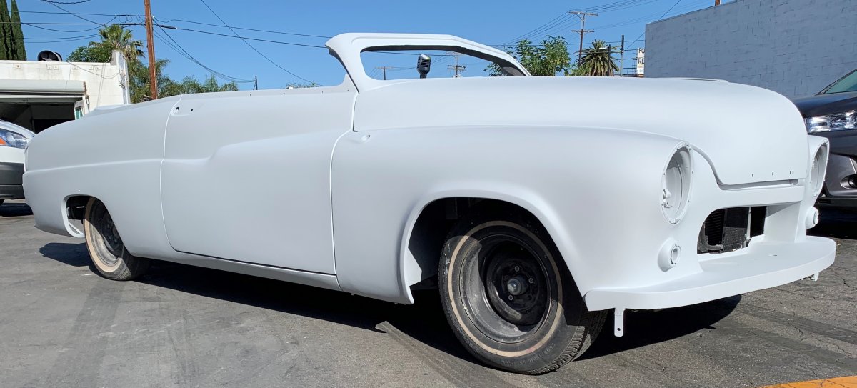

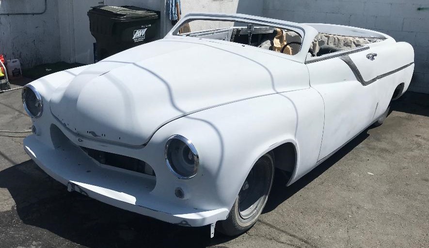

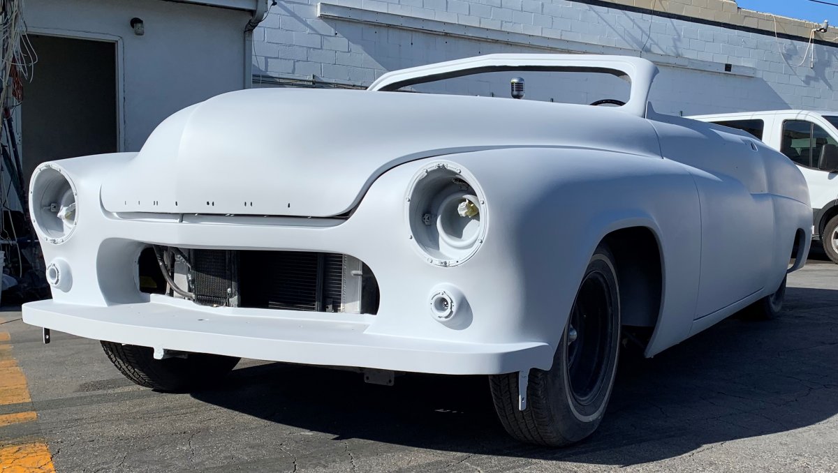

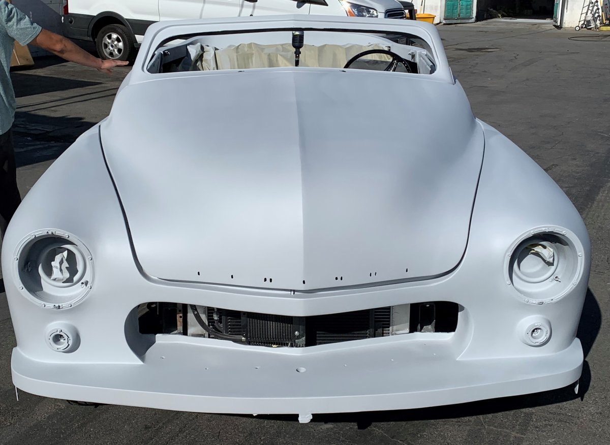

    2019-05-17 Final Primer (2).jpeg 2019-05-17 Final Primer (1).jpeg 2019-05-17 Final Primer (4).jpeg
    I know that bodywork pics may not be exciting to some, BUT, look at how crisp the lines on the car are taking shape after tuning and primer is applied by artists...…….

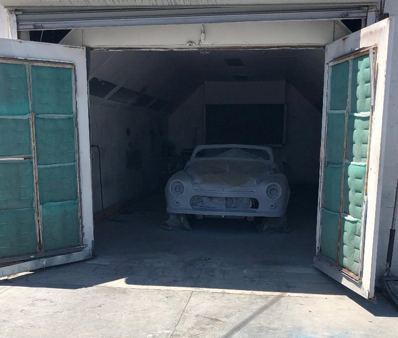

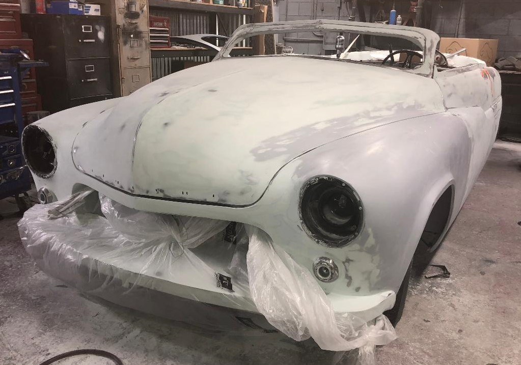

    2019-08-24 In The Booth.jpeg 2019-09-04 Final Trim Fit.jpeg 2019-09-04 Final Trim Fit2.jpeg
    Here's a booth primer pic and two important step pics: final trim fitment to make sure it will all fit AFTER paint. This was a step I was not expecting but am very grateful that it was done this way! Next will be paint and trim installation etc. Getting exciting after all this time Hambers!

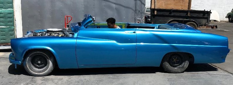

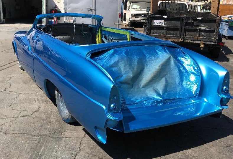

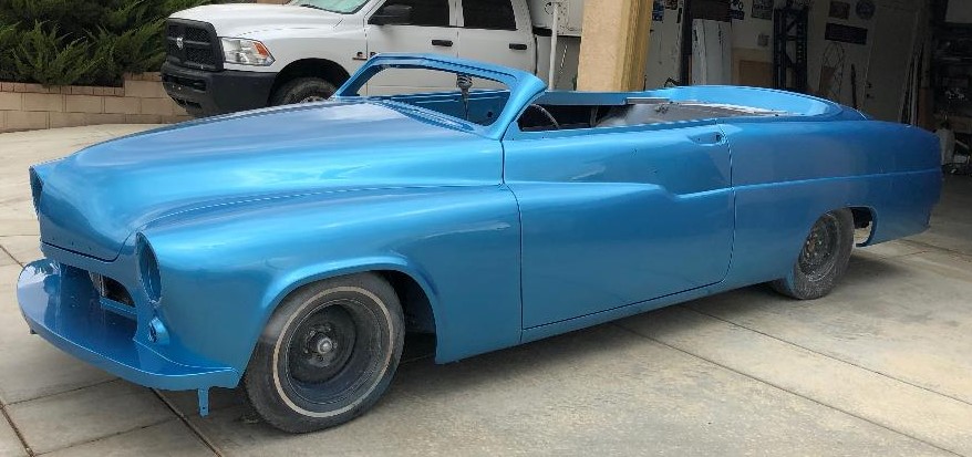

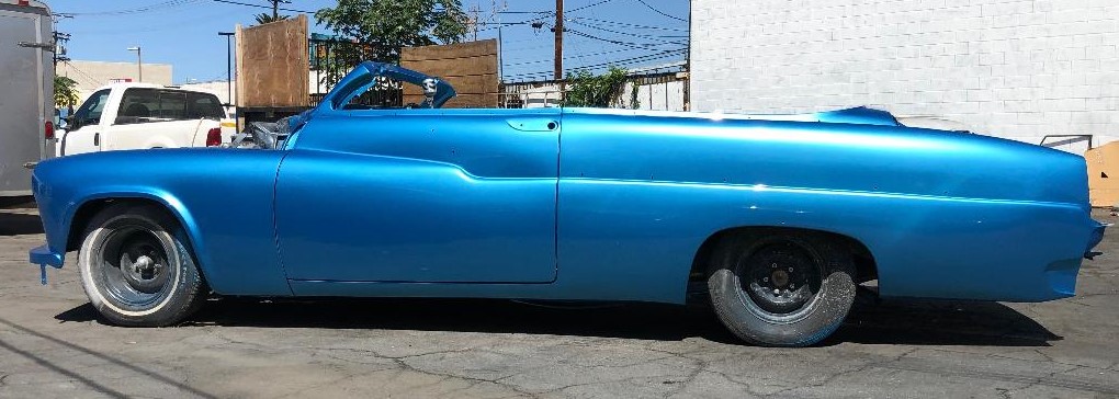

    2019-09-14 Painted 1.jpeg 2019-09-14 Painted 2 .jpeg 2019-09-14 Painted 3 .jpeg
    Fresh out of the paint booth! Finally, the color is revealed and its unbelievable in the sun as it literally changes color before your eyes! Look at the pics carefully and notice the depth of color change, exactly what we were planning for. I'm not excited here NOT! The boys at Canoga Auto Works made this man's dream come to life. Now, wait a week or two for the clear to properly dry and gas off before color sand and buff.

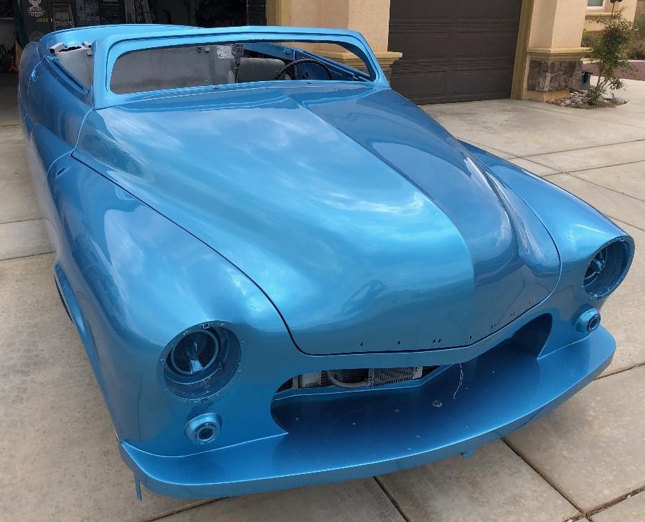

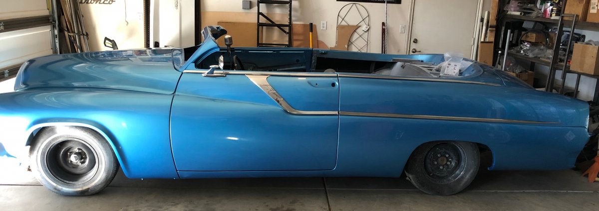

    FINALLY back home for all the details to be installed. Next up will be polishing all the Stainless Steel trim and putting this jewelry back on her-More to come soon

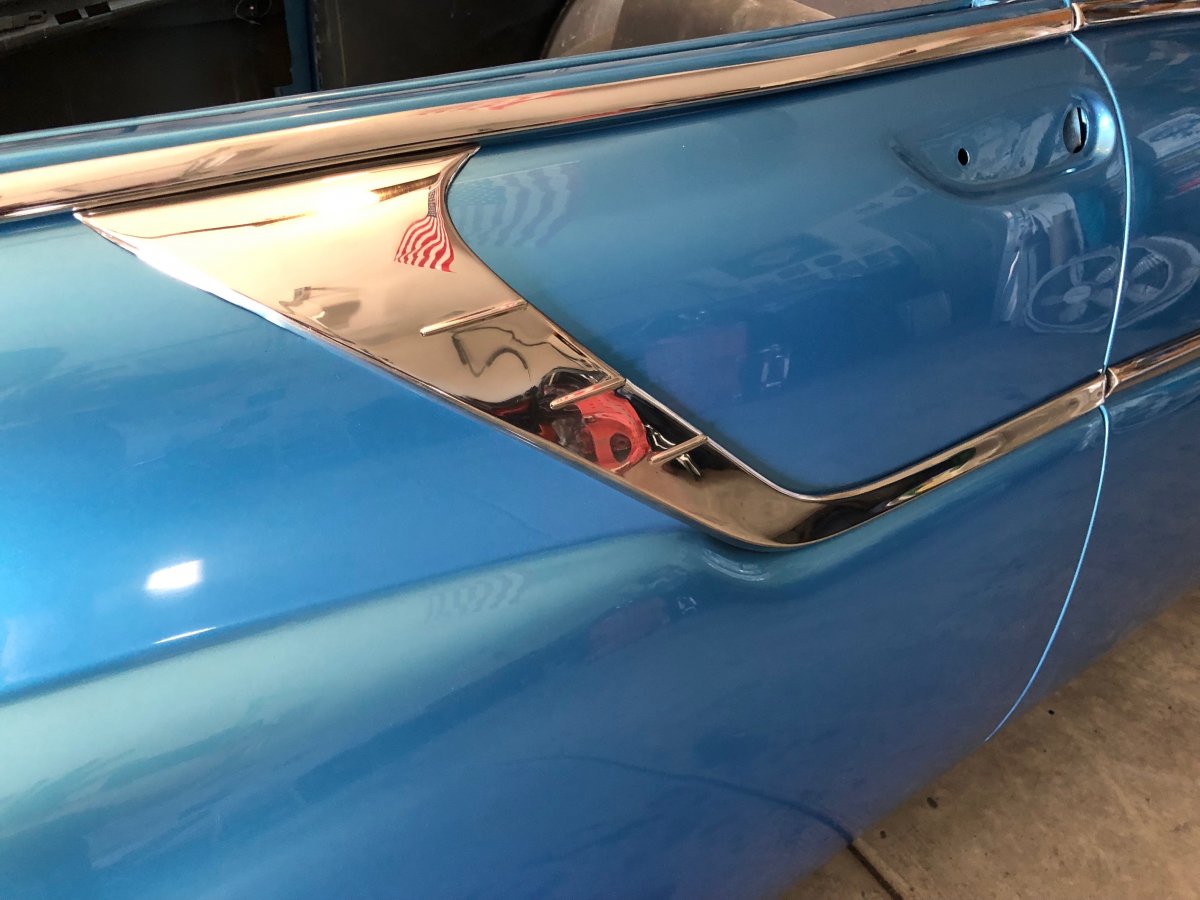

    Polished Stainless Trim beginning to be installed. I have learned so much throughout this project and will again thank the HAMB for guidance. I have recently learned to how to restore, repair and polish this Stainless Trim and so far its going well. I'll be posting more as the project continues!

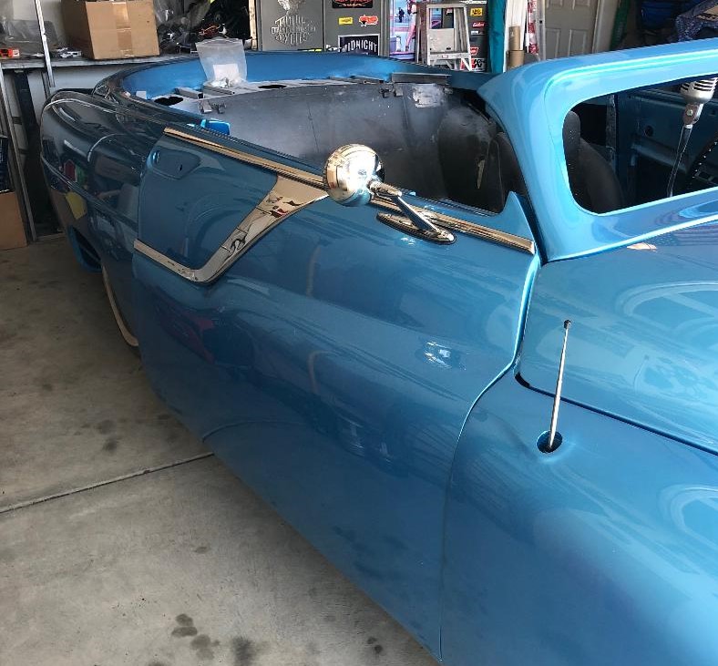

    Update:
    P***enger Trim polished and installed and the Antenna too, starting to see what the vision is becoming...

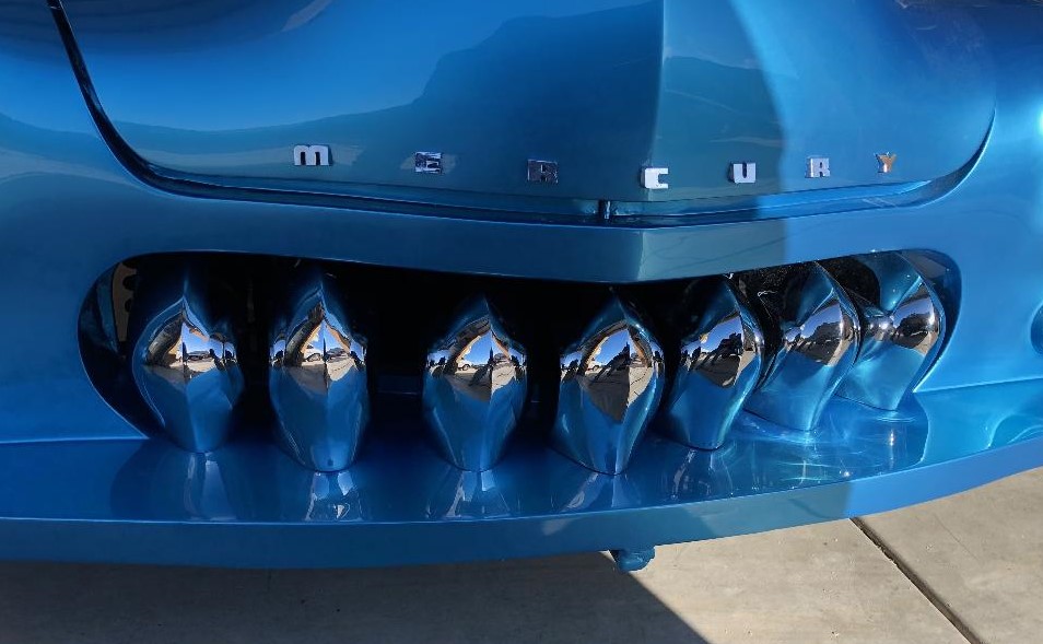

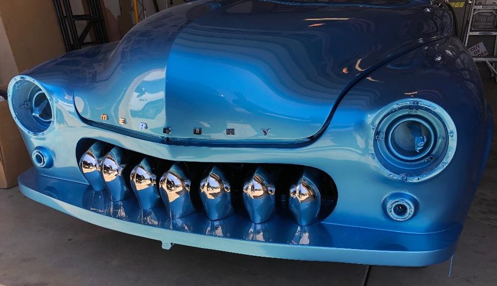

    2019-10-05 Grill Teeth (1).jpeg 2019-10-05 Grille Teeth (2).jpeg Grille Teeth installed and the one year only, extremely hard to find 1949 Mercury Hood Letters. I am putting some trim pieces back on the car as this would have been done later in the show circuit in the late 50's. Plus, I just like the extra bling...........

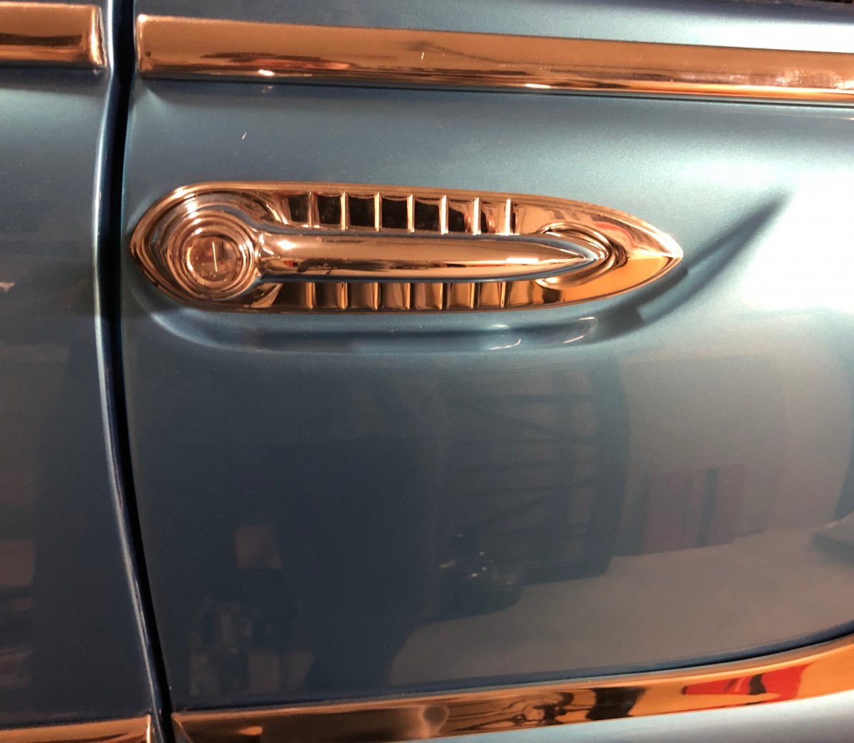

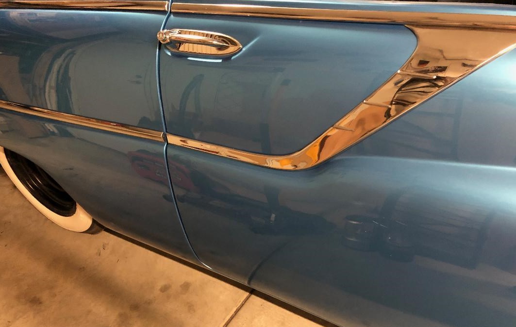

    2019-10-09 Passenger Door Handle 2.jpeg 2019-10-09 Passenger Side Door Handle Install 1.jpeg
    For those who have been watching, did you notice the "door pockets" I worked my *** of to weld into the doors? Well, now you see what is filling that space...…….How about some 54' Chevy Door Handles with the DeeeeeeeeLuxe Knuckle Guards that happen to be "spear" shaped? Yes, the spear shape on this car is a theme and you will see more as it comes to life. I know you are asking "What the heck did he put "Chevy" door handles on a Merc"? The same reason I am putting a bunch of Desoto parts on it, because I believe these parts enhance the overall appearance and theme I designed while studying all the pics of Kustoms on the HAMB for several years. Also, these are very user friendly as they lock the doors too without having an extra hole in the door for the original keyed lock of the Merc. Look closely at the sunken antenna mount in previous posts and check the lead work we did to make, you guessed it, a spear or teardrop shape. You can also see the teaser of the full on Wide Whitewalls being installed on the rear. Next up will be the Skirts...………..

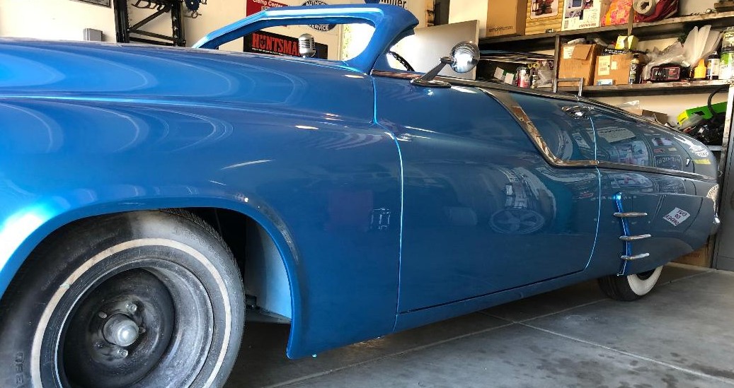

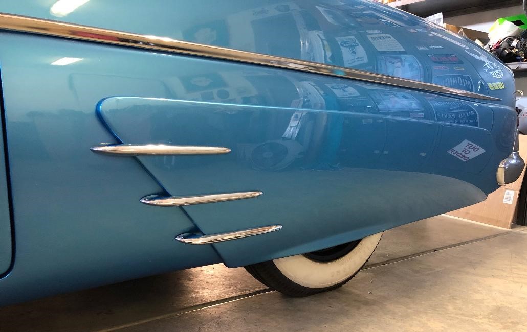

    Here are a few of the Driver Side Skirt installed and completed with the 54' Merc modified spears. I had to "shave" down the spears so they would not hit the body and I did this using different co****ness files. I used good quality masking tape to mark off how much to shave and also to help keep the chrome in place once they were completed. I used "Camper Installation Tape" for the weather stripping and to act as a barrier between the body and the skirt. I believe all the work to build these was worth it-Thanks again to the HAMB for the ideas and guidance. (The front tire is just a roller and will be replaced with the wide whites like in the rear once I get the front end straightened out)

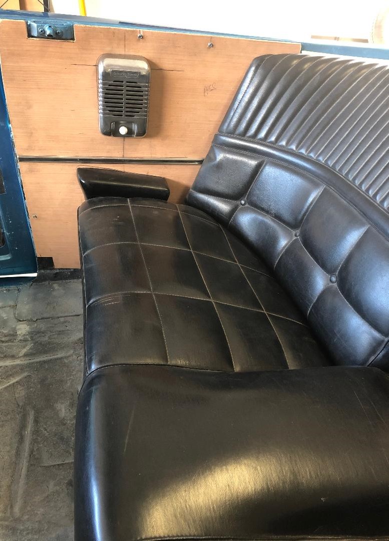

    Rear T Bird Seat in placement and just starting the woodwork for the interior upholstery panels. Note the "Drive In Speaker Cover" which are now being remanufactured so I will run them throughout the car for the audio system. I'm also using some Studebaker Lark trim I found to separate the upholstery types. Next will be more woodwork and installing the sound deadener throughout.

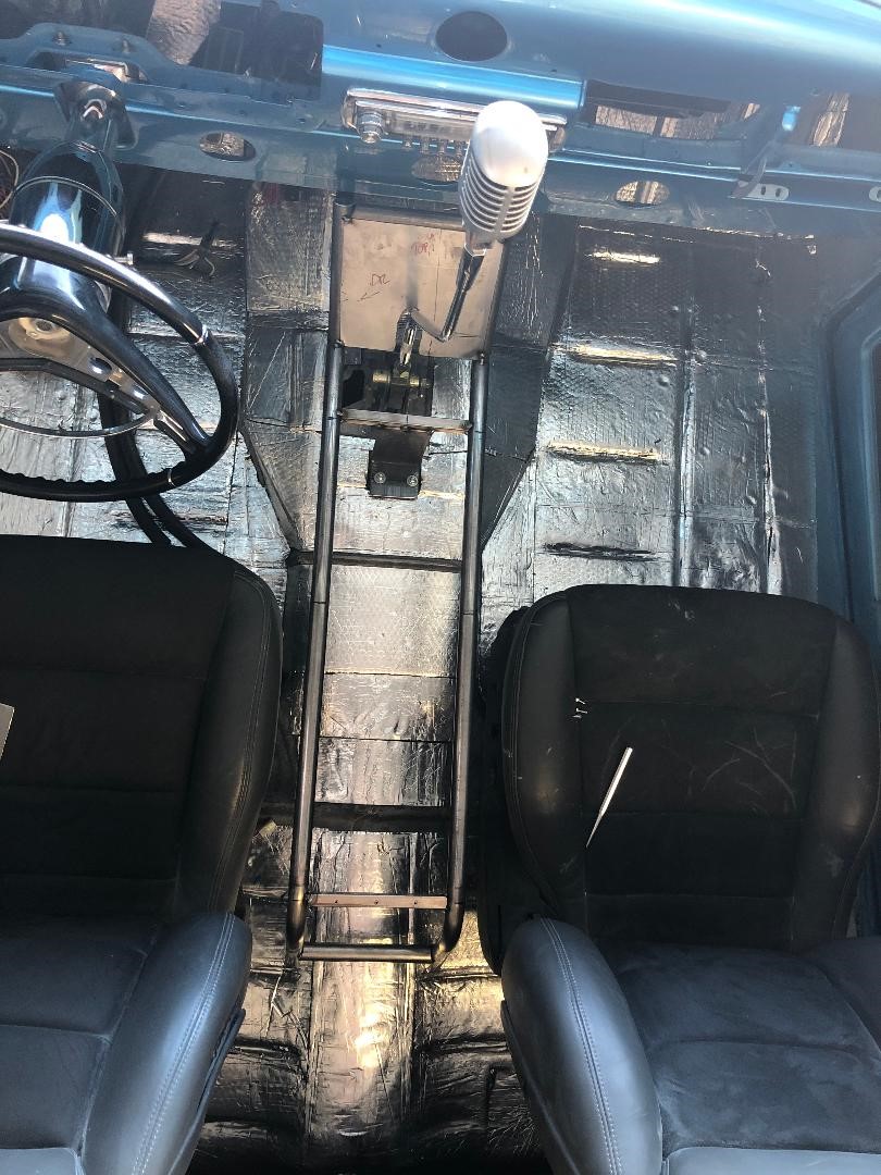

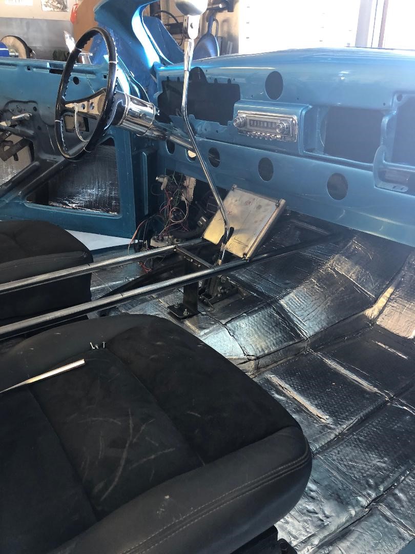

    2019-11-02 Center Console 1 .jpg Here is the start of my custom center console. I am building it of a combination of round tubing, square tubing, Sheetmetal and wood. This shows the 1" round tube main frame with a Sheetmetal cover for the shifter. I welded 1/4" bolts to the floor and made a bracket to mount it easily and with some adjustment for future upholstery. We decided to keep the rear floor open for p***engers hence the drop at the back of the seats.

    2019-11-02 Center Console 2.jpg Here is a side view from p***enger side
