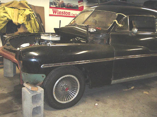

    We've pretty much finished up cutting or welding at least one of every part on the entire car, so we decided to chop the roof since it was the only thing left to cut or weld on.
    You can see in the pics below, we carefully masked off our cut lines in pic 1.
    Pic 2 is Marc throwing caution to the wind, taking a sawzall to the door post. He has some experience with this after hosting his own HAMB chop, so I let him have at it while I went in the house and ordered a radiator.
    I stopped him just in time when we realized he'd masked off the chop in the front and back, and I'd done the doors. We were a little off.
    Pic three is the cut lines, showing just how much we were about to remove from the top by the back window. I figured it would be easier to just add metal back in if we cut too much out of it and it was too low. The "X" marks the area to be removed so we a wouldn't forget later.

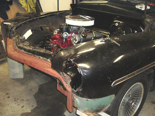

    I've been eyeballing the frontend the past couple days, and Marc came over tonight to help talk me in to doing what I was pondering. I wanted to start fabbing up a core support to not only hold the radiator, but support the fenders as well. We determined that we shouldn't proceed until we had a radiator to start with and base the design around. None of the three radiators I have lying around will work.
    I have about 6" to work with. I knew I was going to have to run an electric fan, but I was stumped as to what radiator to use.
    We looked online, and I found a '64-66 Mustang 289 radiator had the dimensions that seemed like it would work. It cooled a 289, so it should cool a 302 just fine. I went ahead and ordered one.
    We made a cardboard template in the dimensions of the radiator, and looked to see if the electric fan I had laying around already would work. The combined thickness looks like it will be close, but should fit.
    Since we were running out of time for tonight, we discussed how we are going to build the core support, then decided to mount the doors back up so we can see how the gaps will be with the front fenders mocked up on cinder blocks. It turned out that they looked good.
    Next up, front core support fab, exhaust hookup, run brake line to rear brakes, run fuel line & mount tank, wire car, etc... it's a huge list. Hopefully we can put in some serious time this weekend.
