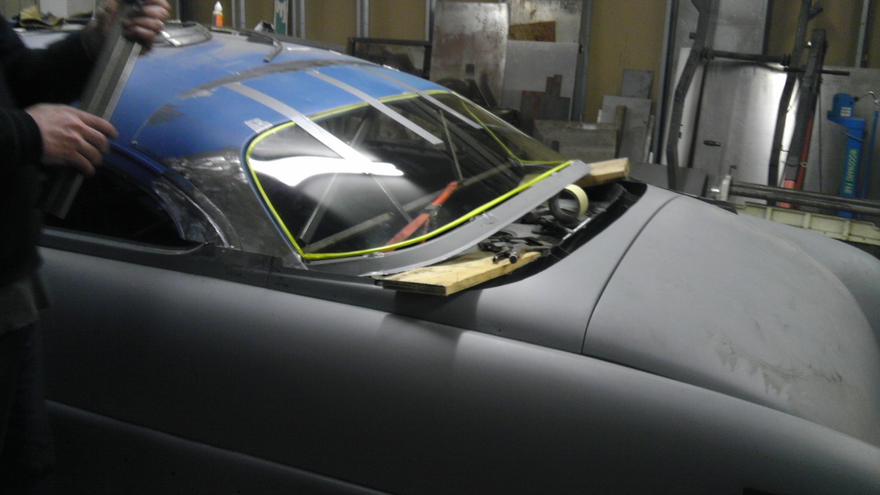

  10. like this 51 merc gl*** cut to fit.
    I've taken many back gl*** and laid them over different windshields till I find a similar curve. then cut the windshield down to fit a smaller opening. it really does look better than many oversized back gl*** that some have used over the years.
    so many options so little time
