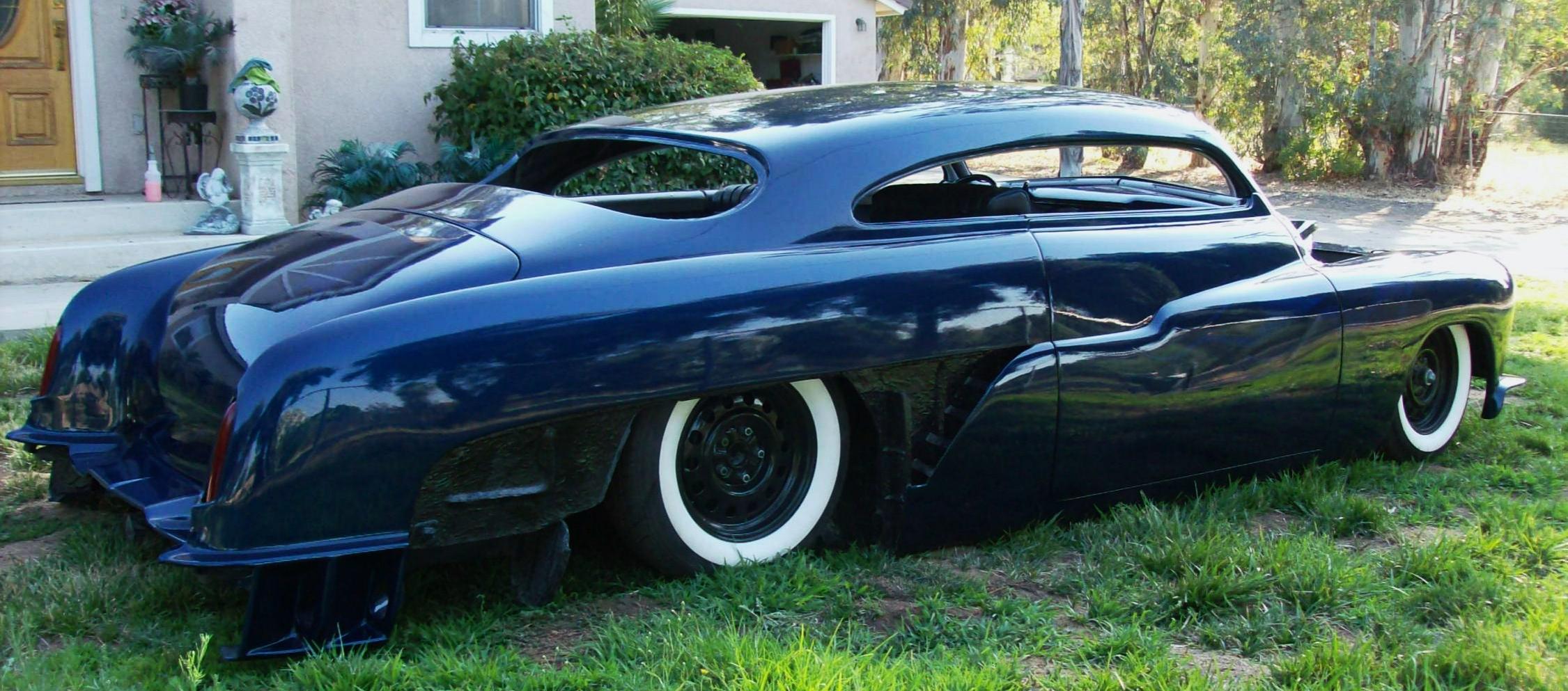

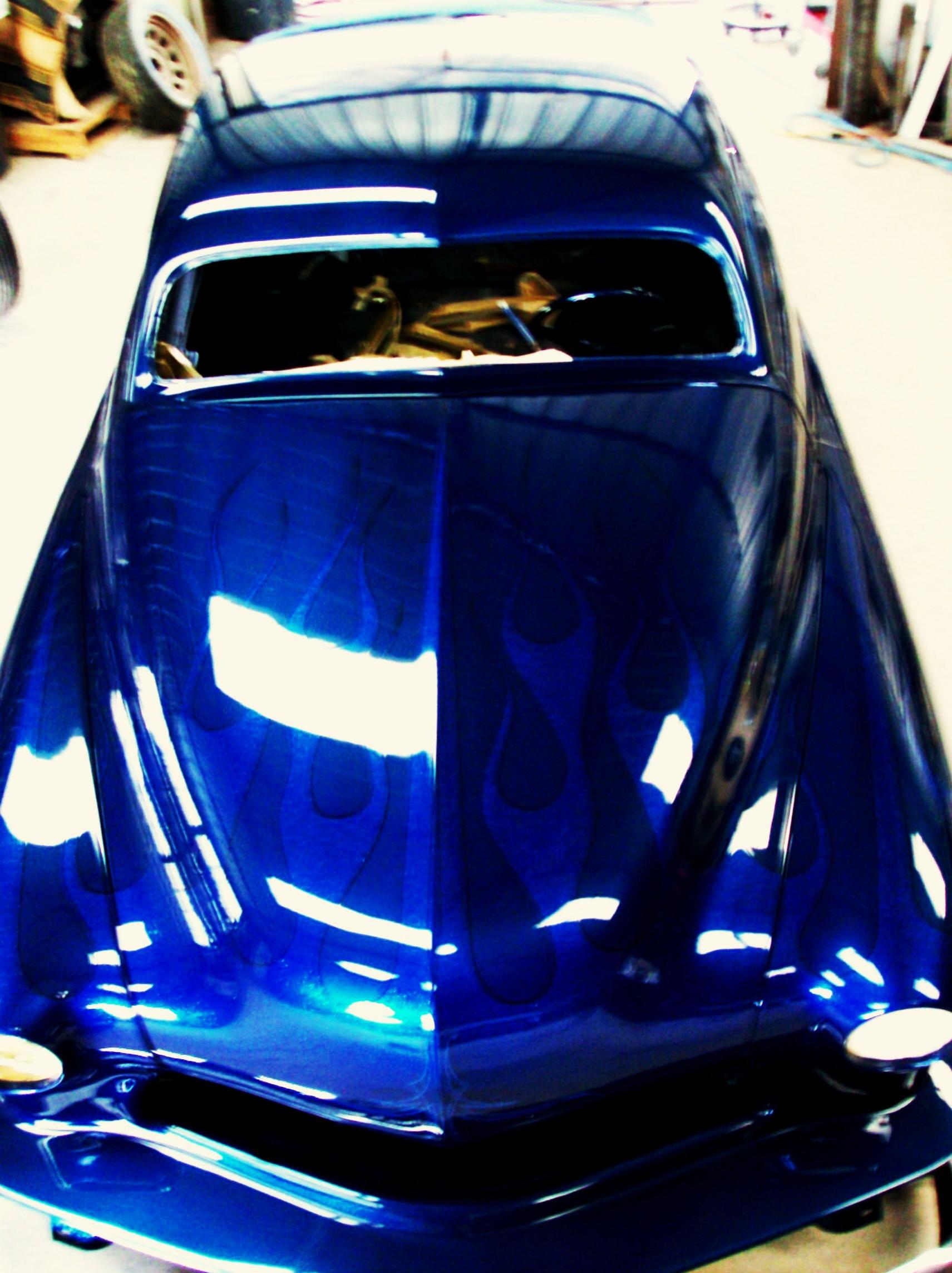

Final clear went on the other day. Almost done! Off top Ron Magnus interiors next week. This paint is amazing, the candy is real deep and with the metal flake flames. Bam! I have the pop I'm looking for. Not your everyday paint or your normal kustom MERC! You have to see it in the sun.

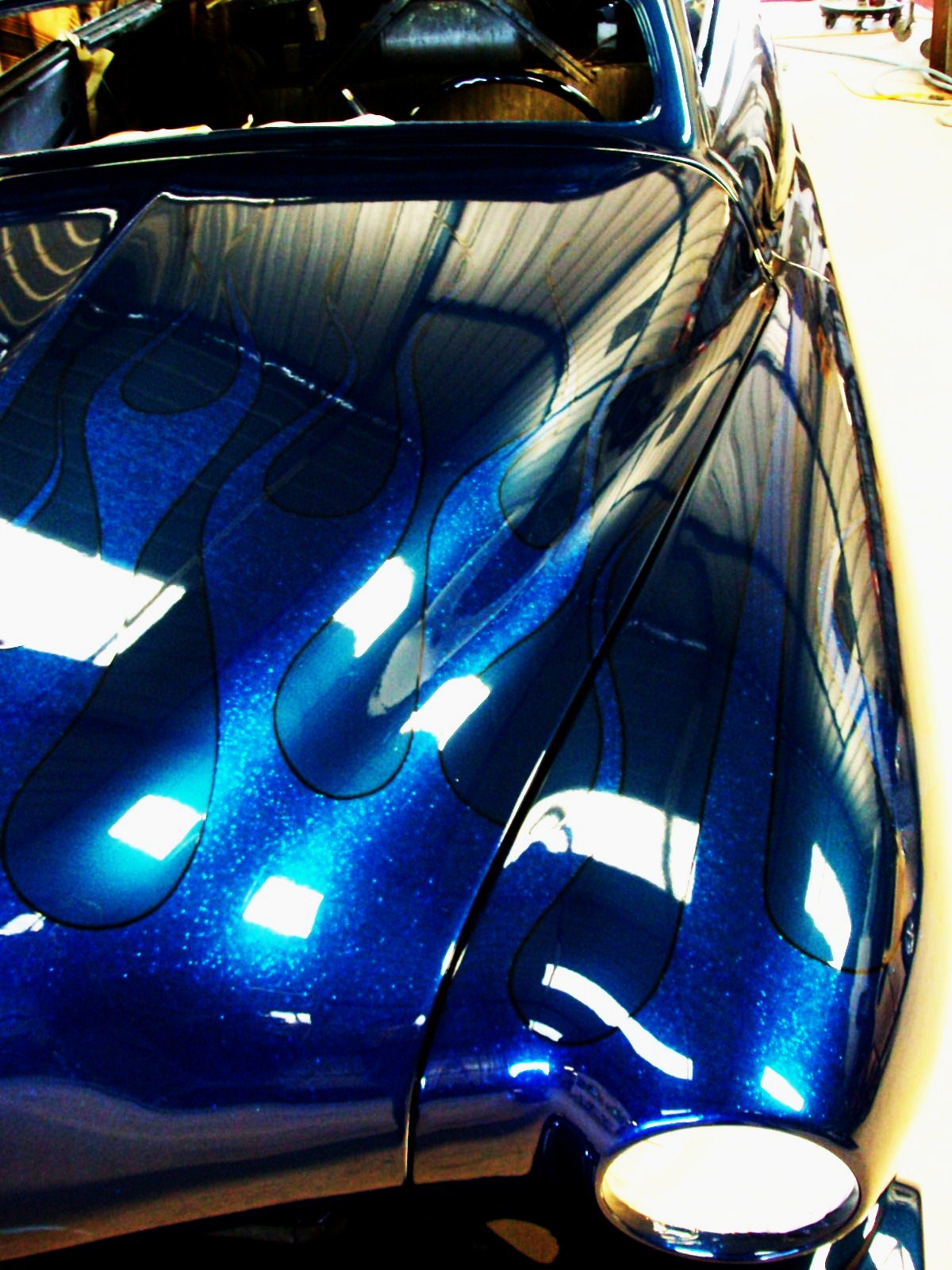

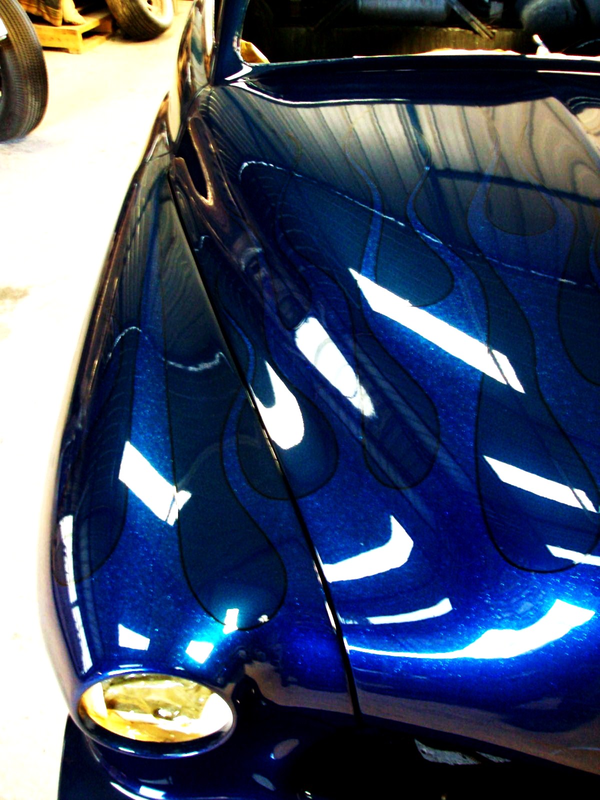

Hey Tim i did not know you started a new tread. I just add a few pics to the old thread i took yesterday afternoon with my junk shop camera but a few came out fairly good. The black stripping realy made the flames PoP
DANG that merc looks good! I don't know what the fuss was about it being too street rodderish.... freakin' eat crow ya'll!!
Holy ****balls, that looks amazing in the pix can only imagine what it looks like in the flesh,...or steel

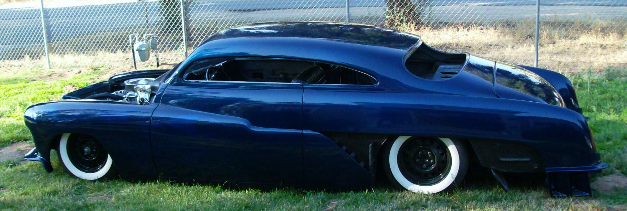

Wow I am a pushover for the Blue paint. Amazing gloss in the picture and I can only imagine seeing it up close and personal. Great job and excellent choice on the paint combination.
Wild Bill out of Riverside California did the pinstripping. Were also going to give him the dash which is all blue metal flake with candy over it.

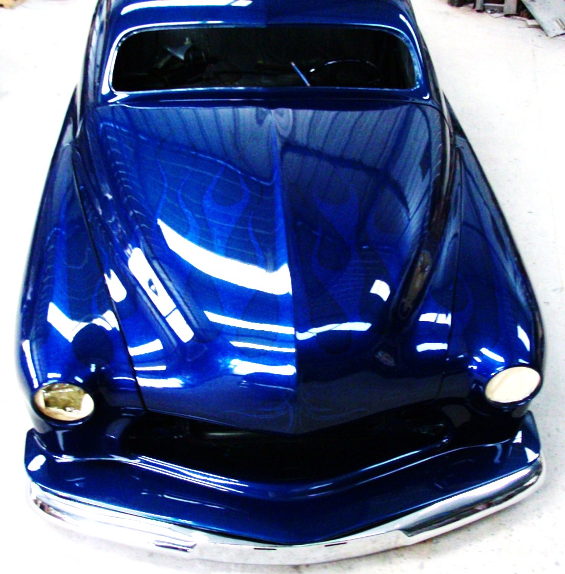

Got most of the chrome back and installed the front bumper and thought you might want to take a peak. Also took a few more pics
Got all the little last minute little detail stuff installed and working and yes it running so it's off to Ron's shop tomarrow. Here are some of the last parts that needed to be installed before going to Ron's for its white & blue flake interior. Check out the insterment pannel plastic. It was in real bad condition, very scratched and yellowed. I sanded it down on both side till it was clear again and then i painted the back side white and when dried i then sanded off the white leaving only the letter & number looking like new. Then i painted the back side in a few light coats of blue candy. Then i painted the front side in a clear. It looks almost like its a newly made custom pice but if you look real close you can still see some slight blemises in the plastic.
