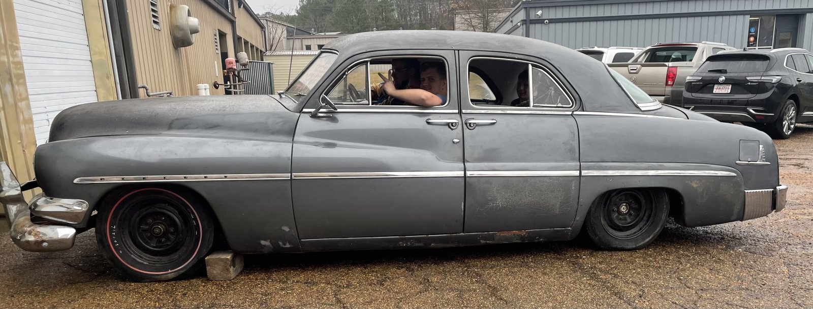

  3. Aerostar springs. Cost around $75
    Homemade 2 inch blocks.
    plus a couple students weighing it down
    $100 drop so far

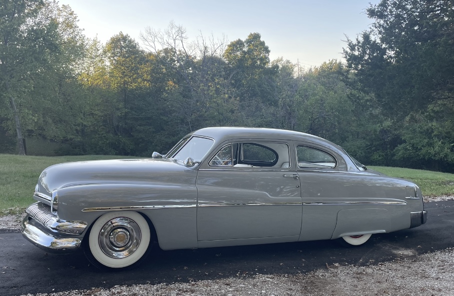

    IMG_1232.jpeg My 51 Mercury has 4” lowering leaf springs from Jamco in the rear with 4” lowering blocks. Up front I have Aerostar springs. I run 7.10 - 15 tires in the front and 6.70 - 15 tires in the rear. Flathead V8. I drive this car everywhere and it drives fantastic.

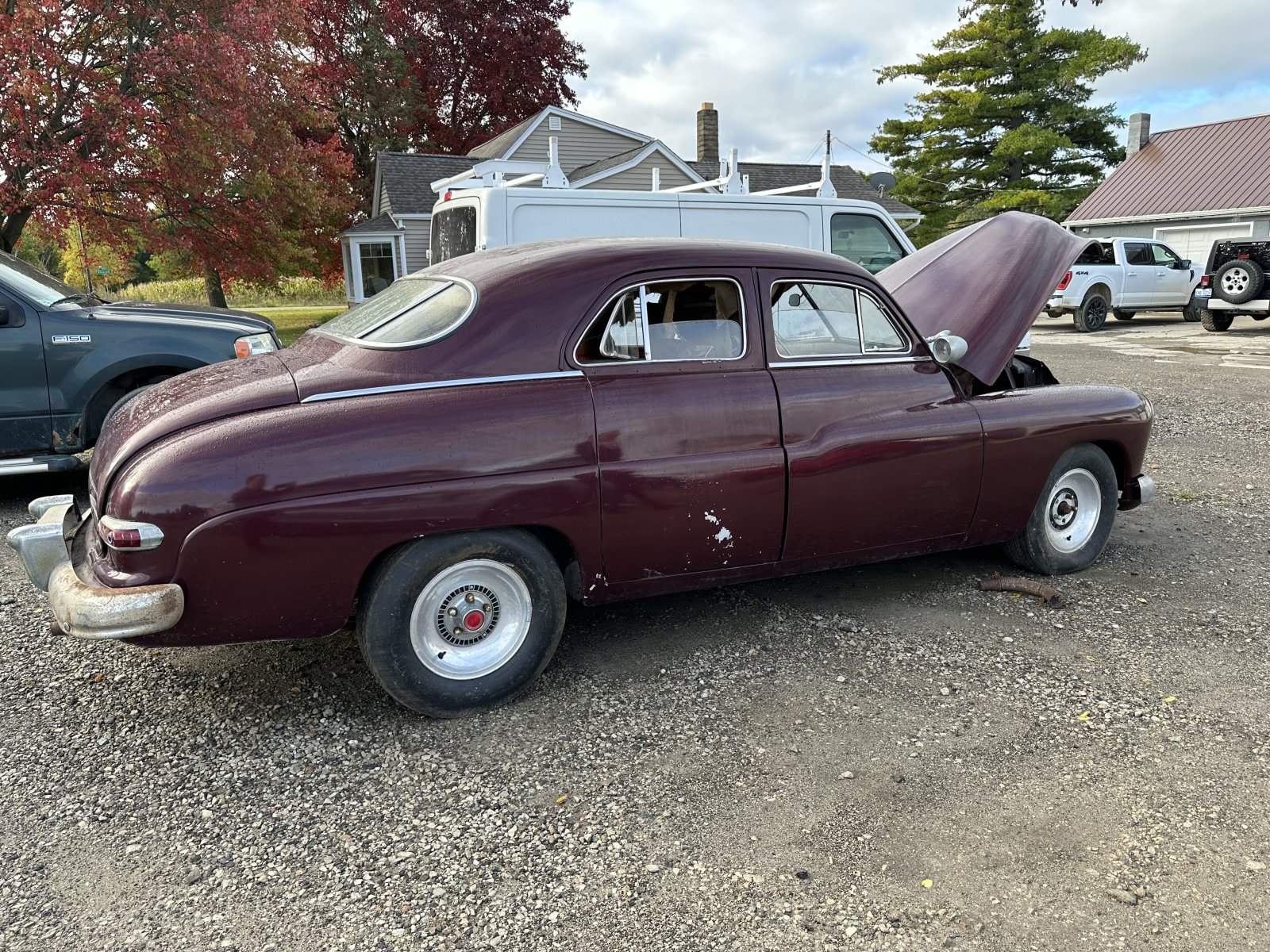

  13. MercMan64
    Joined: May 23, 2019
    Posts: 50
    MercMan64
    from Taylor mi
    I did 4” blocks on the back of my 49, huge difference. I haven’t had a chance to do the front yet to level it out. But so far I haven’t had any issues with getting into my sorta steep driveway IMG_3162.jpeg IMG_4178.jpeg IMG_4366.jpeg
