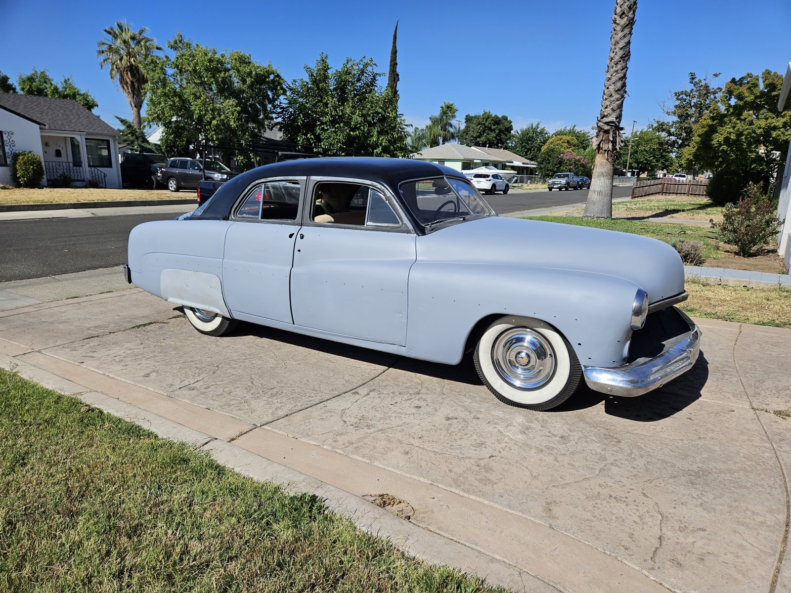

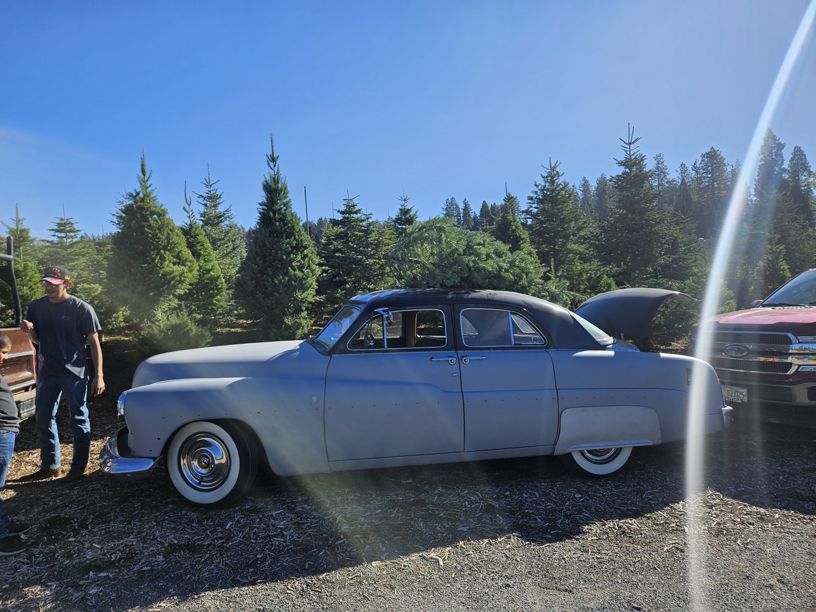

  3. Franco51merc
    Joined: Oct 22, 2015
    Posts: 58
    Franco51merc
    My Merc tires are size 6.70-15 from Universal Tire. My Merc is only lowered 2" all the way around. 20231124_105754.jpg 20230802_164209.jpg
