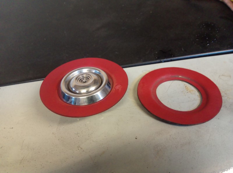

    Mine are a different story than those you are talking about. One guy i know in here Finland, made a small batch of them yrs ago and they are same size than the originals. The ****on part looks like different than on yours.
    I think you need a frenching rings too, those ****ons just doesnt seat nicely on shoebox doors. They have to be at same spot where the original doorhandle ****on is. The first ****om ***embly i did, i put them below that handle ****on spot, to make it seat better but that didnt work. It was really hard to push it, because the latch leverage wasnt correct. I did a vol 2. with frenching rings and voila. works perfectly.

    Man I like those frenching rings you got! It looks better then the ones I seen them sell for the reproduction ones.. I was talking to a buddy and he plans to run them on his as well but was talking about hooking the ****on up to door poppers, kinda curious to see how he does it, to see if I want to go that route.
  9. Finnrodder
    Joined: Oct 18, 2009
    Posts: 2,970
    Finnrodder
    from Finland
    Thanks, they are homemade. I made a punching dies for those rings with lathe. My opinion is that you cant get much deeper frenching rings than those i have. There isnt any room between latch lever and the ****ons bottom, with deeper rings you need to do some latch lever modifiying.
    I guess your buddy was talking about an electrical poppers? I think its possible to do, but i guess its not necessary needed. Well, some extra boost when opening the door doesnt hurt anyone.
    I think spring loaded poppers do the job too. Not sure yet, but probably i go with the spring loaded poppers.

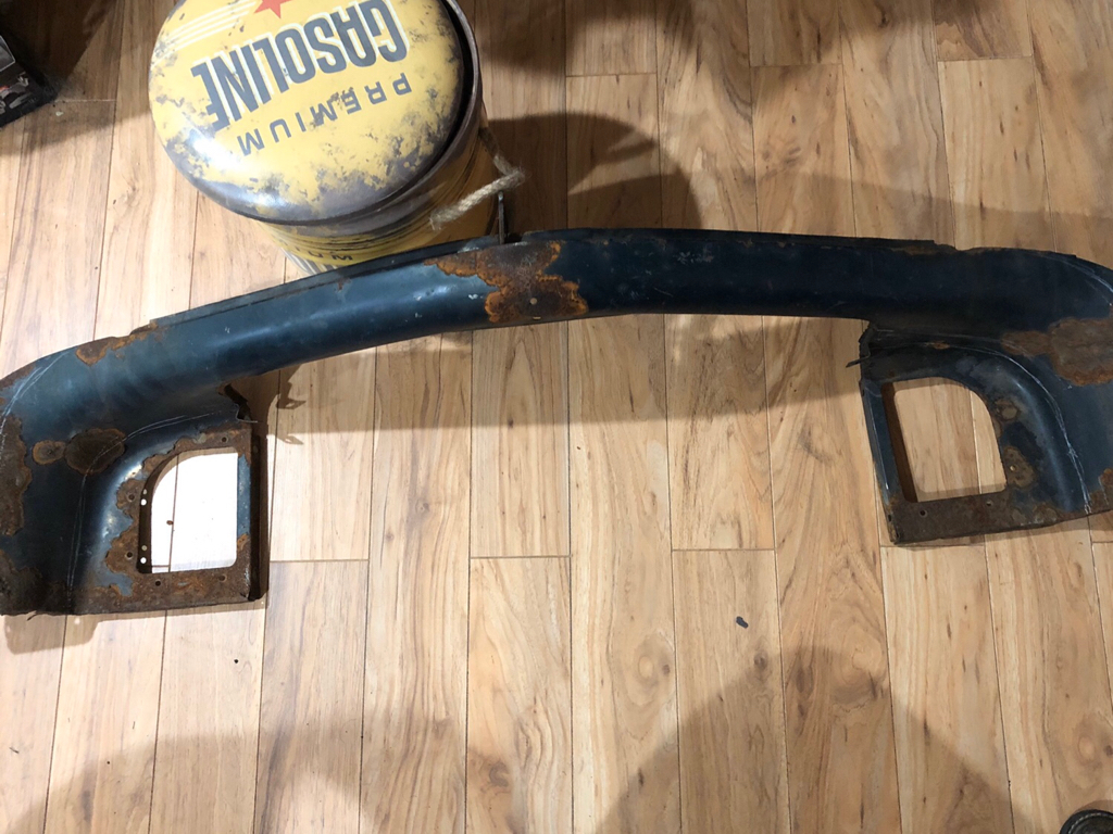

    Grille bar came in.. thing is in great shape and looks good.. haven’t decided if I’m going to narrow the surround always liked the grille to end between the headlights not under) or might use the 51 factory bullets on the ends of the bar.. pretty happy with the directions it’s going now..[​IMG]

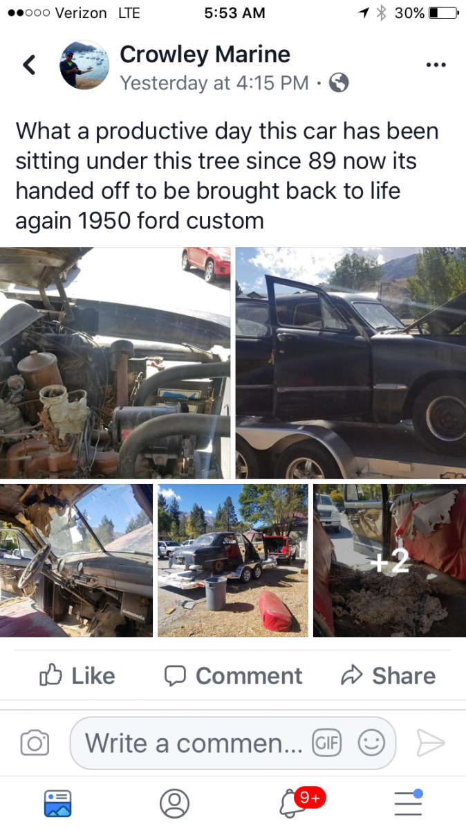

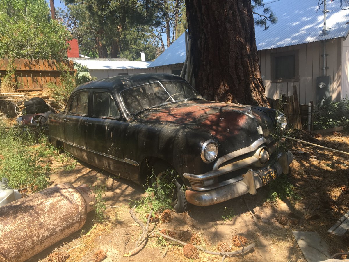

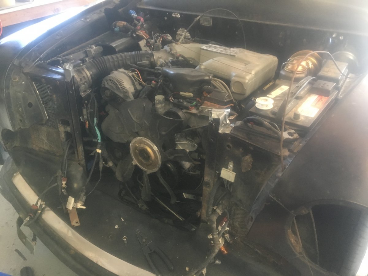

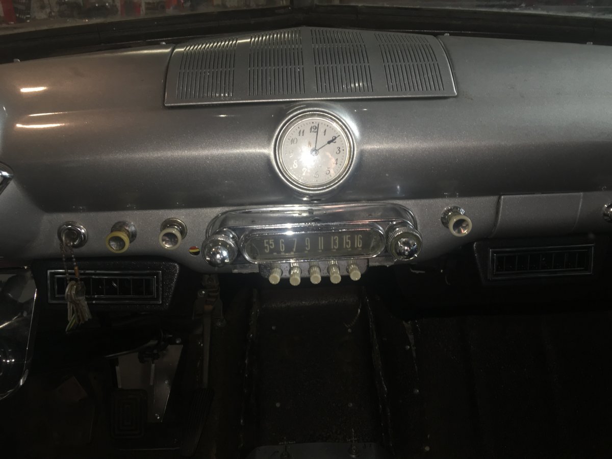

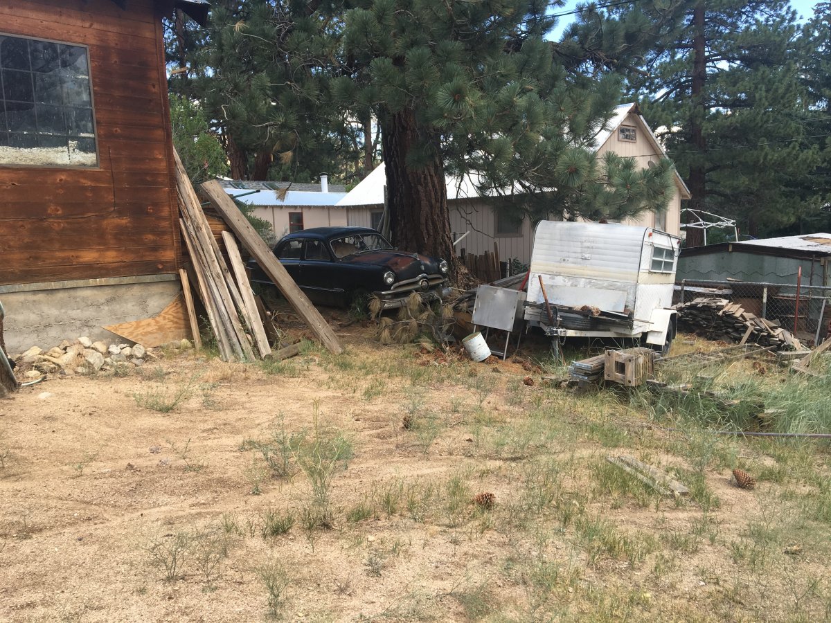

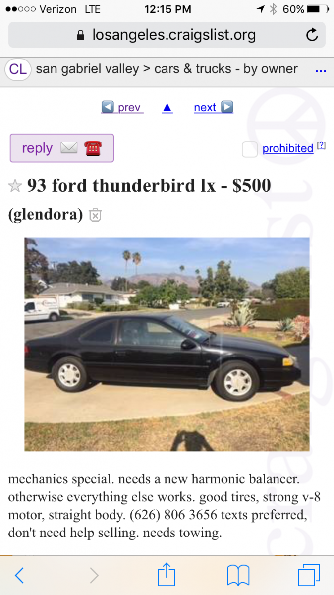

    Great reading for a quiet Sunday morning...lots of information and interesting helpful responses....We are on the downhill side of a similar project , a 50 4 door not a barn find but a "tree find" .. rescued from under the protection of a huge Jeffery pine in Toms Place Ca. about a year ago. The pictures pretty much tell the story... although the interior of the car was destroyed by animals, it had a good running flathead 3 speed overdrive, a fresh battery and gas and it fired right up...no leaks no smoke no wierd noises.. filled the master cylinder with fluid and the brake(s) worked...we discovered later only one of the 4 brakes actually worked...
    So now l began considering the possibilities...
    Leave it stock, redo the totally destroyed interior rewire from headlight to taillight as that was ruined by animals as well and maybe paint... Not a bad way to go but costly...although the car would need all that in any case...
    So even though the car had interested me for years...l had tried to buy it from its previous owner for years and the answer was always "One of these days...." I ended up buying the car from his estate...l decided l had chosen the wrong car for a project...it's a four door..and put it for sale....no interest .
    After about a month of trying to sell it and doing basically nothing l decided to try selling just the engine...if l could get enough for it to help finance the project...Almost instant response! So l took a video and some pictures to help confirm the deal and got busy removing the engine and transmission. We then began forming a plan..
    I wanted to drive the car anywhere any time and make sure my wife could as well if she so desired ..I drove cars from those years as a younger man...they were fine at the time...and they say moms and grandmas drove them too..my mom hated them but what choice did we have...
    Power brakes power steering air conditioning good lights comfortable seats electric wipers etc...Bought a good running 93 Thunderbird for a donor car...Ford Ranger rear end...driveshaft from Ford Explorer both from pick n pull..wire from Autozone...The pictures fill in the blanks...and l look forward to more posts from you as your enthusiasm is contagious and gives encouragement to forge ahead to the"finish" line...
    Pipes likes this.
