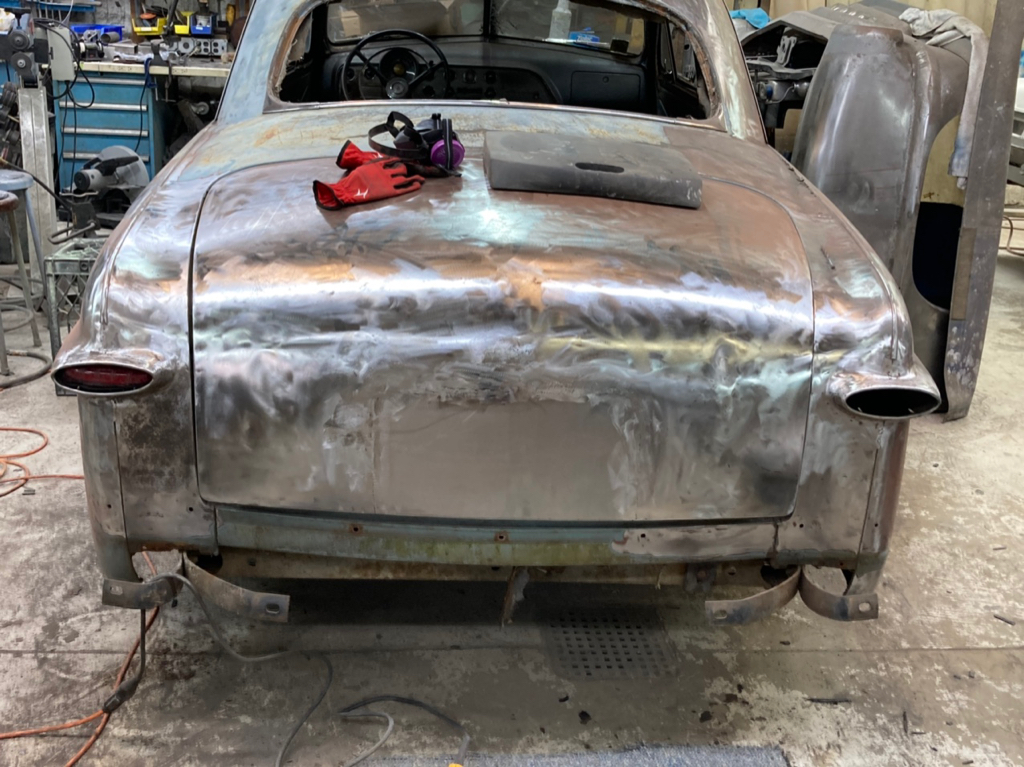

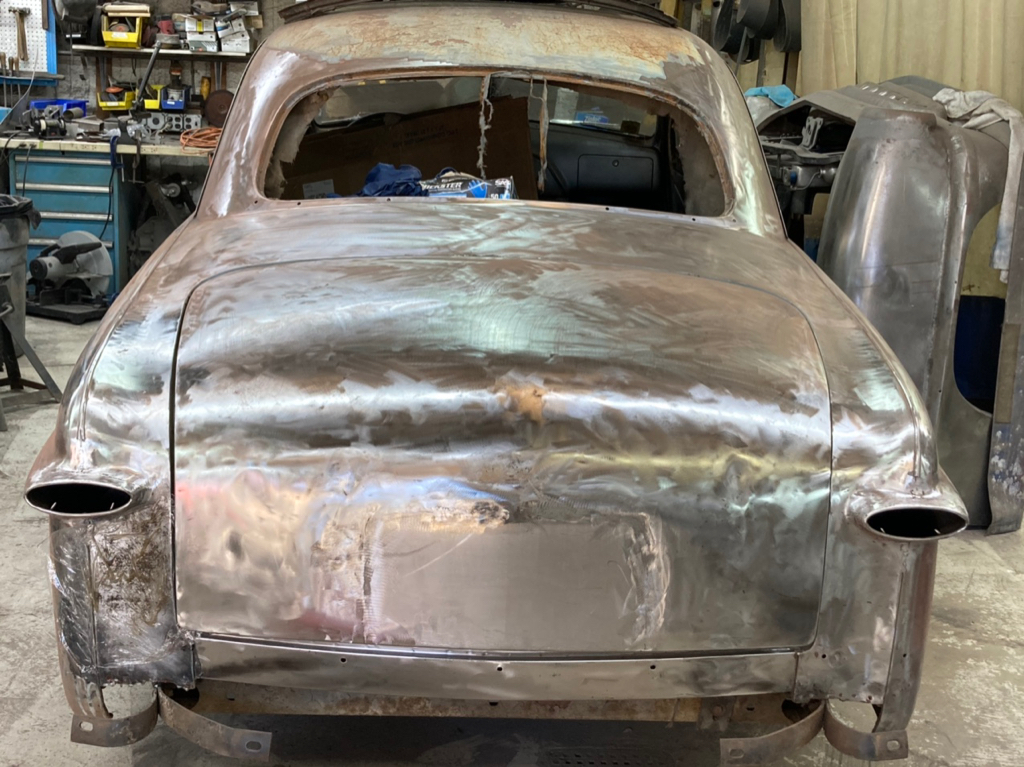

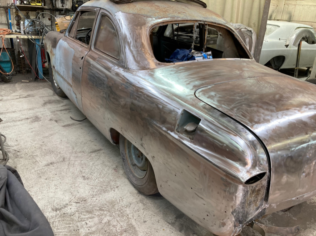

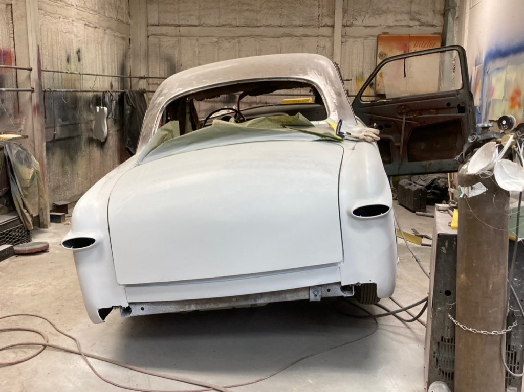

    Didn’t take any pictures but yesterday Chopolds finished frenching up the drivers said taillight, then we swapped out the 58 “ wide, 9 inch rear I had there for a 56” maverick rear. Big difference in clearance. Now I will have no problems running the 51 merc skirts! Hoping to sort out some side trim and a trunk latch this week, and get back to sanding more of that paint off this weekend.

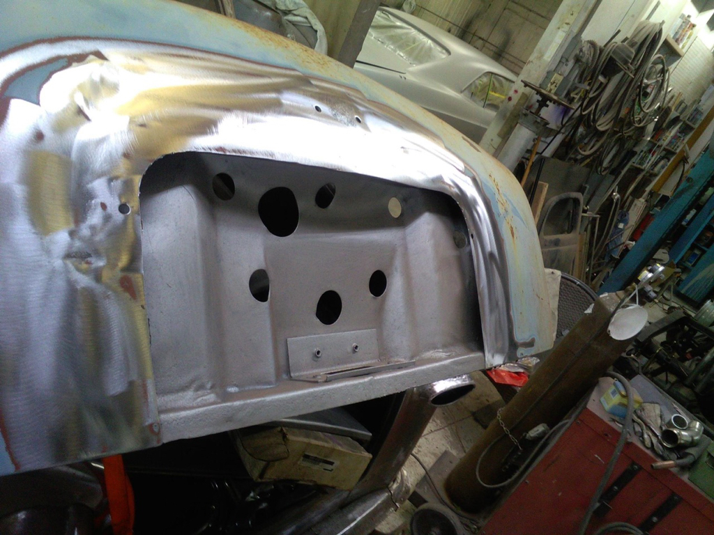

    Mark(Chopolds on here) sent me some updated pictures of what he did today to the trunk.. cut out the plate recess, made the patch panel and put it on the English wheel then welded it in.. man I can’t wait to get there this weekend and put some work in![​IMG]
    Some por 15 on it
    New panel
    Welded in with the Frenched taillights.

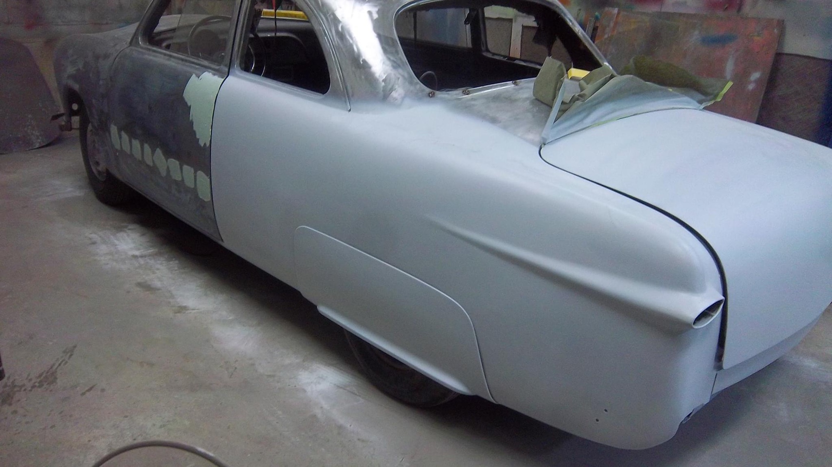

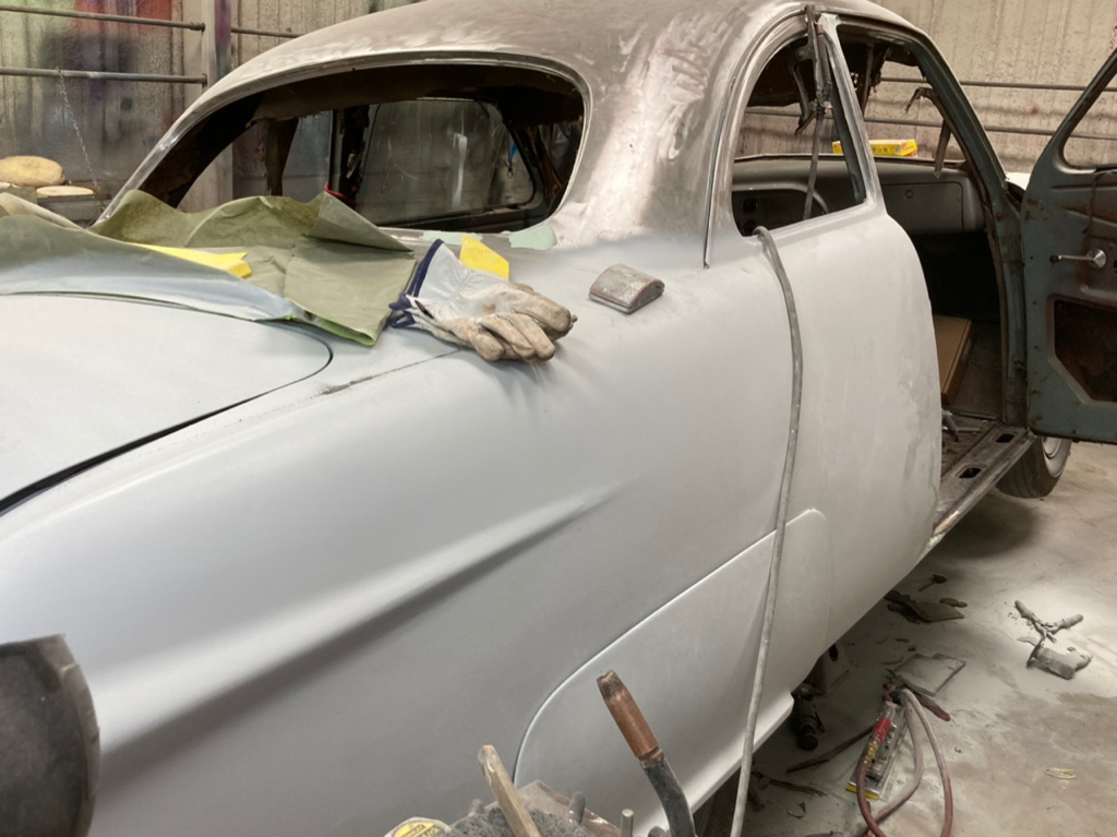

    The sanding continues!![​IMG]

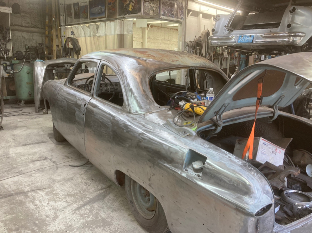

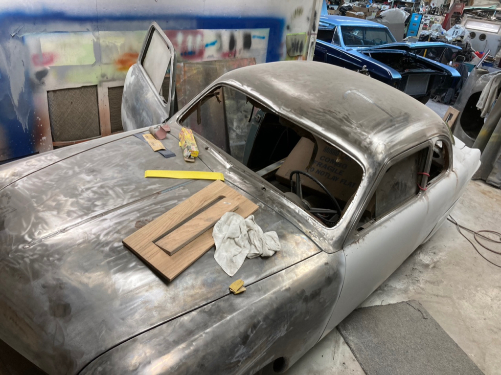

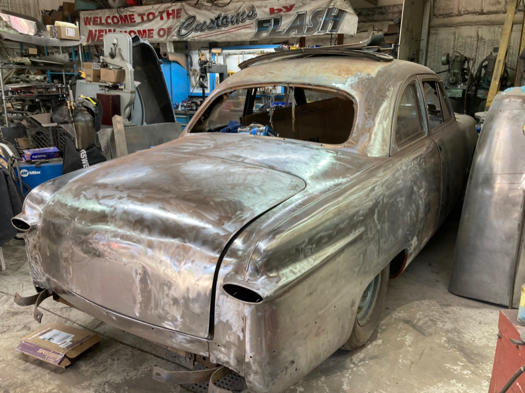

    All that left on the outside is little bit of the roof to strip..

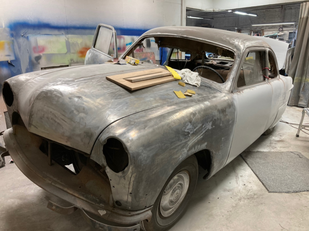

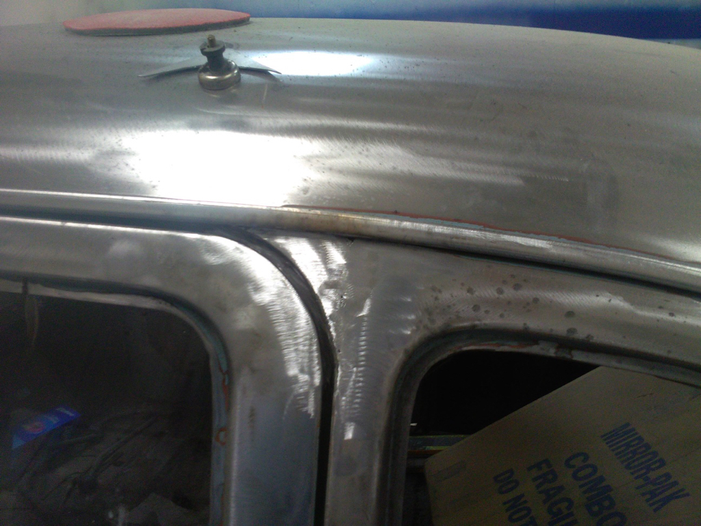

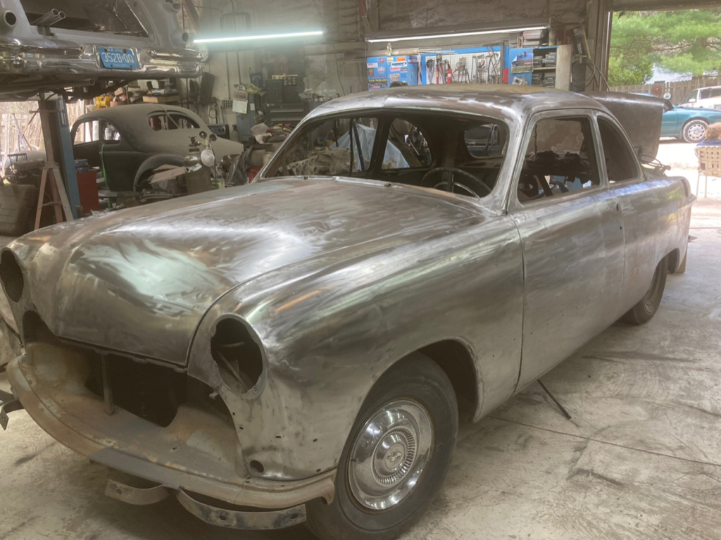

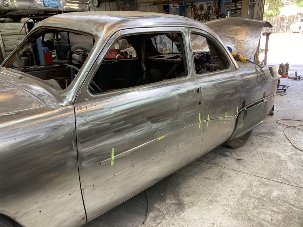

    This weekends progress.. got the body all stripped for the most part.. need to do the inside of the trunk lid, the engine compartment and window and door jams. We taped up the 51 merc skirt then the trim to give me an idea what needs to be done, going to order two more quarter pieces and put them on the door and front fender. We think it will work better. Mark Wojcik started welding up the seam in the p***enger side quarter, while I tried to get inside the window areas. Pretty happy with the progress! IMG_5794.JPG

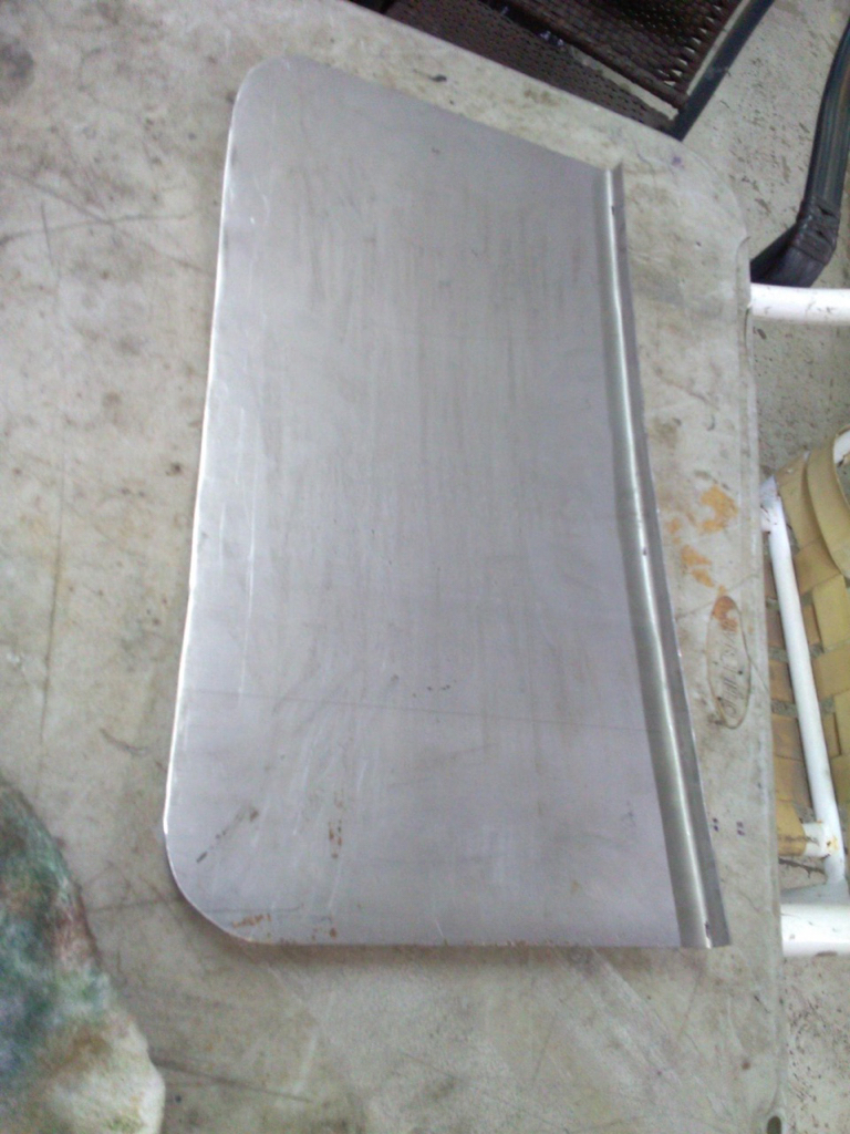

    got it from a guy on facebook, sold be the quarter panel pieces, both of the check pieces, and the door trims for 50.00 plus shipping. Think it ended up costing me almost 67.00 all together. Im looking for two more quarter panel pieces. I want to use them for the door and front fenders instead of the stock dodge door trim.

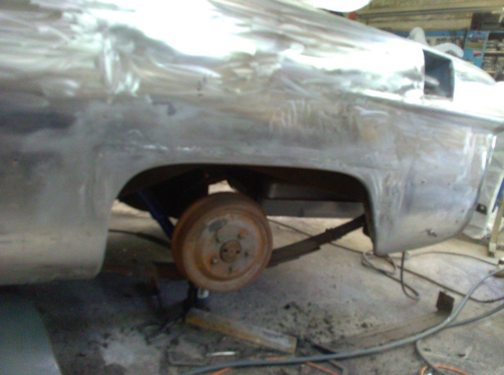

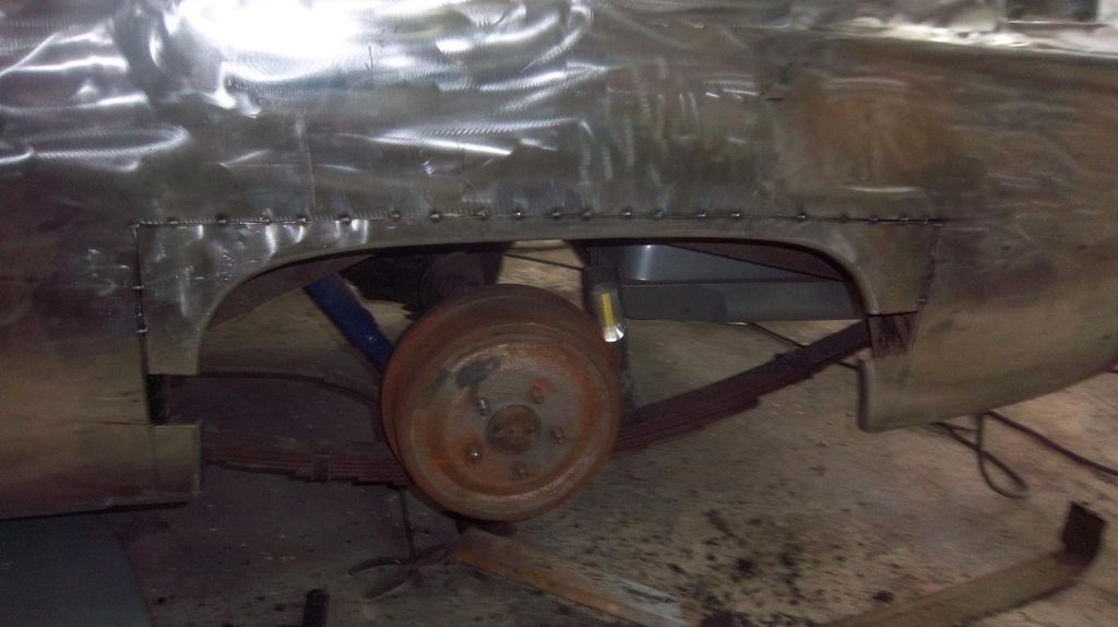

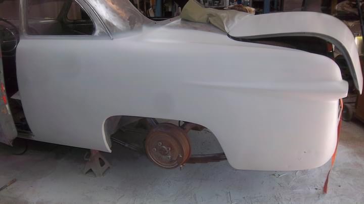

    Mark, (Chopolds ) from Customs by Flash getting some work done on my coupe.. sent me these pics tonight!! I am no longer going to have to worry about fighting with the removing the rear tires when it’s lowered!! The 51 Merc Skirts gave plenty of room to raise the wheel wells! Thank to Gunar Hansken of the Swanx car club for the idea!!
    Here’s the rear wheel well to start..
    Some cutting..
    Little bit more...
    Some welding..
    Now the wheel well fits the 51
    [​IMG]merc skirt instead of making the skirt fit the shoebox.. all in all Mark said he raised it a little under 2 1/2 inches. Should have no problems with taking off the rear tires now!

    Chopolds posted some pics up,of the wheel well tonight..[​IMG]
    And now the wheel goes on with no issues! [​IMG]

    P***enger side rear wheel well just about done![​IMG]

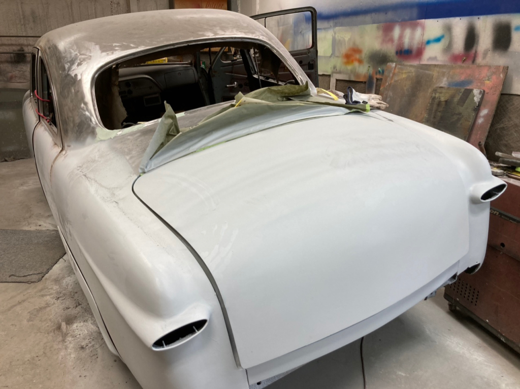

    Mark, ( Chopolds) at Customs by Flash posted these last night! Right quarter is now all finished up! The more I look at it the more I’m amazed. Between raising the rear wheel well, frenching the taillights and decking the trunk lid, the coupe is coming together! All that’s really left for the back end, is mounting the remote trunk latch. The skirts may get a little modifications to the front side, so it matches the new trim line, but otherwise they are done! Next up doors and front end!!!

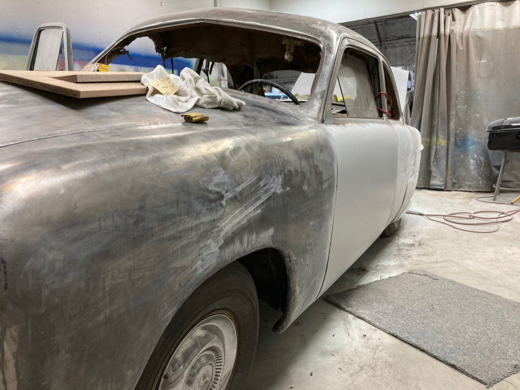

    More updates.. after seeing the pic with the skirt on, I just had to ask Chopolds to go ahead and do a little work to the doors as well.. I am so happy how it’s going!!can’t wait to get there Saturday![​IMG]
