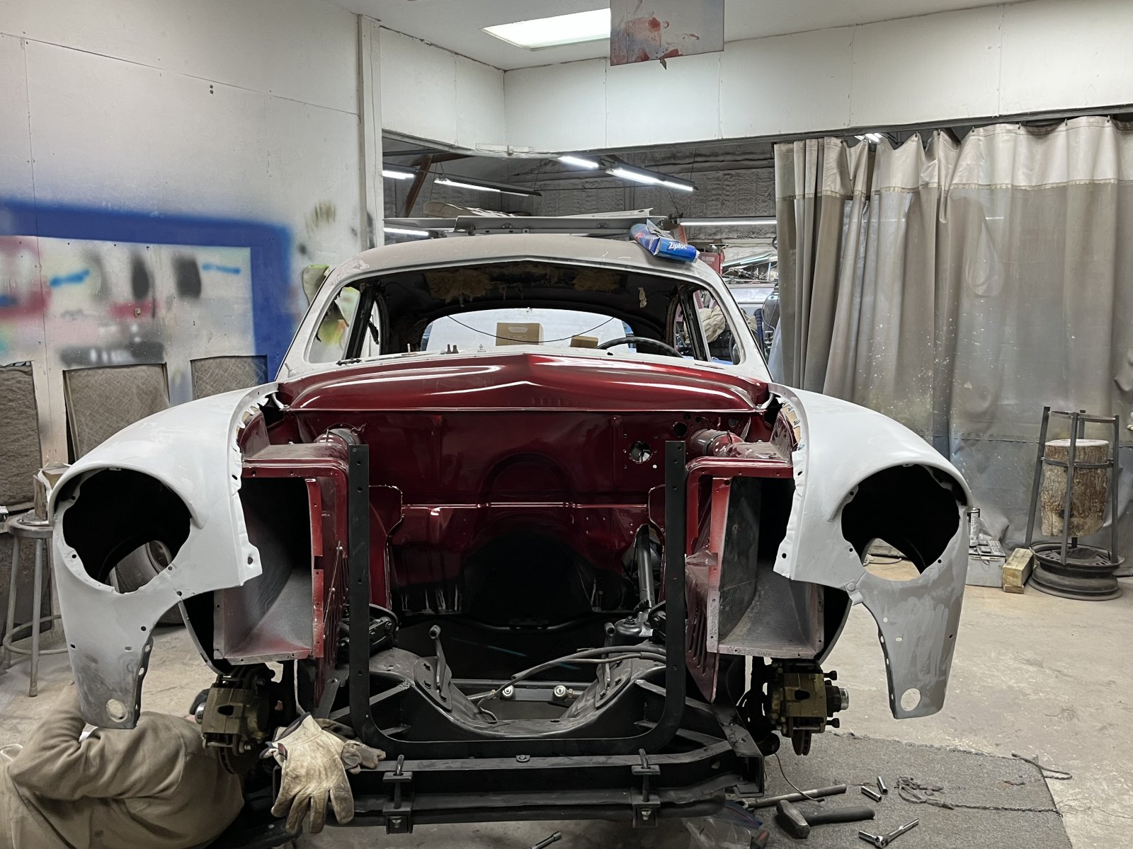

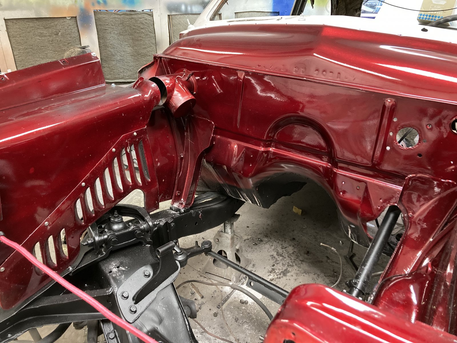

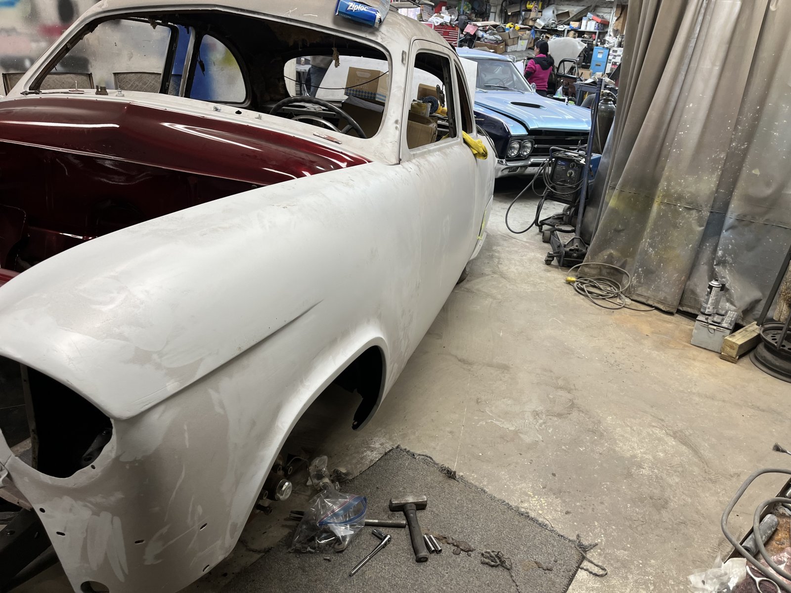

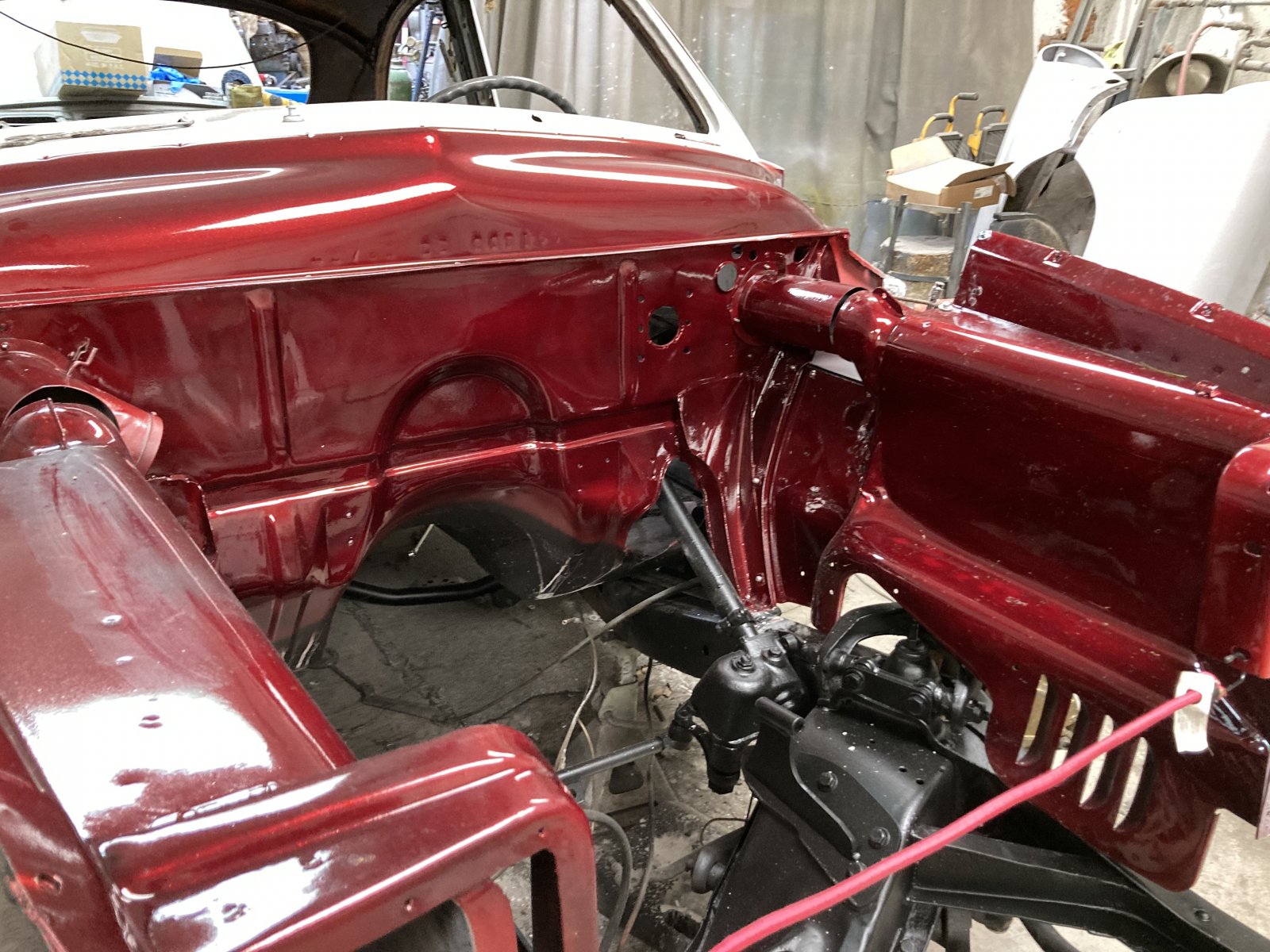

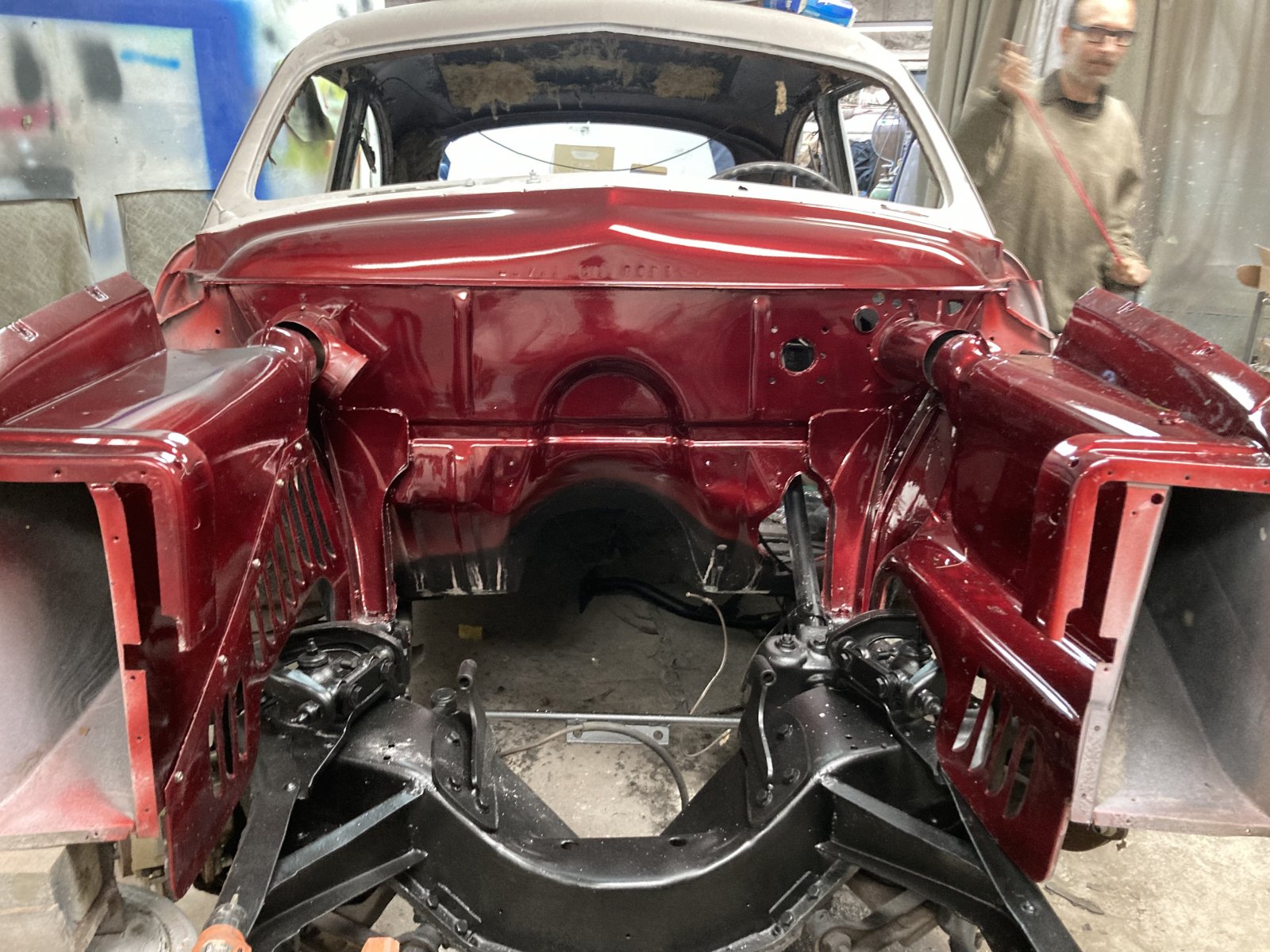

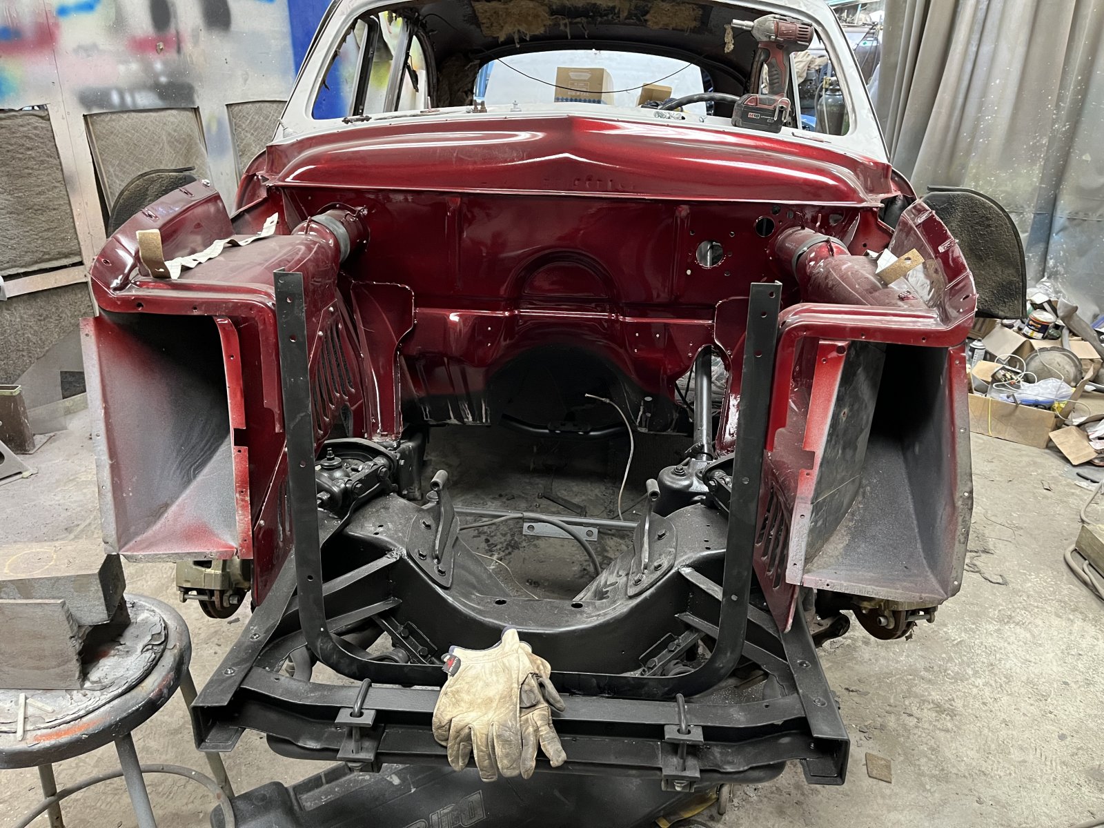

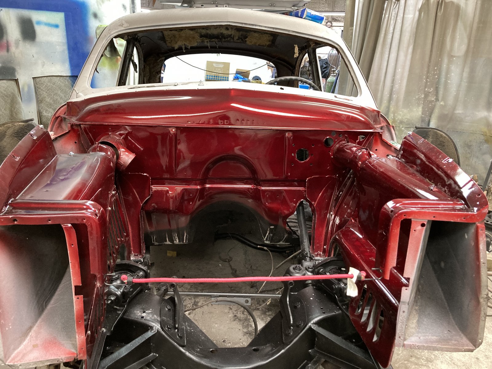

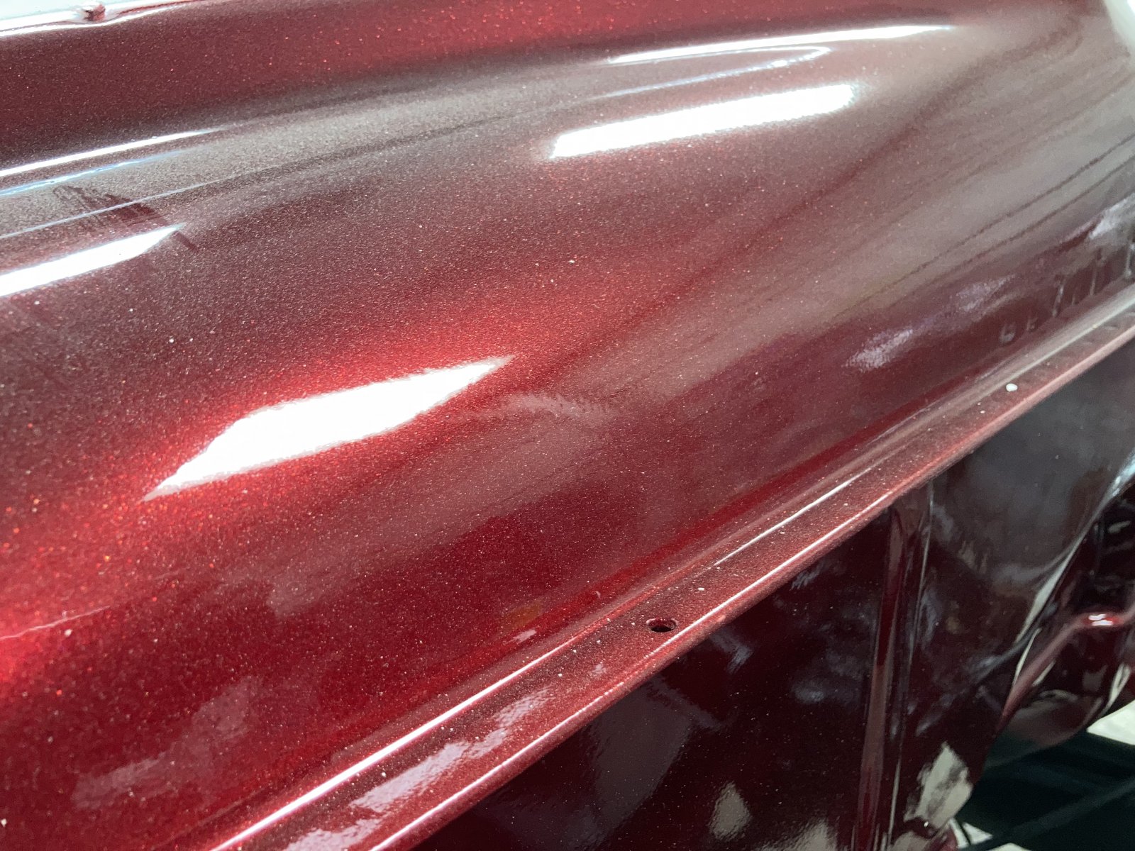

    C4F9FBC4-79D1-4FB0-AA61-F4F92001A585.jpeg 963943BD-F9D8-4109-A49F-78C9AF43A0CE.jpeg 0194D6FF-F499-4DA7-B188-D61762E3E468.jpeg 7096602A-4323-4102-BEAE-35BE961D229E.jpeg B4B9FCC5-80EC-4487-B55C-29BBE24D5FBB.jpeg BB9E4AA9-03FF-4EE3-8C26-725B2F92BAA2.jpeg 94B88F2D-6A0C-43CF-829A-D6388378FE14.jpeg Got to go to the shop today and work a little bit on my coupe. Was awesome to finally see the paint Chopolds laid down on the firewall and inner fenders.. absolutely what I wanted. Bolted up the inner fenders and it’s just amazing how far this car has come in less then 9 months.

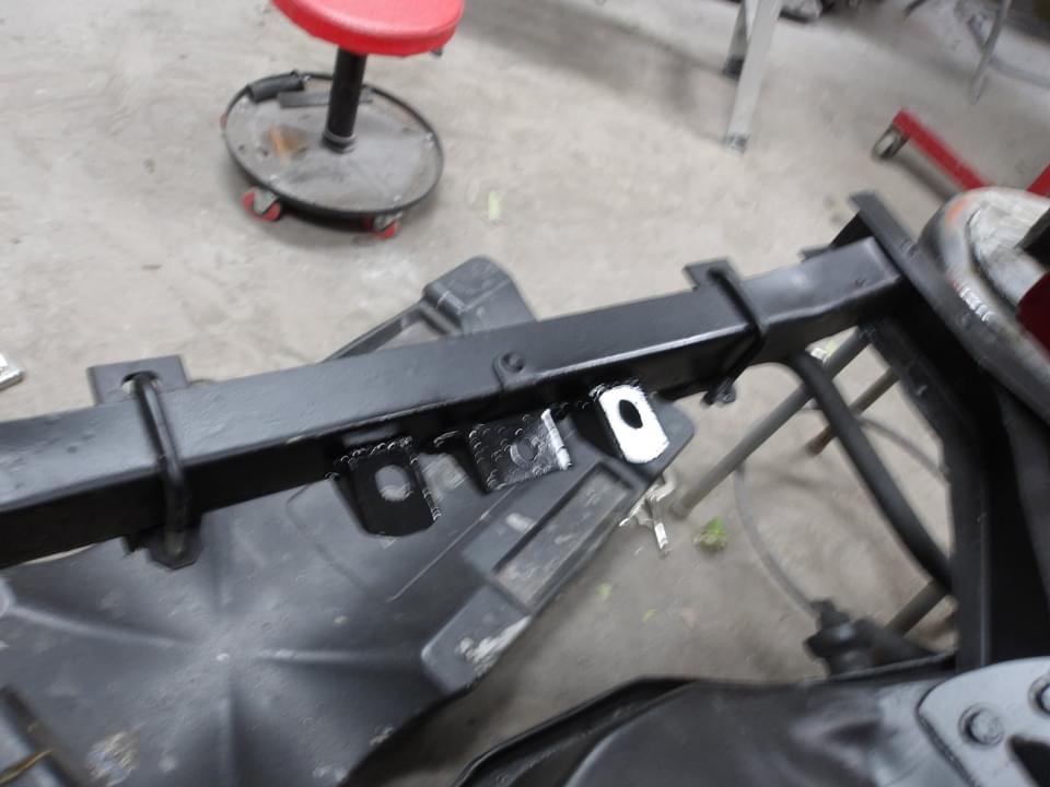

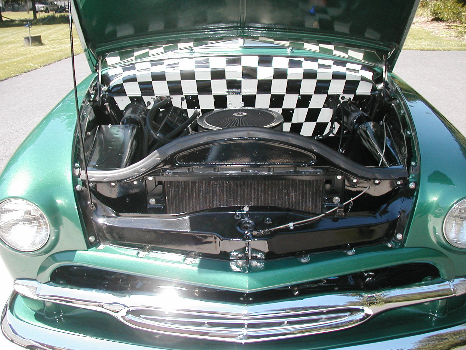

  8. Factory design core support isn't much of a support in stock form. It's just a week piece of light weight angle in an open top U. Ford thought the soldered on rad brackets would support the weight and leverage of the Fenders. The only help it had was the Air dam made out of 18 gauge with a dog leg pre formed in a place that eliminated any help from it at all. Then to make sure there was no chance at all to keep good gap and stop shake Henry mounted it with a single bolt dead center on the Bottom and no support rods from the firewall forward. If your going to spend time getting good fit and want it to stay I advise you do is 2 things. Change the single center bottom mount bolt on the core support to two mounts one each outboard end of core support and then tie the top corners of it together to take the load off the rad. In this photo I have a piece of 1" X 1/8 thick angle bolted under the top tank keeping it from spreading and totally out of sight.
  9. P.S. This unwanted flex movement I believe is why it's well known these 49-51 Hoods are known to open on there own at speed. That is never a good thing.

    Good idea thank you!! I need to go over that with Mark. We are planning to weld the front end all together and radius all the hood corners and the front of the doors, then do the merc grille surround, so the sturdier the better!
  11. Going from a single on center mount to both outboard corners makes a huge difference.

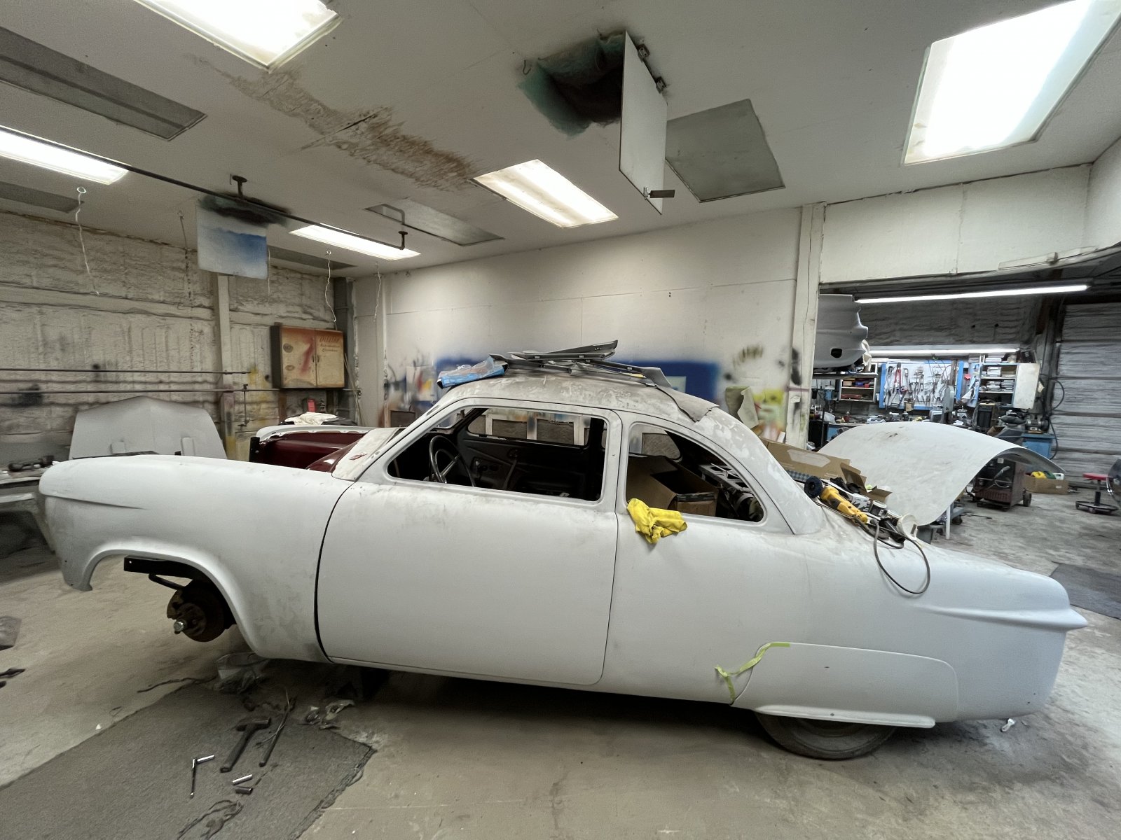

    Tony Ray

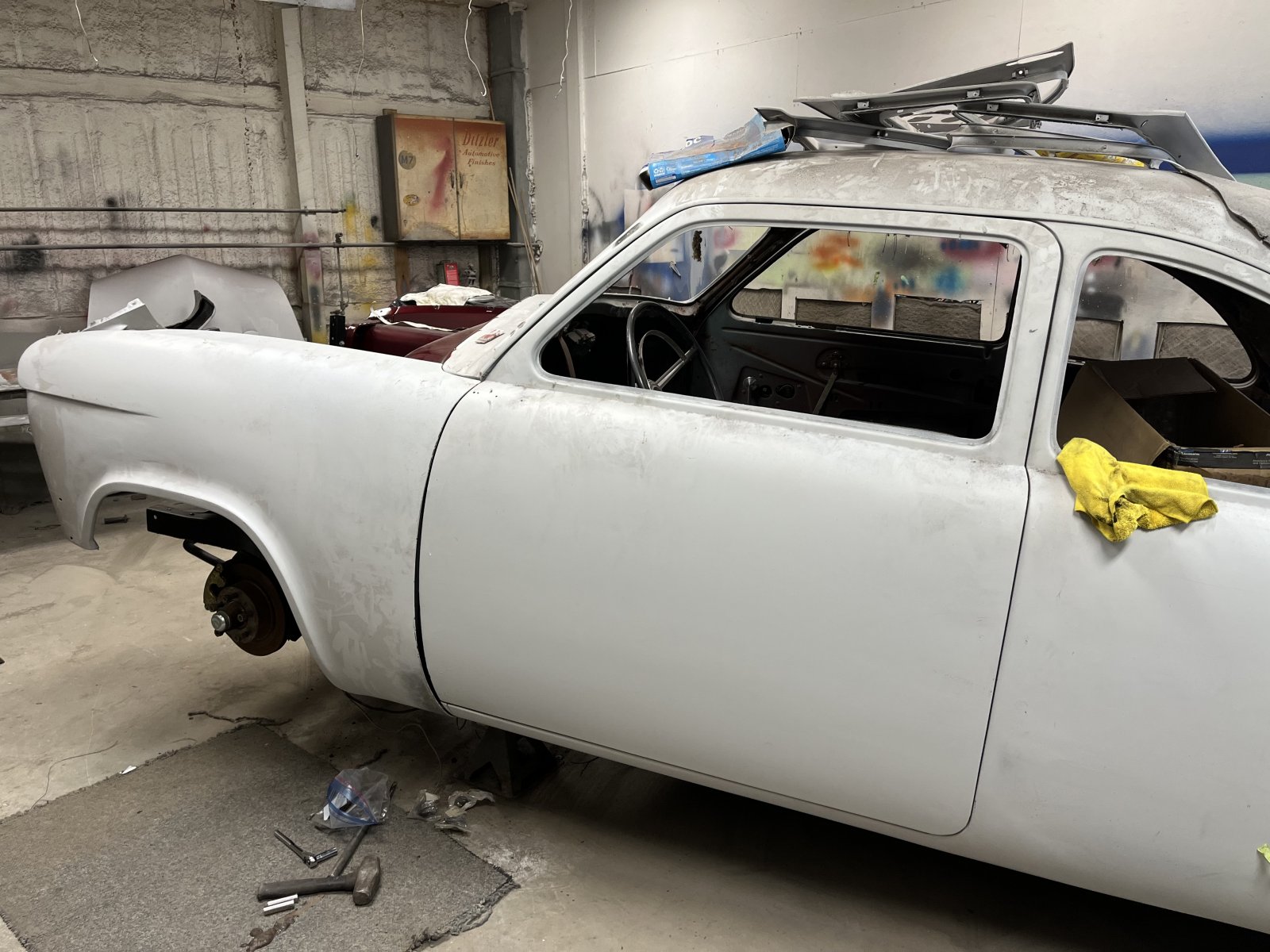

    66ED74D1-9AA6-4487-94B8-7056B31DF746.jpeg F0E9157B-F1AA-4B12-A35A-136F21EE6249.jpeg 2100B5F9-4804-40D8-A5E5-D54E357CE3C6.jpeg 4DF0065A-8629-483E-8901-C235EDFFB22B.jpeg 963AF86B-D408-4B8C-A1D4-49180C290841.jpeg BB6E53B9-9CE9-42DB-AEC4-5CD2D59D3FF8.jpeg EE81AECA-F2DD-43F8-8660-4A42DC25B3C9.jpeg Progress! Mark, (Chopolds) made two more radiator support mounts ,at Pist-n-broke suggestion, should be nice and study now.. I was able to get a couple hours in at Customs by Flash today, and bolted up the steering upgrade kit, then Ron and I bolted on the fenders. The p***enger side,may need a little tweaking but man, it’s starting to look like a whole car again!

  18. I like it. Once you weld the fenders to the Cowel and rocker are you going to radieus the front bottom corner of the door also?
    Thor1, Tony Ray and loudbang like this.

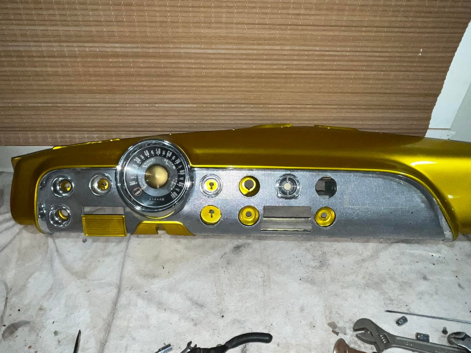

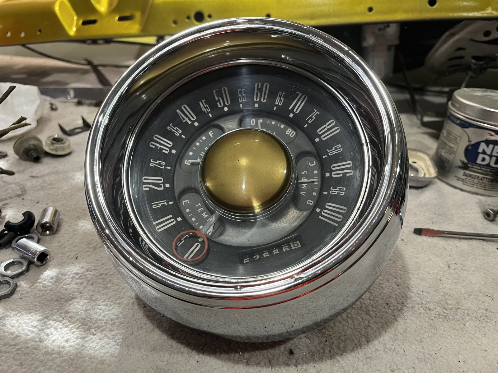

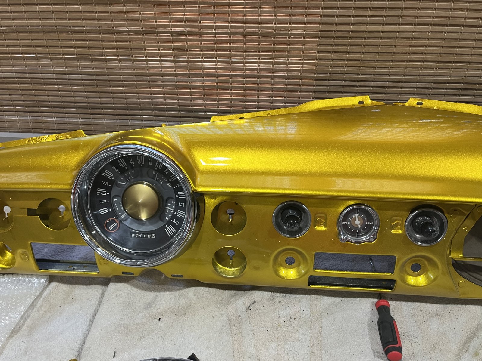

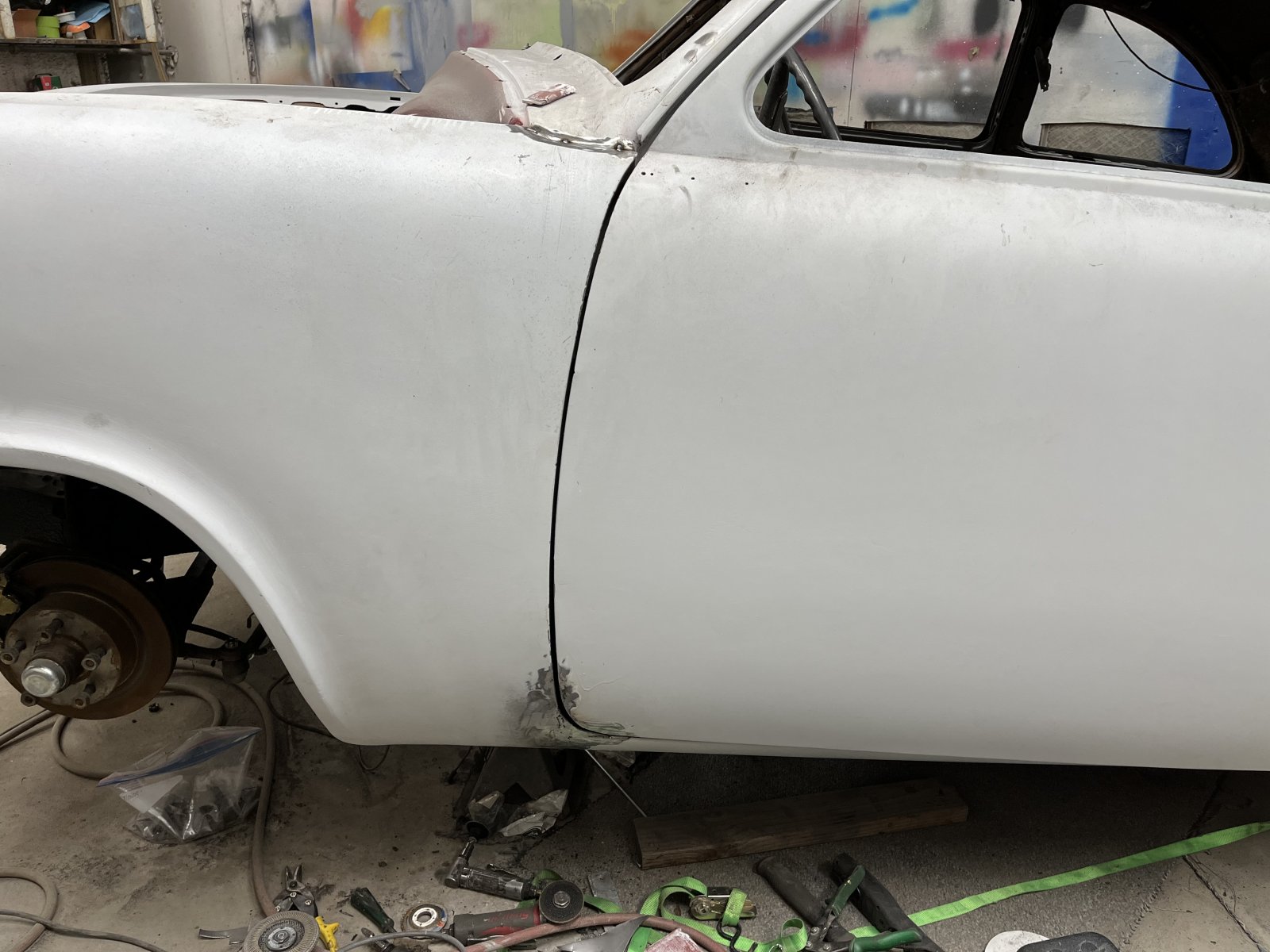

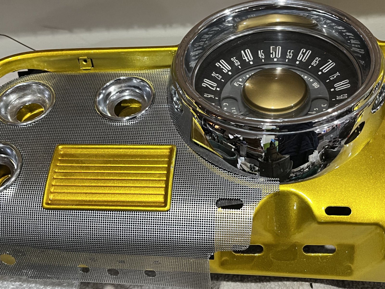

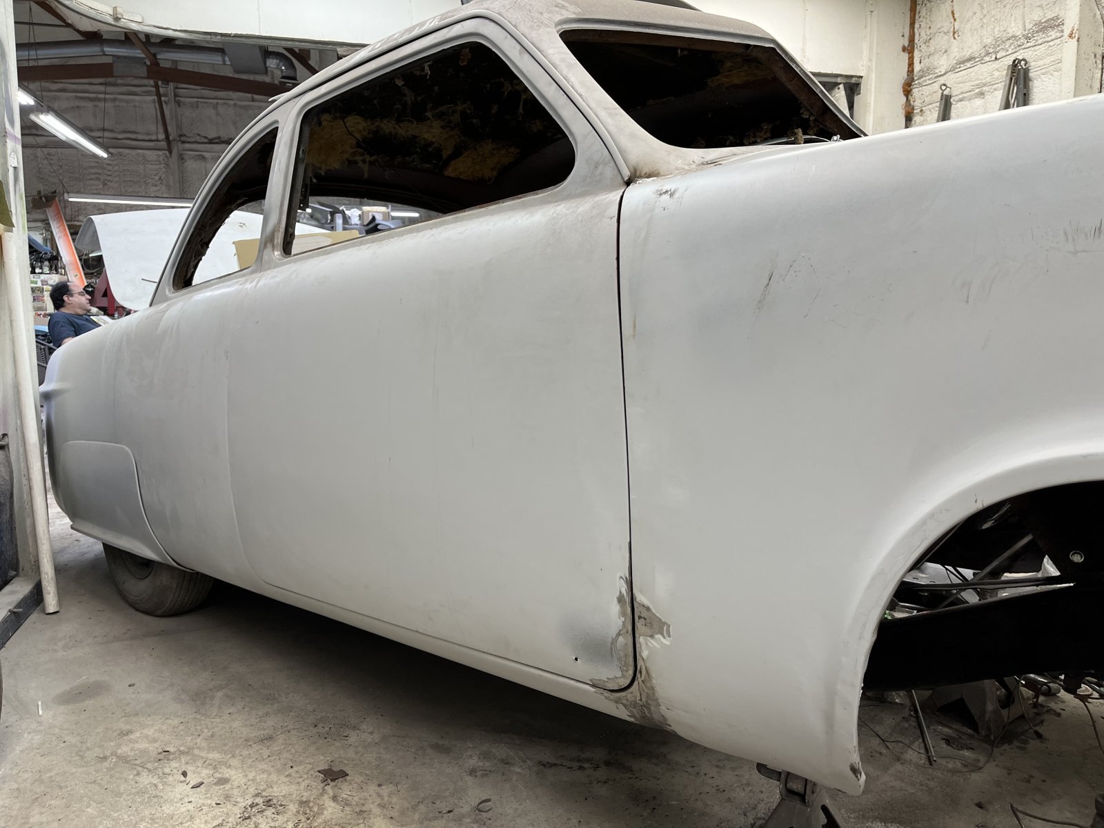

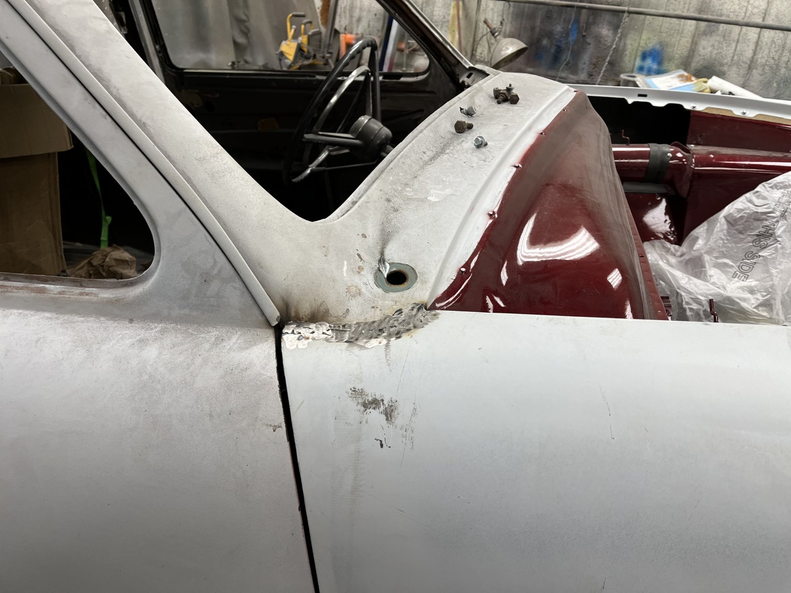

    More updates! Fell behind a little bit, but so far Mark welded the front fenders to the cowl and rockers , rounded the front corners of the doors, and rounded the back of the hood corners! Front ones will be done once the merc grille surround is on and we can get the hood lined up on the car. Waiting to go pick up the engine when they are done the machine work and get it put back together and installed. In the mean time, I was able to get a hold of an early 51 speedo cluster, with the red ring on the needle that was in a chrome bezel! Man this think pops against the gold dash! The dash screen insert has been a pain in my *** trying to figure out what to do and not make it so stock looking. I tried drum skin but it looked too translucent, was going to paint it, then one of the guys at the shop, Ron talked me into trying some chrome powder coating.. it looks great! Going to do the whole screen like it and have Polyking do all of the knobs.. hopefully the dash will be ready to install next month! Here’s some pics…

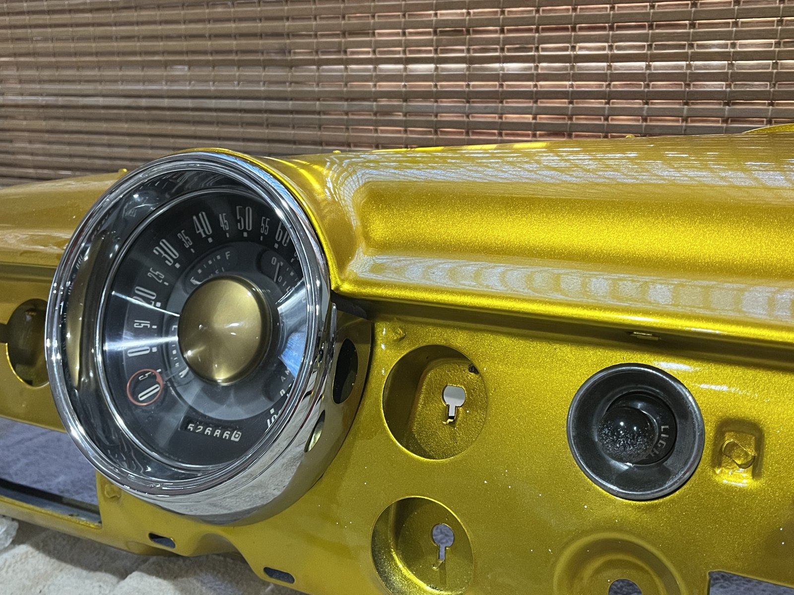

    And more…

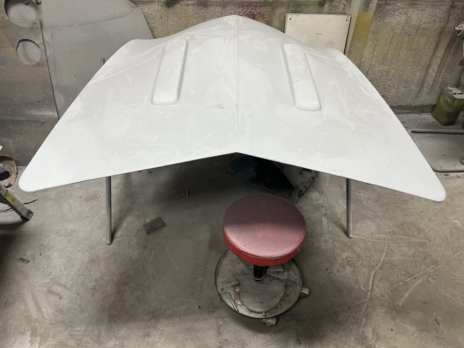

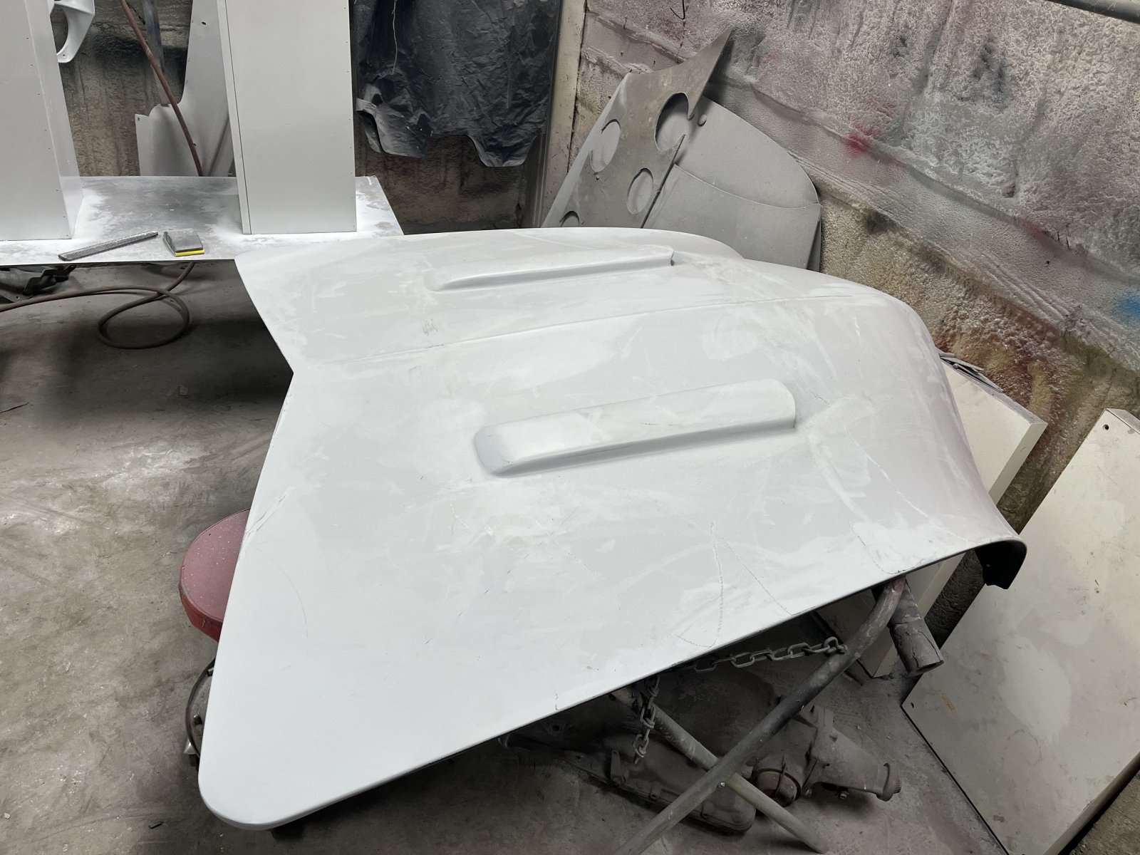

    Looking good, I just can't get into the scoops.
    Tony Ray and Thor1 like this.

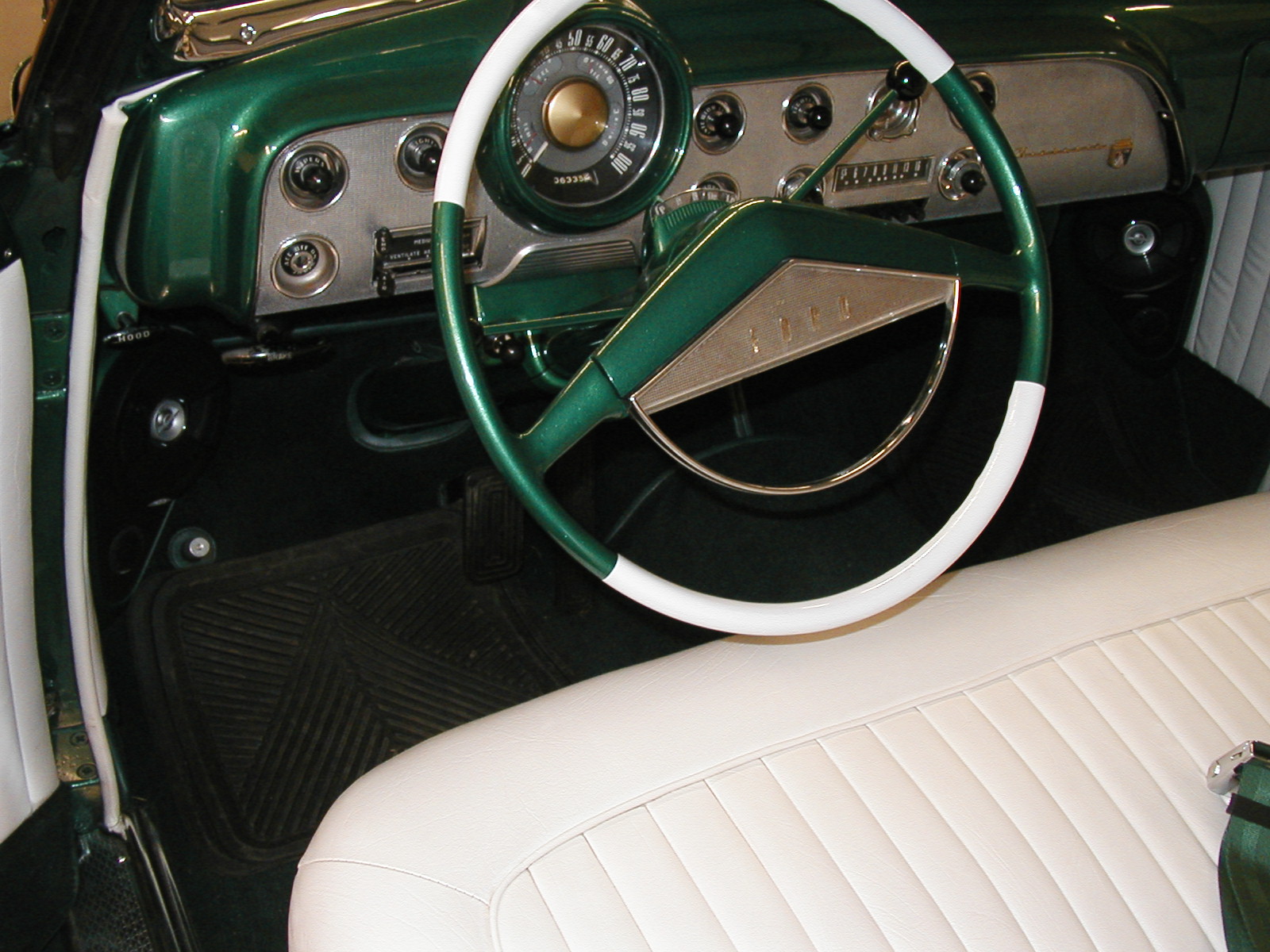

    I did the chrome bezels in black along with the screen.
    And the Vintage Air control fits in the old heater control spot.
    loudbang and Tony Ray like this.
  27. Throughout my build I kept thinking "what could I get done" when I was 17, then I did it. You never see the hidden tricks. I love the way it lights up when driving at night. It even has the stock Glove Box light, is that sick?

    It's your car and your opinion is the only one that matters in the design and build. However, I have to agree with hotrod428, the scoops just don't work with the rest of the flow and style of the build.
    My 2 cents, and that's about how much it's worth:rolleyes:
    Thor
    warhorseracing and Tony Ray like this.

    spent my New Years eve messing with the dash.. we got the dash insert all done in the chrome powder coat, Ron is also doing a spare one in black for me to see how that looks.. extremely happy how this dash turned out. 270980398_1111421473001530_6026080057780358359_n.jpg 271126277_1111421443001533_2812123621804626551_n.jpg 271076055_1111421386334872_778363748889418308_n.jpg
