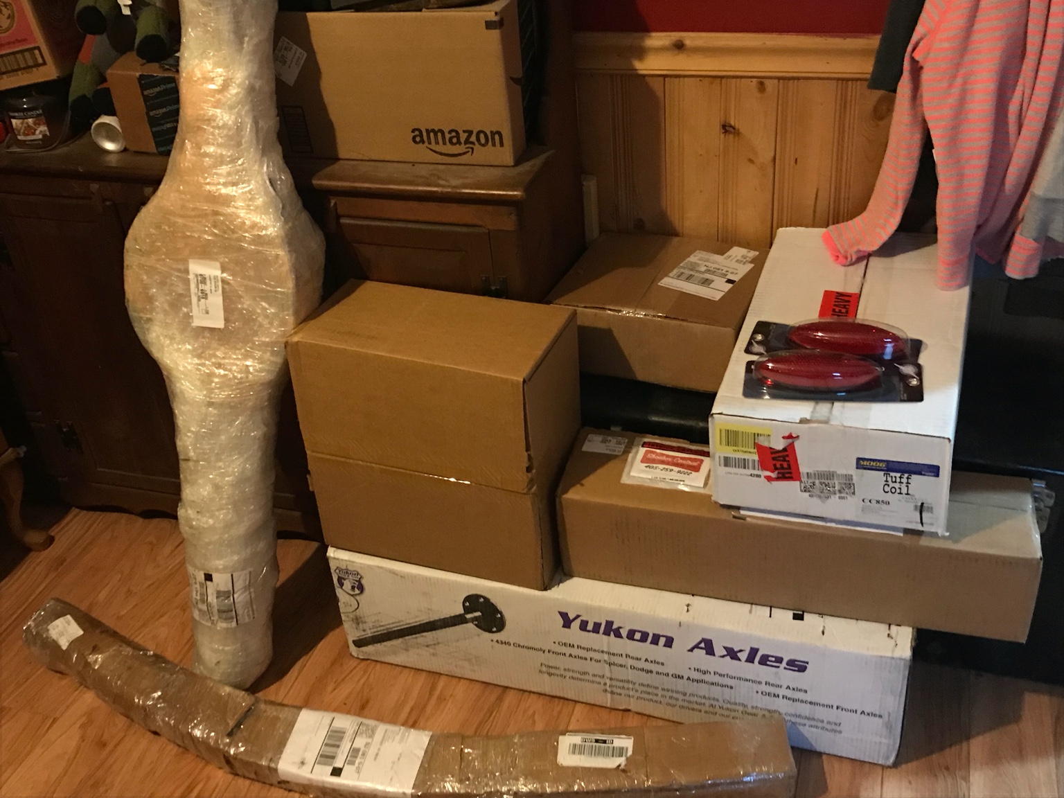

  19. Tony Ray
    Joined: Sep 8, 2007
    Posts: 1,111
    Tony Ray
    So for small update.. ordered the 9 inch rear, axles and kit, gasket,and the bolt kit for center section.. slowly gathering all the pieces for suspension. Going to take a long weekend this spring and go nuts. Still need brakes, front and back, front shocks, sway bars, the front steering upgrade kit, wiring kit and tires and wheels.. then it’ on to motor and trans and upholstery.
    brEad and RockinRivi like this.
  20. I like the way you make the list of 10 different things to do and buy sound like small potatoes and just nothing to it. That's a good outlook to have.
    The Wizzard

    Well normally I’d be fretting about it all, but I sat down and figured it out. Usually once a month I am on call at work, and usually end up with over 40 I’ve overtime. So each check like that I take half the OT and set it aside for car. I try to get what I can for 6-700 that was give me little extra space if I need. Before it used to be try to put it aside and something would come up. Now I make my list and when that check hits I know what I need to order and send it out that day. Keeps me motivated and stock piles the parts I am gonna need. I figured start at back , make my way forward and up. The only deviation I have done was I bought buckets seats because I had none and got a good deal on them. But gave my wife a more complete idea, and we k ow how important it is to make them happy!

    always good motivation to get some new boxes of parts in - I have always wondered why if I order the parts that by the next morning they are not already installed by car parts Leprechauns - have left out milk, beer even money - no luck - oh well why miss out on all the fun of doing it yourself
