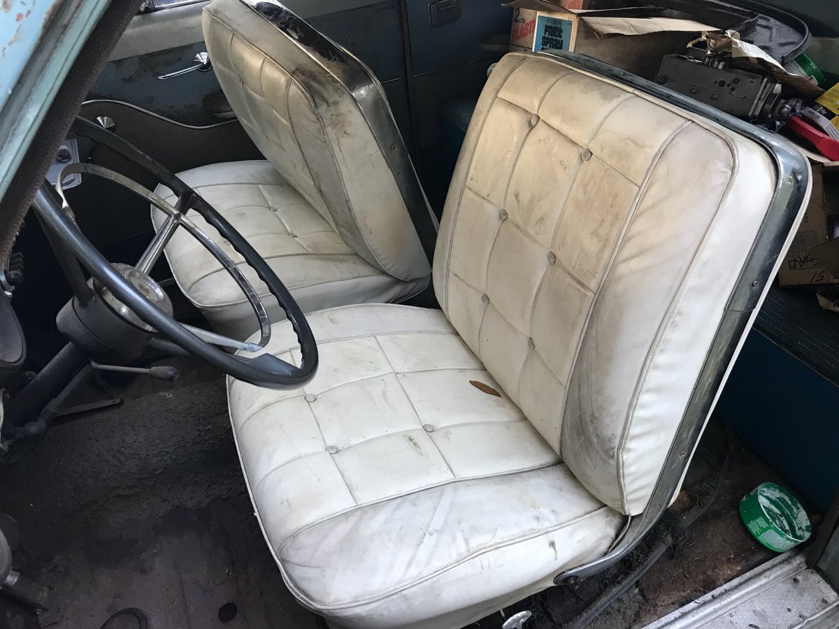

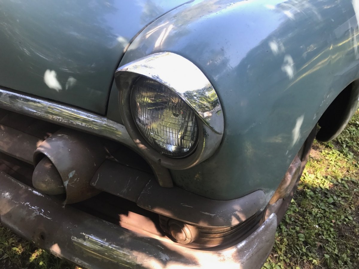

    they look like J.C.WHITNEY add ons to me.

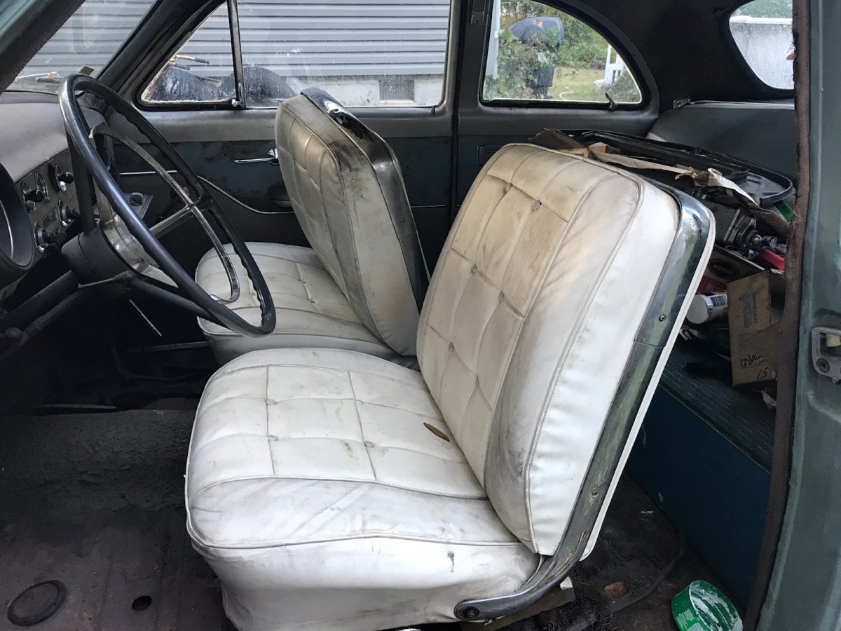

    what happened to the original seat? I wouldn't put these in, the original is the best seat for this car.

    Back In the 70s or so, the previous owners buddy had a 50 shoebox and his seat was all ripped up so he gave him the original bench seat out of the 51, since he planned to run buckets in it.

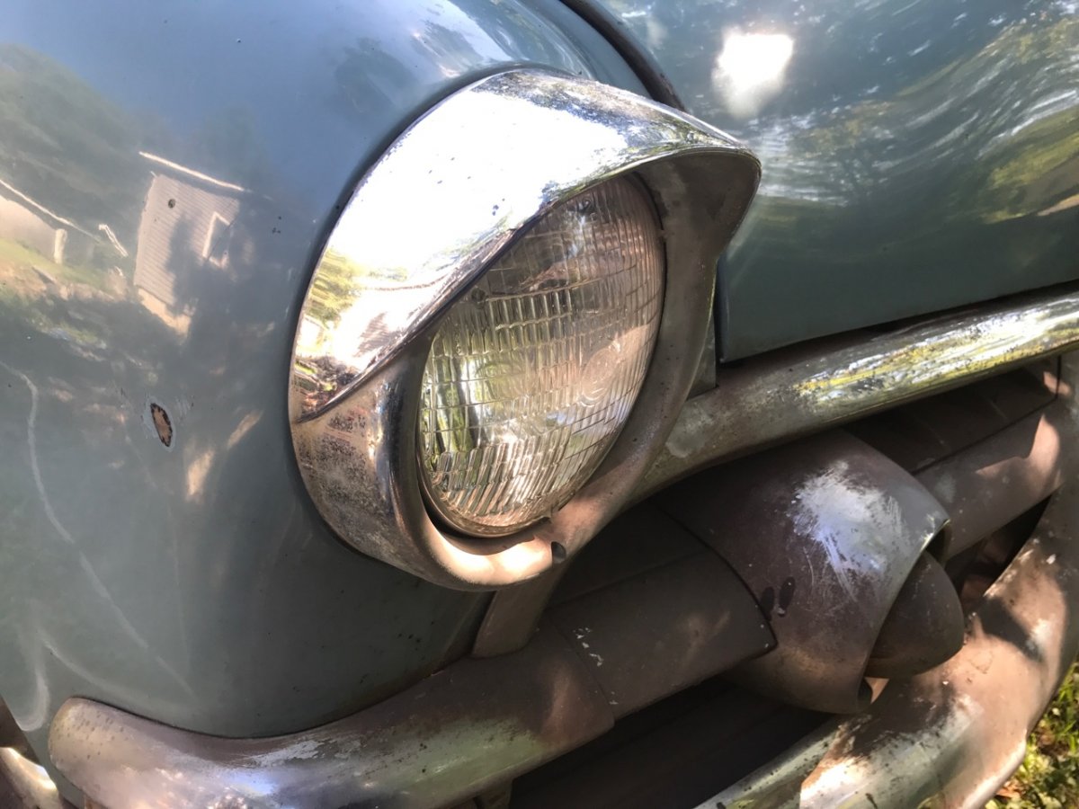

    oh and i need to get head light bezels so i can finally get rid of those hokey jc whitney ones.. is there a reason why i cant use 49-50 bezels? or a way to make them work?

  27. Yes you can use 49-50's on it.
