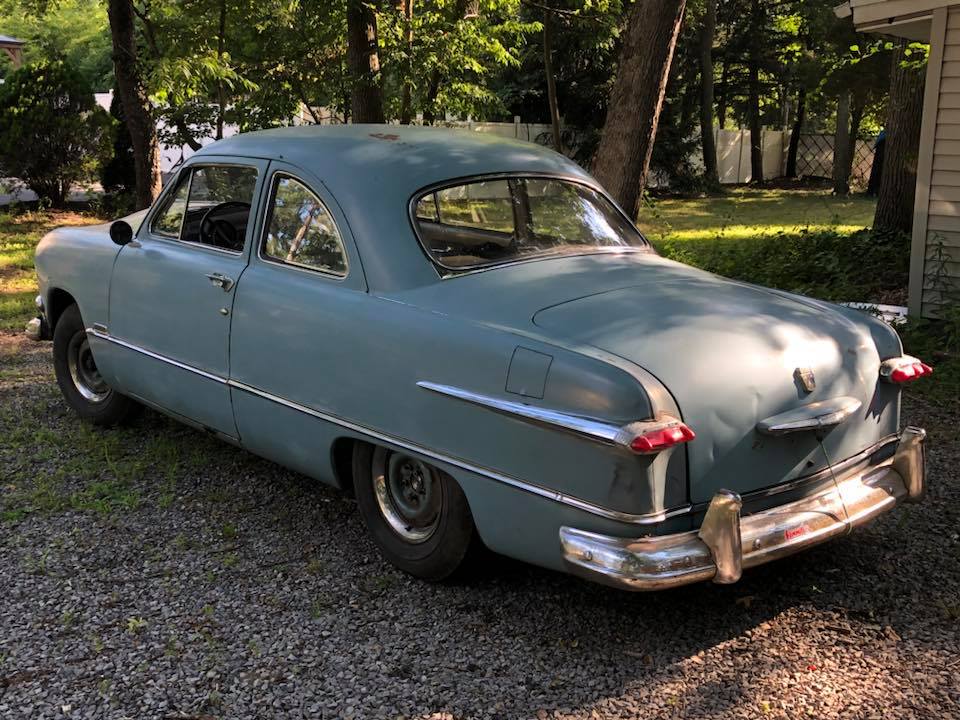

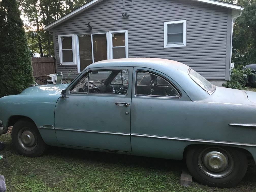

    I did go and looked at this little 50 coupe today. Not really the best idea I have ever had, It is something of a mess. Needs floors and rockers, body is really straight other than that though. Comes with a really good running Flathead V8 and ******, and the only gl*** in the car is the back. Price is right at less than a grand though, hell the Flathead is worth some part of that deal so I'm in. Only hope I have another car in me as I am an old guy, and I am finishing up a gl*** 34 Ford 3 window.
    This one will be a Hot Rod though not a custom. I have this idea in the back of my mind and this car will fulfill that idea. I have 4 early Chrysler Hemi's left over from my Model A, one of those goes into the Model A and it is built and ready to go. One of the others is going to go into this little shoebox along with a 4 speed I also have. So it will be a Hot Rod. Got a lot of homework to do first though as I have to learn about these cars. It is doable though just takes time I suppose...

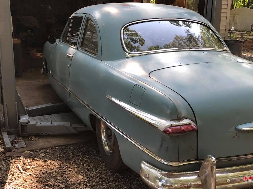

    Well it’s time to get started actually doing stuff.. unfortunately the axles wouldn’t fit in my buddy’s lathe , so plan B on the Bridgeport..
    chryslerfan55 and Wayne67vert like this.
  8. Tony Ray
    Joined: Sep 8, 2007
    Posts: 1,111
    Tony Ray

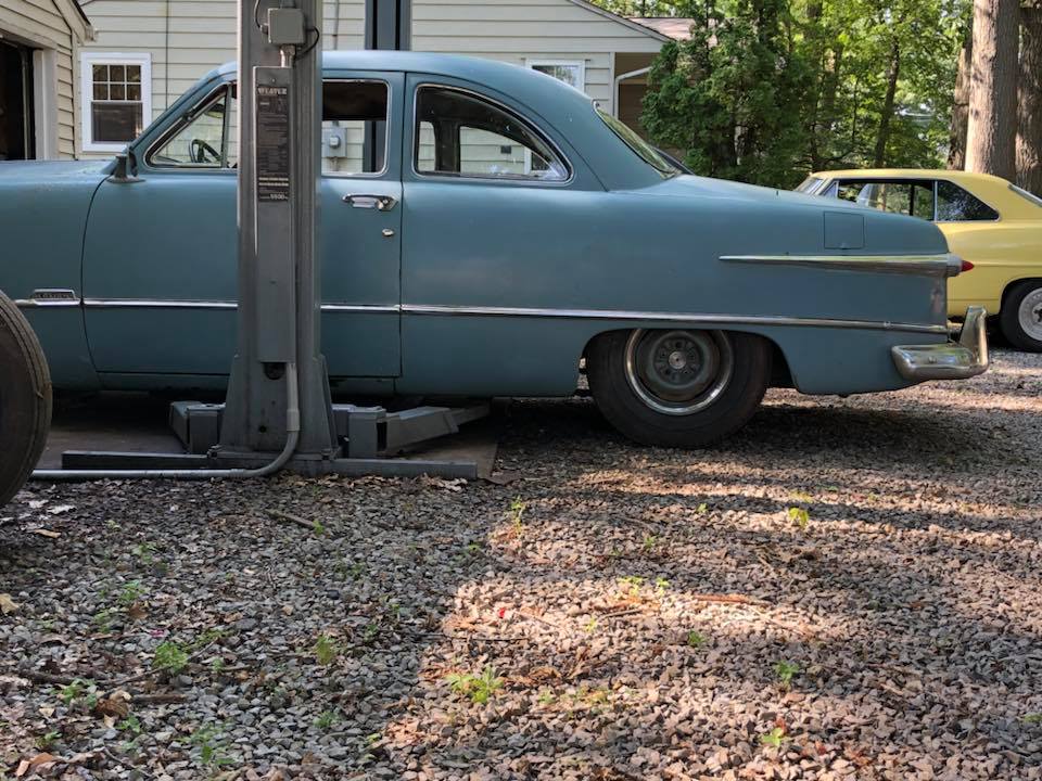

    well axles are all redrilled for stock bolt pattern and the hub cut down, so today i dragged it out from out back and gave it a good wash down.
    monday its getting taken to my buddys garage, where we will start ripping out the rear suspension then putting the 9" rear housing ,lowering springs, blocks shocks and new drum brake set up in it.then get the Rocker panels and the few small holes on drivers floor patched. then its the Aerostar front coils, shocks,steering upgrade kit, and the disk brake upgrade and the power brake booster set up for the fire wall. hopefully in a coupe of weeks it will have a nice new stance and i can drop the motor and trans in and get it running.
