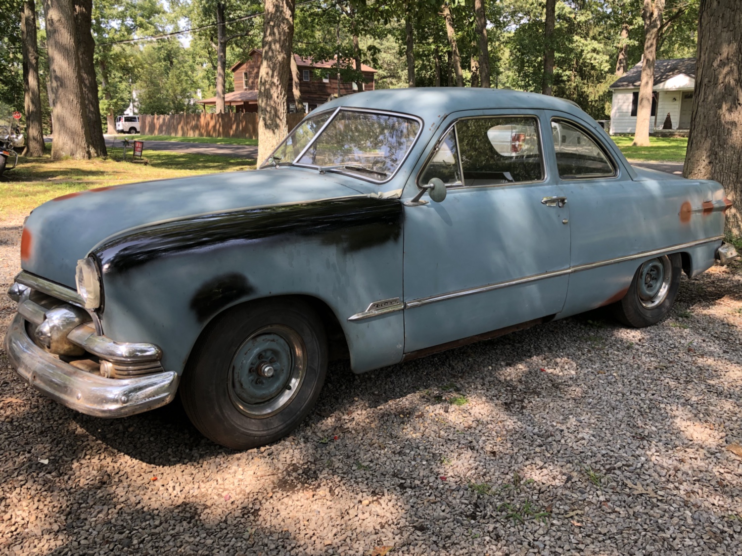

    Here are some pics. Got the flathead running but it has a dead cylinder.Looks like its a SBC. And yes I would use Ford motor if I had a good one. 2018-07-21%20001.JPG 2018-07-21%20002.JPG 2018-07-21%20003.JPG 2018-07-21%20001.JPG 2018-07-21%20002.JPG 2018-07-21%20003.JPG

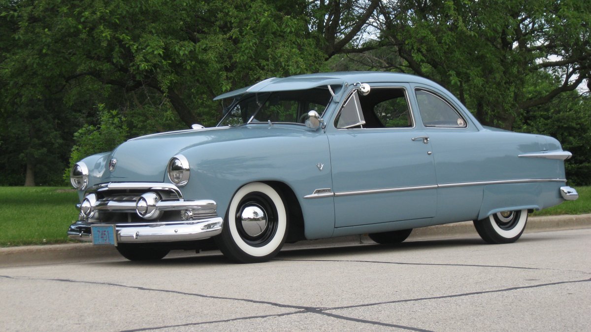

  3. For you Guys that are getting all Stressed about what's under your hood I say just relax. I ***ume some of you following this thread kind of like the appearance of my Daily Driver Vicky and thank you. Here's a couple more shots of it from different angles. Can any of you tell what's making the Rear Tires turn? If you could, would it change your opinion of the Car?
    The Wizzard

  7. Hay Pipes; It started life as a 55 Pontiac unit. It's been seriously re worked. I narrowed it, extended the ends down and re shaped them to match the 49 Bumper profile. Then I re profiled the back edge to work with the Deck Lid.

  9. Thanks Mo, I think the Kids help distract you from the imperfections. Those photos are 15 years Old now.
    The Wizzard

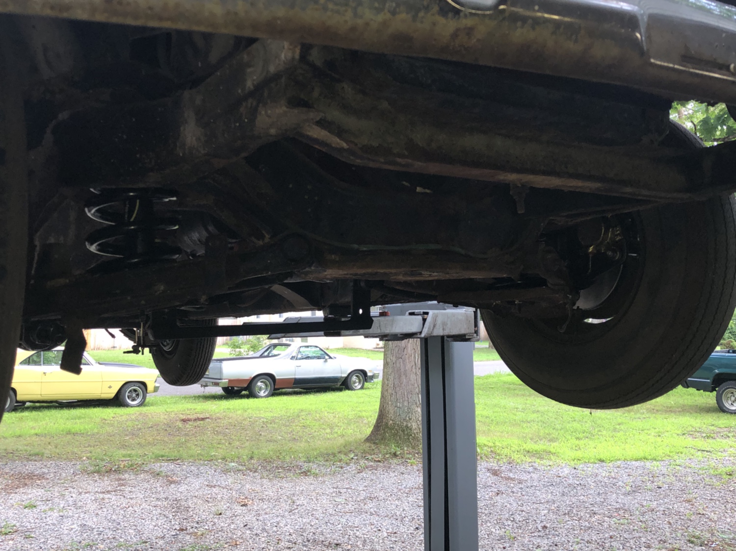

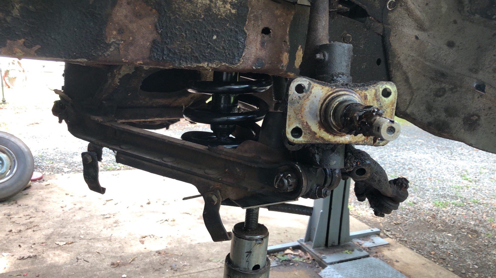

    Got some progress done today..
    [​IMG][​IMG][​IMG][​IMG][​IMG][​IMG]
    After the new Aerostar coils and shocks were on, I put the Shoebox Central disc brake conversation on . Everything fit nice and went together. Went back to the rear and took off the 2 inch block and slipped in the 1 inch aluminum blocks my buddy made up for me. With the 1 inch blocks and the 3 inch lowering springs I was able to slip the tire in the wheel well opening with out deflating the tire.. we officially have a winner. Here is s quick pick of the Aerostar springs and new shocks and the 1 inch blocks on the rear.
    Tomorrow back at it. Going to put the power brake booster and master cylinder on the firewall and when the copper brake lines come on Tuesday from Jegs we will run all new lines for it.. this damn car is going together faster then I ever would have thought. Nothing has even fought us. I think the biggest casualty I have had was a couple broken cotter pin..

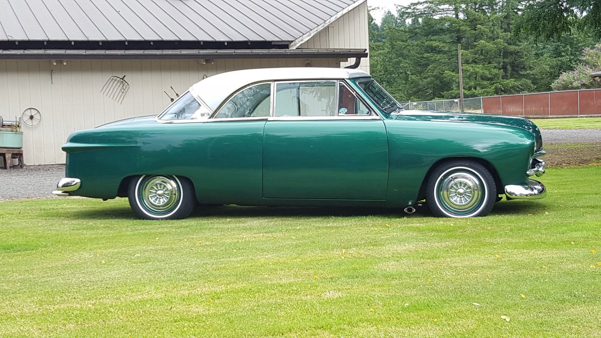

  14. Nifty One
    Joined: Jul 2, 2018
    Posts: 34
    Nifty One
    Lookin good Pipes, moving right along and stance looks good. I've got the same springs with dropped uprights, 3" rear springs yet to be installed. IMG_3776.jpg
  15. Tony Ray
    Joined: Sep 8, 2007
    Posts: 1,111
    Tony Ray
    amazing that your car is what mine would liked like restored. Looks great!!

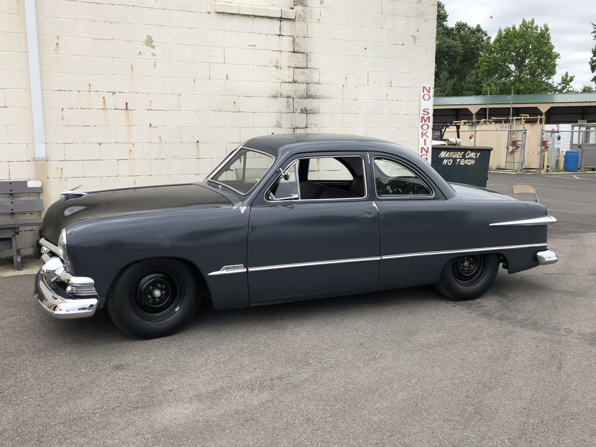

  18. Tony Ray
    Joined: Sep 8, 2007
    Posts: 1,111
    Tony Ray
    52BE2D54-0DFD-4E31-AF02-5810B10B90BB.jpeg Got it off the lift and sitting on its wheels..

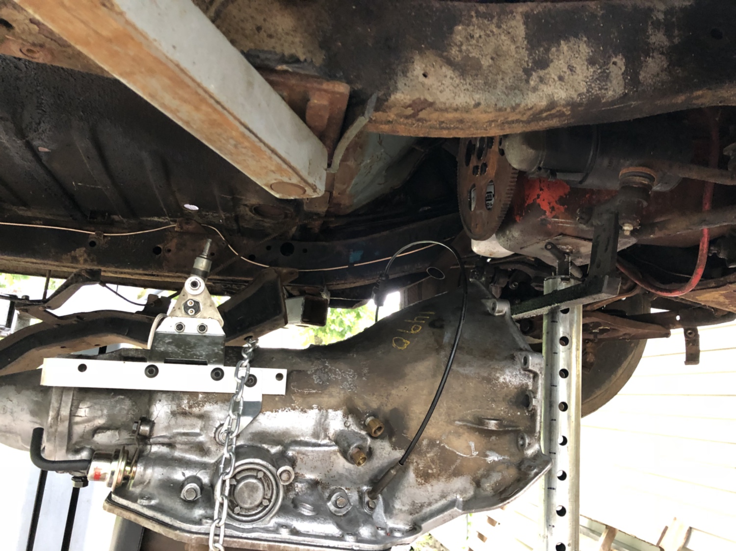

    Long day!!!Got the transmission in and the Gennie shifter tonight. Had time since it was still light out so put on the new sway bar. Tomorrow I m installing the rear sway bar and hopefully the radiator. Trying to get as much done as possible. My Buddy that’s letting me use his lift and garage plans to load up the last of his stuff in 3 weeks and haul *** to Tennessee. After that it’s back to working in the driveway at my house. Hopefully I’ll be able to drive it home instead of trailering it. Couple of pics from tonight..

    The list so far..
    1. Install trans and cut hole for shifter. DONE!
    2 weld up holes in firewall and install brake booster and master cylinder.
    3. Finish making front brake lines and hook up proportions valve.
    4. Install new fan and new radiator. DONE!!
    5. Make transmission lines. DONE!!
    6. Get rear lined up and figure out the proper degree it needs to be. Then weld perches permanately. DONE!!
    7. Measure for driveshaft and get that cut down and balanced. ORDERED!!
    8. Install front and rear sway bars. DONE!!
    9. Install new distributor and alternator.
    10.figure out what I’m going to do as far as oil pan/ steering upgrade kit.
    11. Get the rockers patched up. STARTED!!
    Some new additions
    12. Clean out gas tank and re-install.
    13. Install electric fuel pump
    14. mount transmission cross member
    just came home for some lunch and some boxes to sort out all the stuff in the trunk of car. going back hoping to knockout the gastank and see what else i can start..

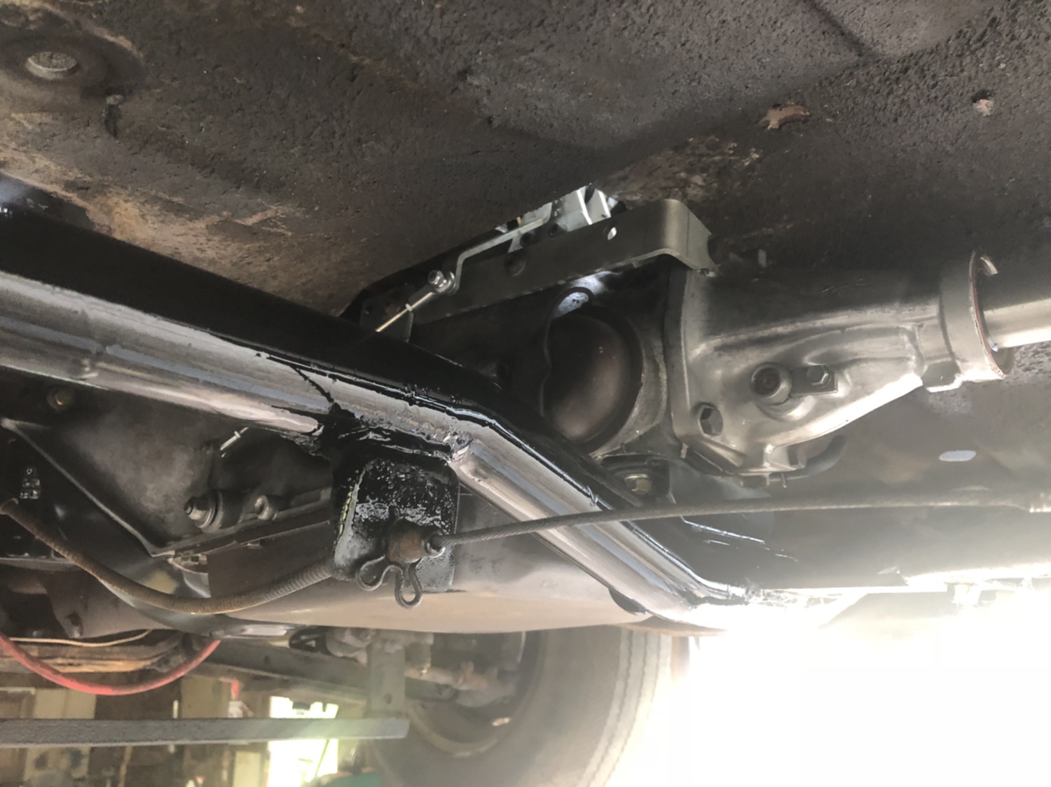

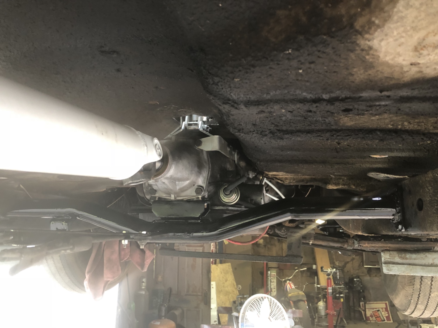

  30. Tony Ray
    Joined: Sep 8, 2007
    Posts: 1,111
    Tony Ray
    Got the rest of the brake lines ran, had a hell of a time with the flaring tool. For some reason it was pushing it over more to one side , so had to get an old one and that seemed to work. Still having an issue with one of the lines leaking at the proportioning valve but other then that brake lines need a final bleeding. Drive shaft is in. Really happy with Southwest Speed. I called a local place and they wanted 180 to shorten and balance a driveshaft, another 70 for a new yoke. Mines pretty crusty. With the power glide housing in the car the driveshaft the previous owner gave me ,was to long. With the turbo 350 it was too short. I called back to the local shop and it was over 400.00 to make one. I stumbled across Southwest Speed on Amazon then went to their website. They had every driveshaft with in half inch increments . It cost me 229.00 with shipping, for a new precision balanced driveshaft and yoke and Ujoints. It feels just as sturdy if not more then the old driveshaft and well built . Definitely worth looking into if anyone needs one.
    After that we got my Speedway transmission crossmember cut down and welded in place. Then took the emergency brake brackets and welded them to crossmember. Fits real nice. And only cost 50 bucks compared to Jamco’s. Hooked up new dipstick tube, ran the trans lines, the speedo cable, and bunch of other stuff I forgot. All that’s left is bleed brakes, hook up gas tank and fuel pump, run a line to the modular on the trans. I’m waiting on a friend about an aluminum intake with oil fill before I put the new distributor on. After that I’m taking the damn thing for a test drive. Can’t wait.
    On a side note, I didn’t install the upgraded steering kit from Shoebox Central yet. We are actually looking into modifying the centerlink so it works with the rear sump pan. Got an idea that I think will work.
