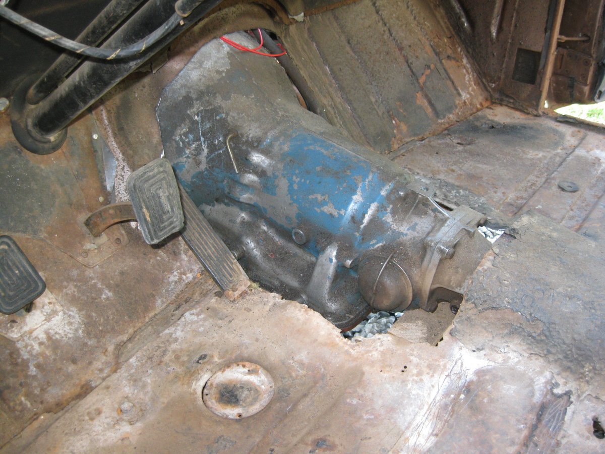

    Hey Pipes,looks like your making great progress . You were talking about those eye bolts in the floor ,mine also has them. I think they may have been dealer installed for seat belts. Mine had belts attached and the eyes were crudely installed. (not in a straight line). Also,I took a different approach to the center steering link problem. I mounted the engine higher and more forward to clear the link. My firewall hump had already been butchered and I don't like playing around with steering geometry,it scares me. I have pics but I don't want to hijack your post. Anyway,keep up the good work !

    IMG_2447.JPG IMG_2448.JPG IMG_2450.JPG IMG_2449.JPG A few pics of my 51. Its hard to see the pic of the oil pan but the center link is about an inch below the flex plate. I am putting the rad in front of the rad support otherwise I would have to use a short pump and electric fan.The eyes still have carpet fabric under them . I removed the old belts when I cleaned out the old carpet etc. Im sure they were installed after the car was built.

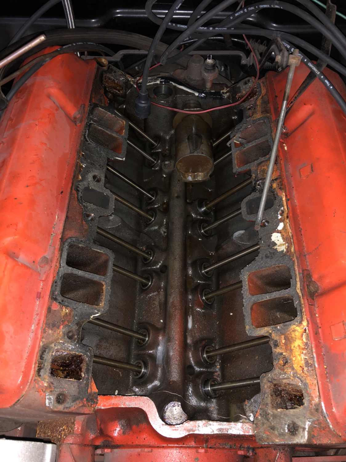

    Got alittle work done.. removed the 2 bbl intake and carb, a friend blasted then primed the 4 bbl intake and the 600 Edelbrock carb is all rebuilt ready to go. Took a few pictures of the valley. Definitely believe it about the 6000 miles on it..

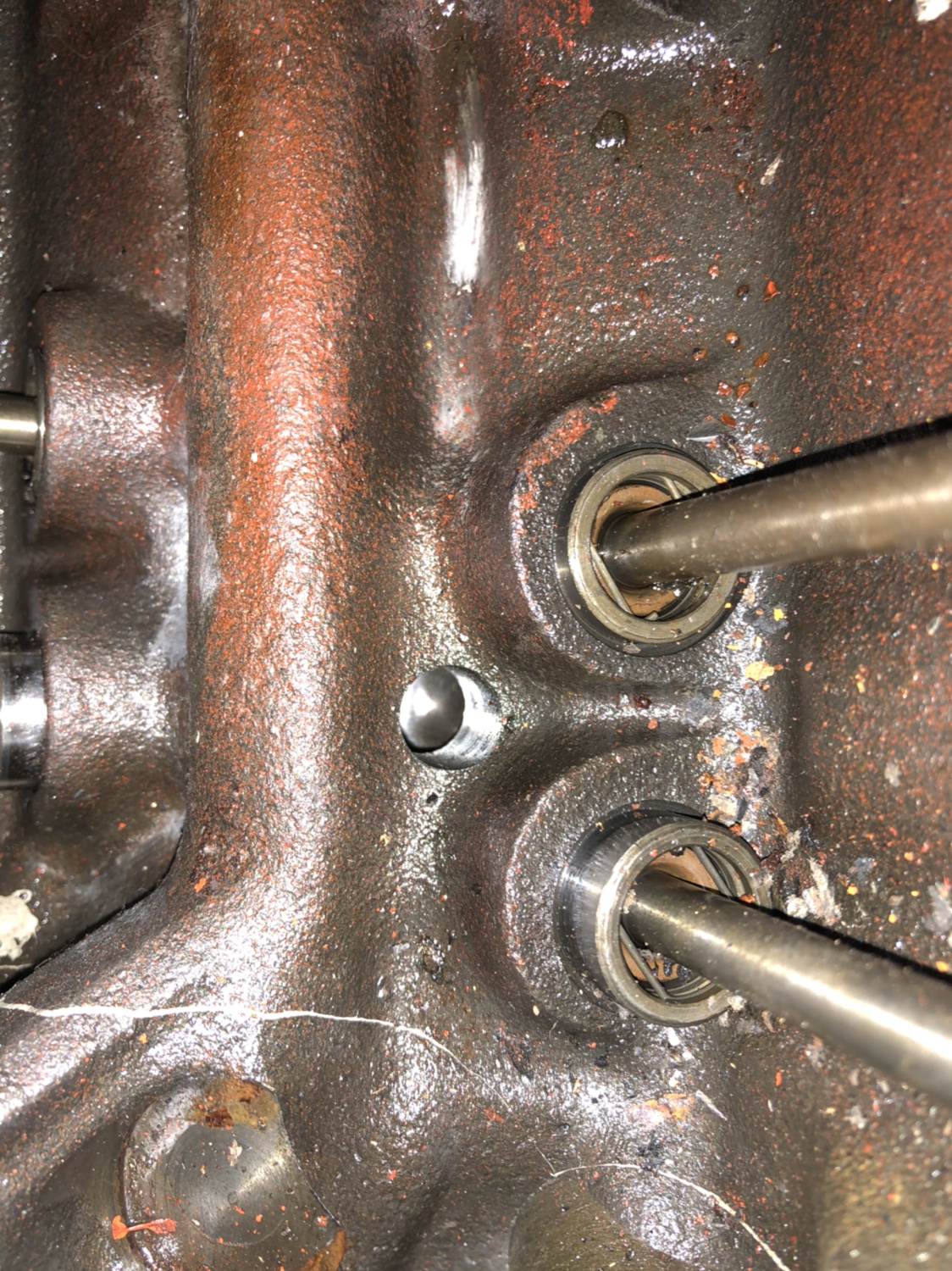

    So when I spoke to the previous owner he said that the stock head s didn’t have the hole for the alternator bracket and he found a later set that he got rebuilt instead so it would be better then the stock ones on it.. today I took off the valve covers and I was pretty damn pleased..
