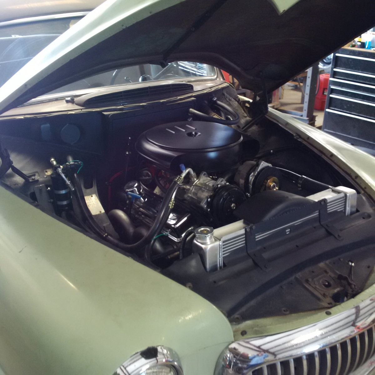

    Cool looking car! Not sure I would have run the battery cables with the fuel line though.
  2. mzweig
    Joined: Feb 8, 2014
    Posts: 84
    mzweig
    Bought them from a supplier in Seattle. Better cooling

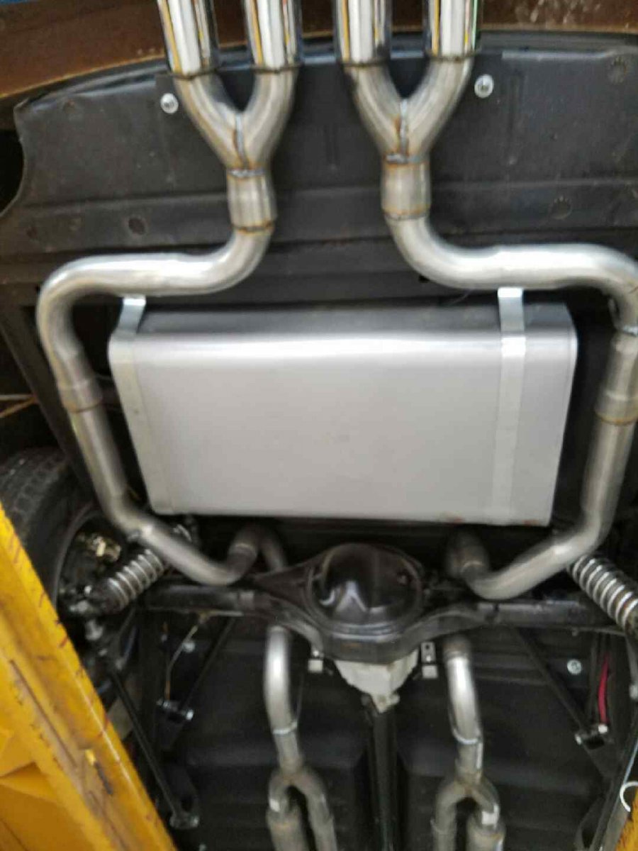

    Underside of the Nash. Exhaust goes on Monday.

    These pics show the exhaust system under construction and completed. It has electric cutouts that byp*** the gl***packs and run all the way out the back.

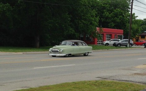

    Cars and Coffee in Springdale, AR, this morning..
  24. arkiehotrods
    Joined: Mar 9, 2006
    Posts: 6,802
    arkiehotrods
    I have seen Mark's Nash several times and if the hood is down, the only clues that it isn't stock is the lowered stance and the four exhaust tips out back. Looks old, drives new, way cool!
