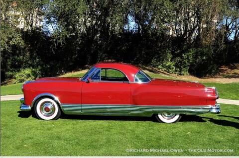

  1. You could always go the Macauley route :D-
