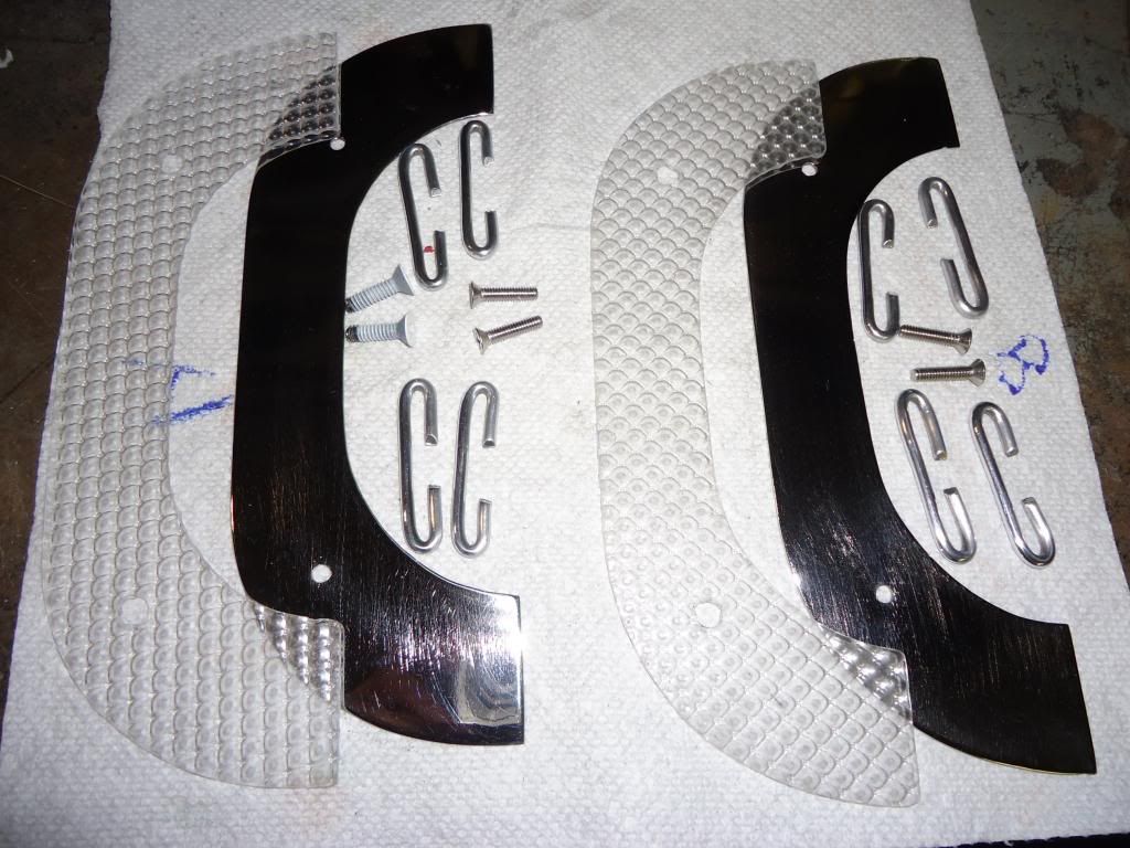

    Back tracking just a little to the sunvisors, The mounting flanges ended up being aluminum so of course I had to polish them.
    then the next parts that I pulled from the "to do box" where the arm rests. I decided because Im doing a white interior I didnt want to upohlster them since they would always be dirty. Heres what I came up w/ even though Im not totally sold on them yet.
    First step was to strip them down and spray the white. When its 20deg. in the shop your forced to find ways to cure the paint :)
    Next step, polished stainless inlay, flouresent light diffuser lense, and some aluminum wire bent up to trim the ends..
    And wrap them up because theyre done.
