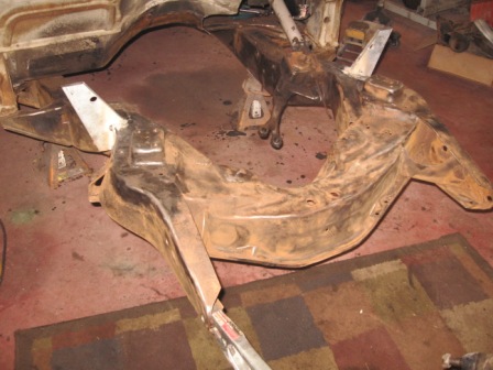

    I spent half a day at the boneyard gathering some misc pieces yesterday so I didnt get as far as I hoped this weekend. I did get a few more things bolted on the engine, cut a set of shock mounts and welded them on the frame, painted the front of the frame with some POR-15, and got the suspention back on after cutting one coil off the springs. I need to work some OT this week but im hoping to get the engine and trans bolted together at some point and start mocking up the drivetrain to build mounts.

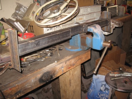

    I rooted through my s**** barrel today to find something to build a crossmember and came up with some 2" and 3" angle iron. I cut a 6' piece of 2" in half and welded the two halves together to make a box, notched out for the trans mount, then cut some 3" pices for the ends. After much t******* and trial fitting it looks pretty good and should have enough room for the exhaust to p*** under.
