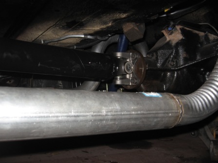

    Well, I was really hoping for a test cruise this weekend but it looks like my slave cylinder for the clutch is bad. I've got a new one on the way; in the meantime I finished up the exhaust and got the driveshaft installed. It sounds really good; so close to driving!

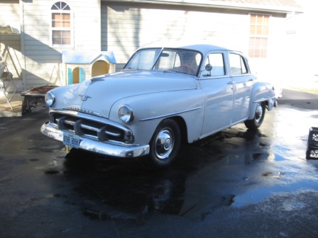

    After several trips down the road im really happy with how this thing came out. I gave her a good bath and except for a few tweaks here and there this is how she's going to stay for the forseeable future. Im not going to worry about uphostery for now; might takle that a bit at a time later. I think I am going to run a buffer across it and see if I can bring the paint alive a little more. I'm going to try a Corvette manual disc/disc master cylinder. Brakes are ok but no matter how much I bleed them they are still spongy and you've got to pump them. The master cylinder I have on there is from a four wheel drum setup; I just used it because I had it laying around. Also my front shocks are bottoming so I ordered some shorter ones but other than that I'm diggin it and ready to rack up some miles. It sounds great and I was suprised by how much pep the old 318 has.

    What agreat budget build. You did a great job! I hope you put on a boat load of miles on it and enjoy it fully

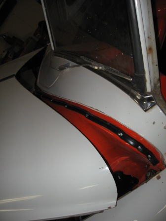

    I got my heater in this weekend and it works great. I used the controls from the 49 and a generic OReilys heater valve. I also got the cowl seal on (without it the back of the hood was rattling) and my friend Kyle was kind enough to buff the whole car for me. The old paint came out looking pretty decent.
