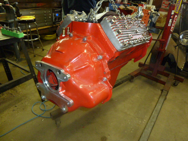

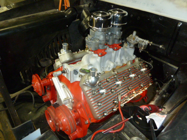

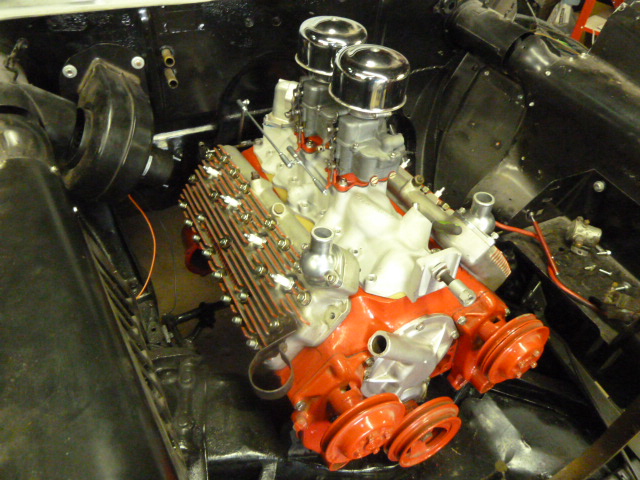

    We were finally able to make some real progress on the car today. Huge thanks to Carl for all the hard work on the engine.

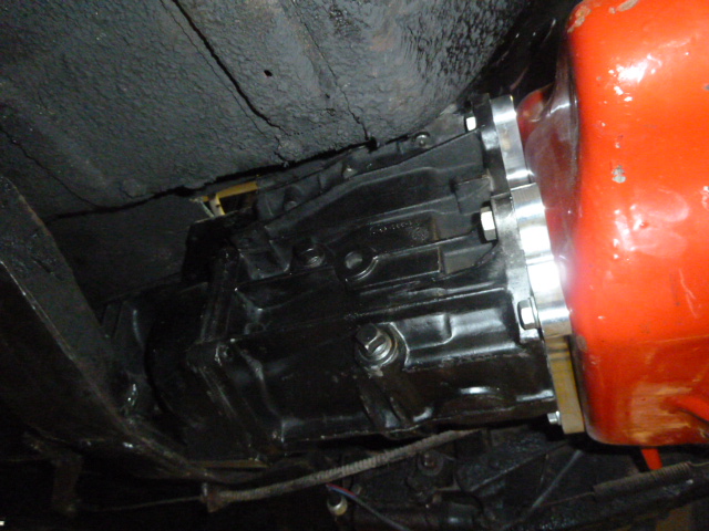

    Starting to put the flathead back together for the last time. All modifications have been made for the T5 ******. Drive shaft is cut, ****** crossmember is notched, everything fits great.
    Here she is back in the car. Carbs are now rebuilt, linkages are all made and installed. The full flow oil conversion is in. Slow and steady, its taking shape.
    This is just a cool picture
    Here are a couple shots showing the T5 and how it all came together.

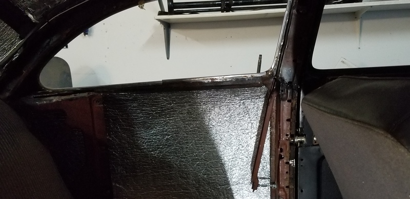

    I wanted the rear windows to roll down. That ended up being a little more work than I anticipated. I had to slant the window channels but everything works great now. I added a spring to the regulator to keep it tight to the pillars.

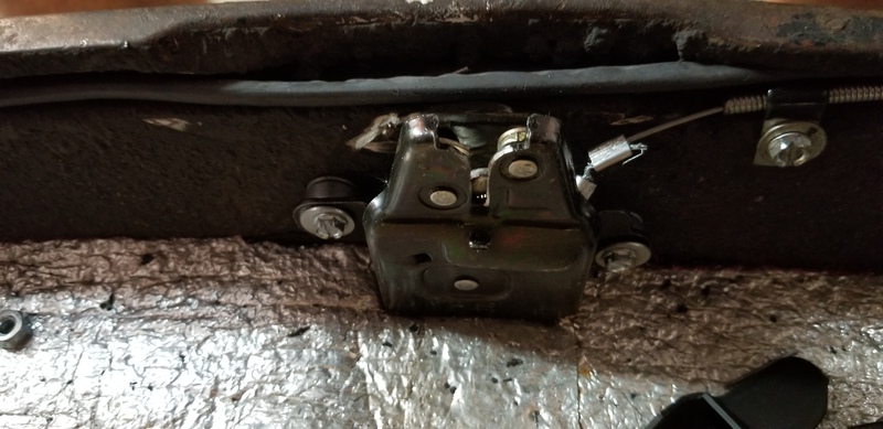

    I changed my trunk latch setup so that the cable is not on the deck lid. I used something from the local junkyard out of a toyota. I ran the cable into my fuel filler door.

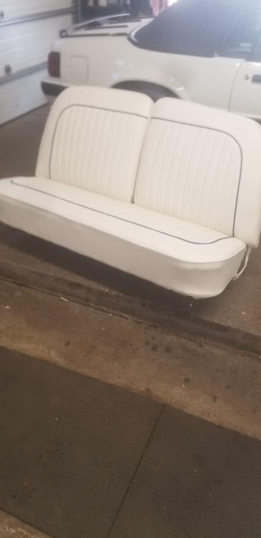

    New grill!
    Teaser shot of seats. The pictures dont do them justice. Bright white with blue piping around the pleats.

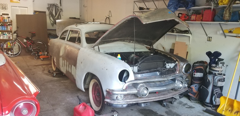

    She finally went to paint. Hopefully I'll have some real progress pictures to show later this fall / early winter and get her put back together for next summer.
