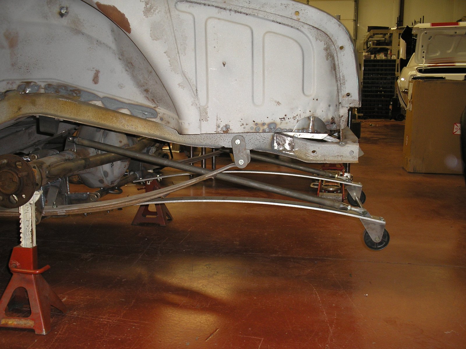

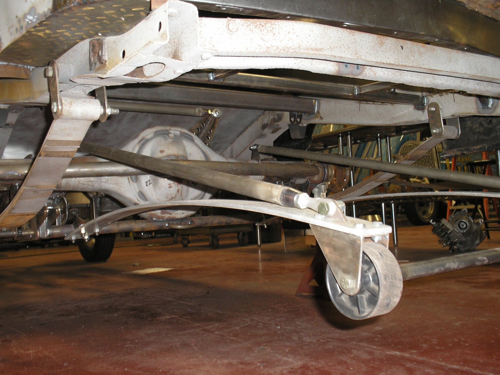

    Jeff one detail make sure your mounting point for the top bar is about 1" in front of the centerline of the wheel. If not it will bend the aluminum plate up right in front of the wheel, if you get it to far forward it will bend the plate down right in front of the wheel. I wish I could draw on a pic on here this would make more since. Call me if you need too.

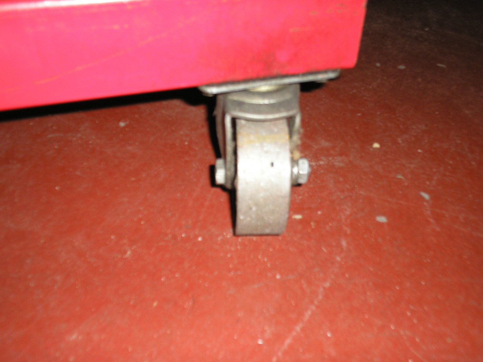

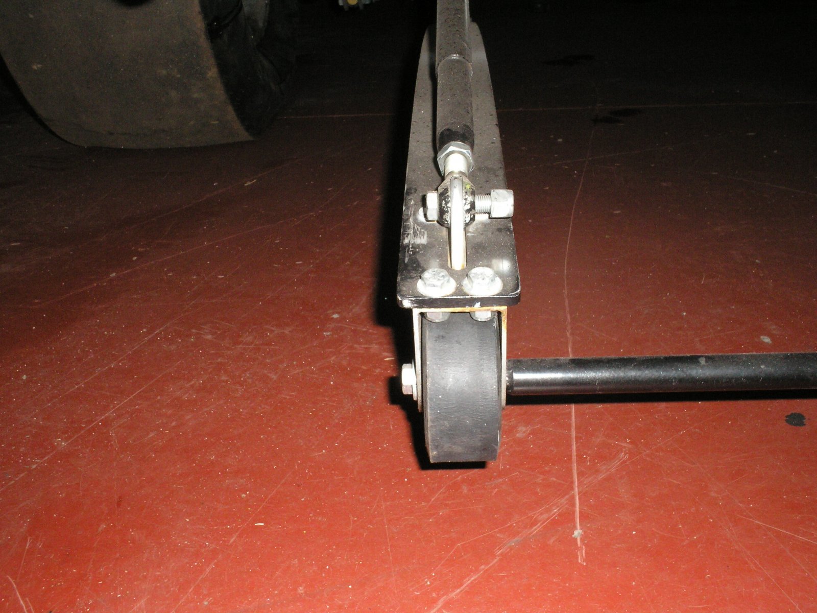

    Tony I'm struggling to find the right wheels. They need to be a max diameter of 3 1/2". 3 " to 3 1/4" is best for the old school look. They need to be small or real big. Anything bigger than 3 1/2" starts to get the modern look even if it's made right. I bought a box of used wheels about a year ago but had to turn them down to the right size, I'm now out of them. Don't use colored wheels that would ruin any effort at making them look old school. Remember the wrong style wheelie bar will kill the looks of an old school g***er about as bad as a set of weld wheels.

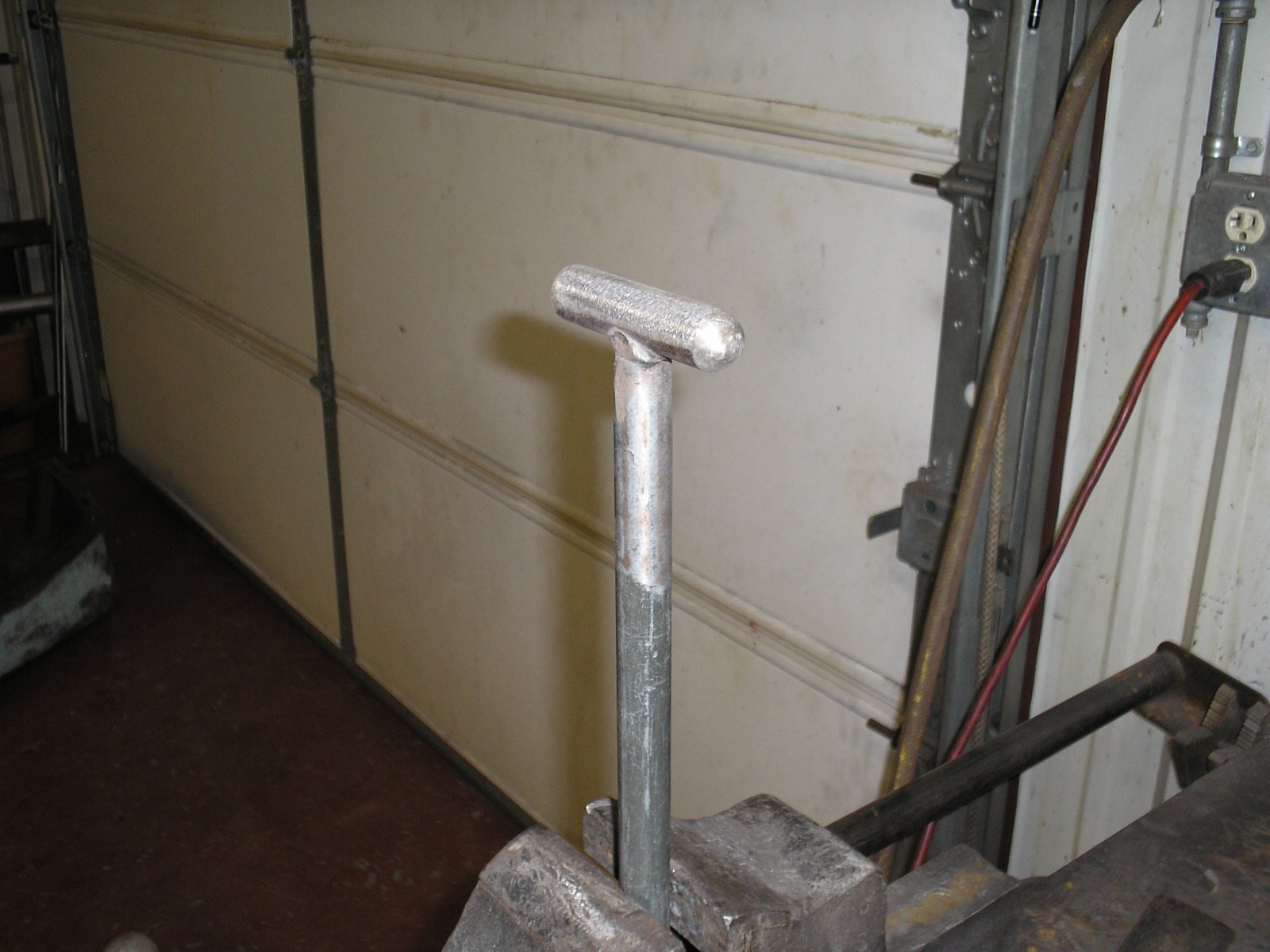

    It don't say if they have bearings or not, but might get by with out them. Just by looking at the pic they look OK. They look rounded off instead of flat like an old caster. Here's a couple of pic's, the first is an old caster on my engine stand, the second is a 3 1/2 wheel that I turned down to 3 1/4 to give it that flat look. But nobody say's that all casters were flat back then so they will be fine. studebaker 010.JPG studebaker 009.JPG

    I had the frame mounted bars on my willys when i first built it and there was a problem with unloading the suspension so I changed to the ones like I making for this build. My car is only 101" wheelbase so I decided to try them again on the Pale Rider 55 that I built a few years ago since it was 115" wheelbase same problem so we had to change it.
    We have these mounted on the car now so I'll post some pics of the finished bars for you in just a day or two when I get a chance.

    fast30coupe, Here's some pics with them mounted on the car. be sure to keep the top bar mounting point about 1" ahead of the wheel center line or the aluminum plate will bend. studebaker 010.JPG studebaker 011.JPG

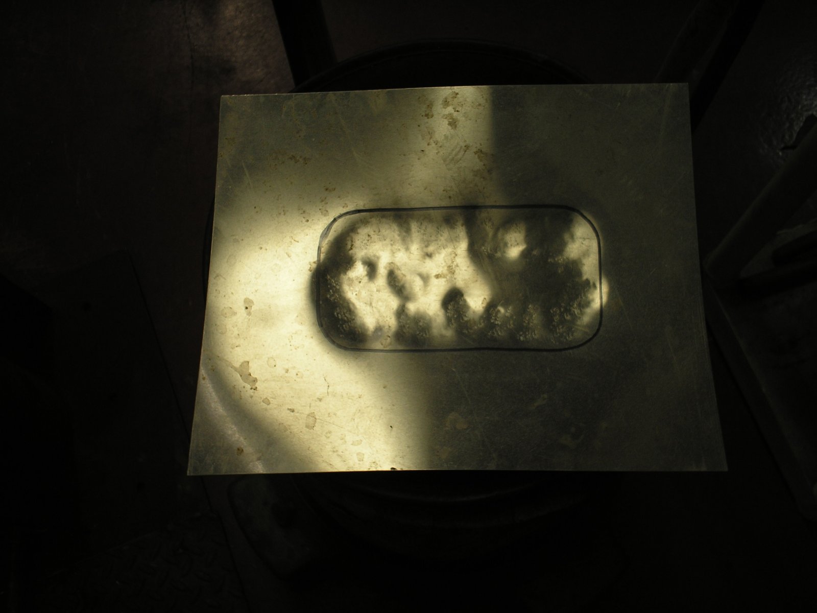

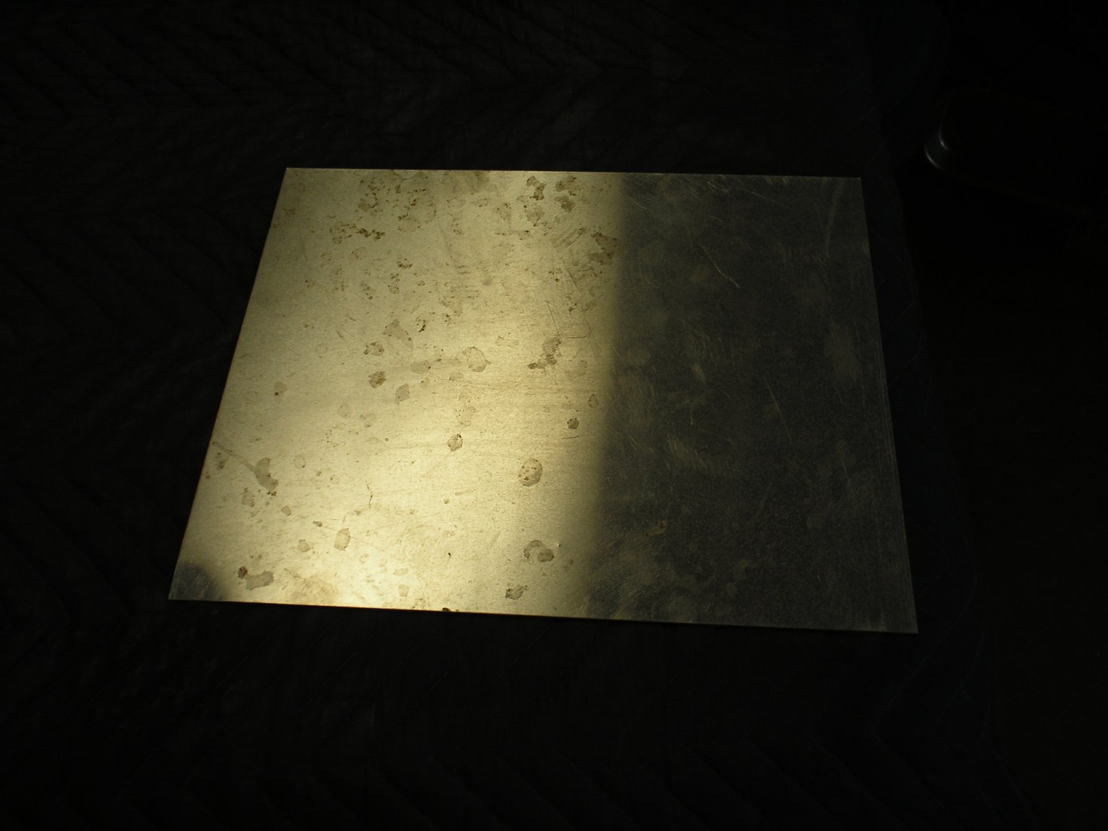

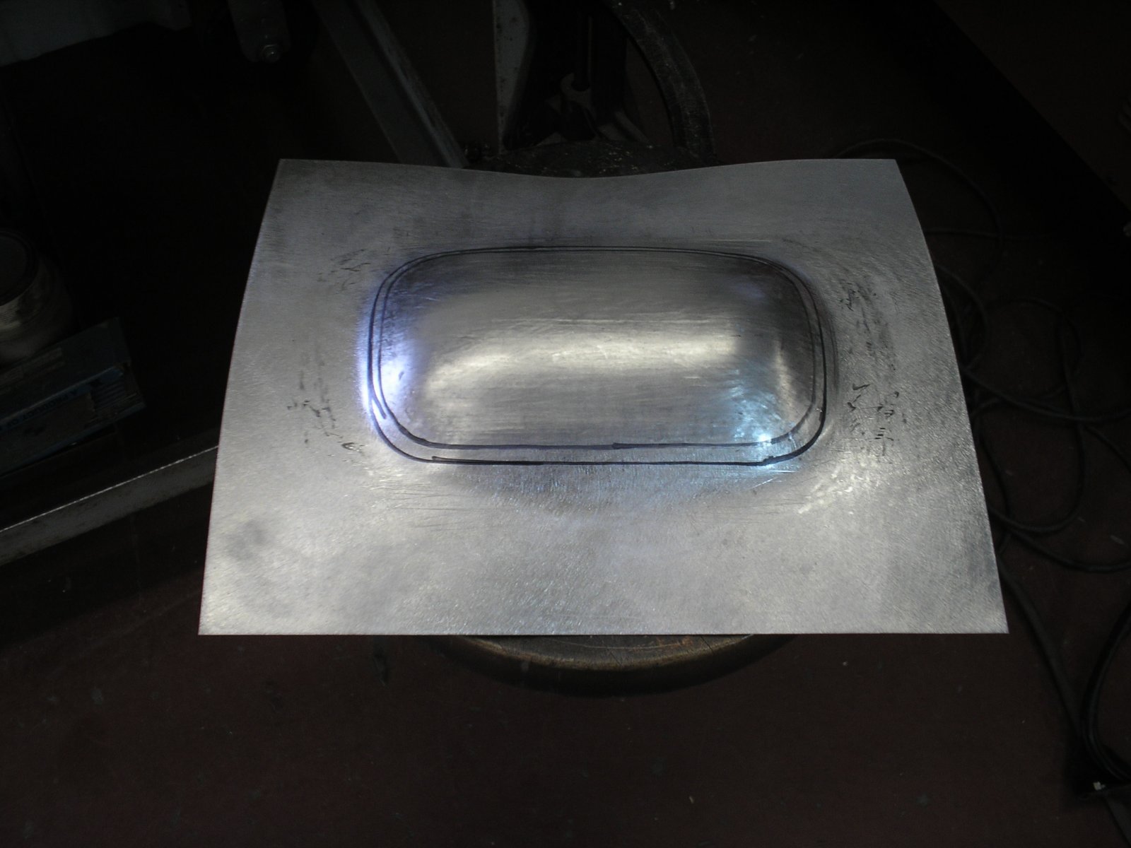

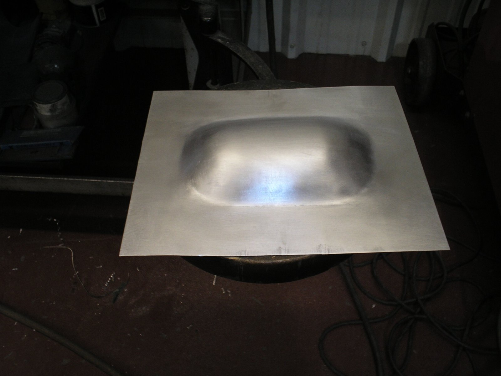

    A plastic master looks bad out of place on any old school g***er so I always make my signature hand hammered master cylinder cover to hid them. Some don't believe they are hammered out so I'm going to do step by step pics. I start with .040 3003 aluminum unless it has to have a bunch of shape then I use .050. this small shape is going to be .040. Sorry about the pic being dark I didn't know it until I downloaded them, studebaker 001.JPG to late to take any more.
    AHotRod likes this.

    Then a pattern of the size I need, then mark it on the aluminum. studebaker 002.JPG studebaker 003.JPG
    AHotRod likes this.

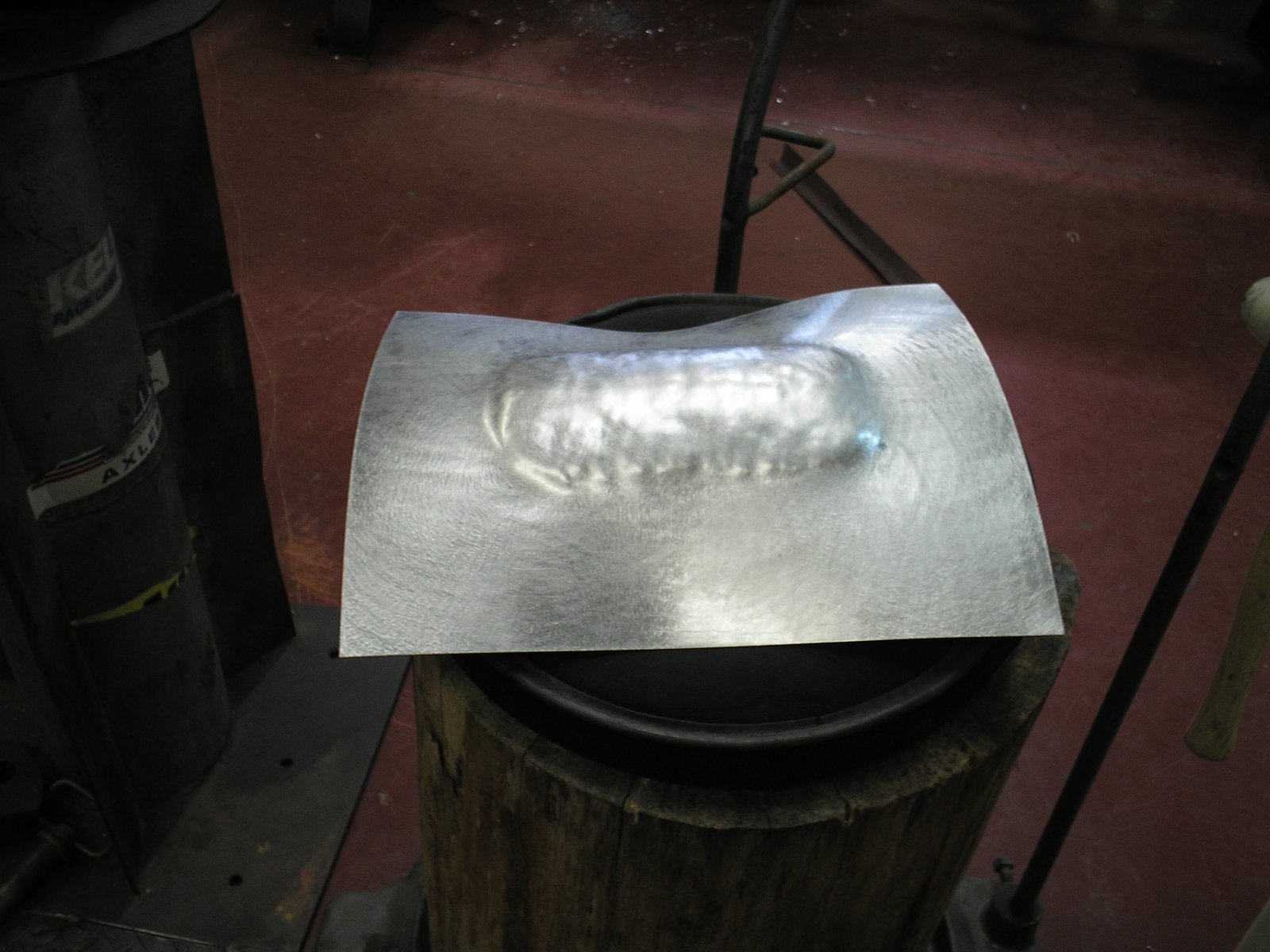

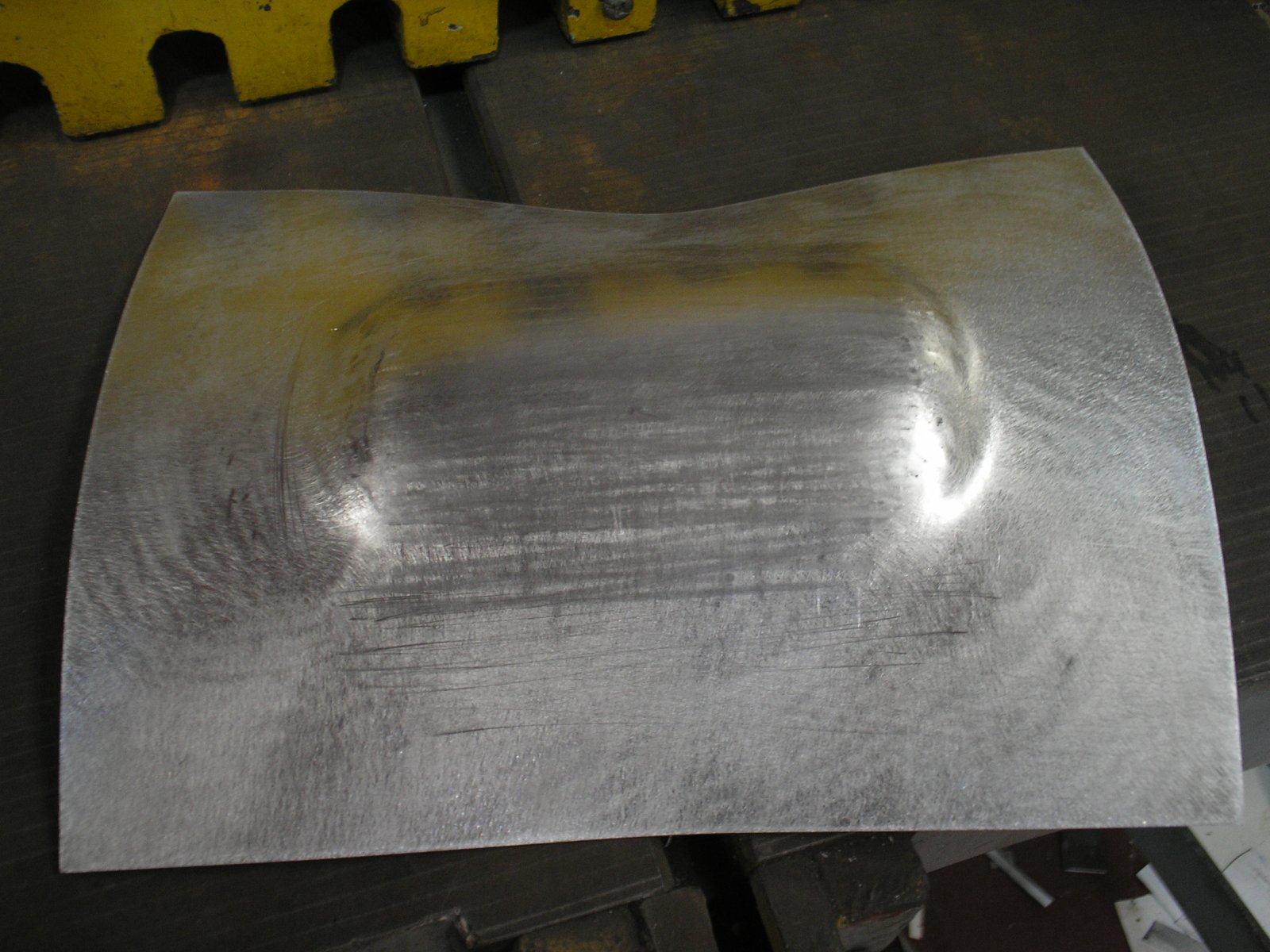

    Then start hammering. I use a shot bad underneath, if you don't have a shot bag a pile of sand will work just fine. I don't anneal the aluminum like some do unless it has to have a lot of working because it won't hold up good in the future. studebaker 004.JPG studebaker 005.JPG studebaker 006.JPG studebaker 007.JPG studebaker 008.JPG

    The next tools I will use are home made dollies. You old timers might recognize the one as and old shoe maker's shoe repair stand. It works good for a lot of things I do around here studebaker 011.JPG studebaker 003.JPG .

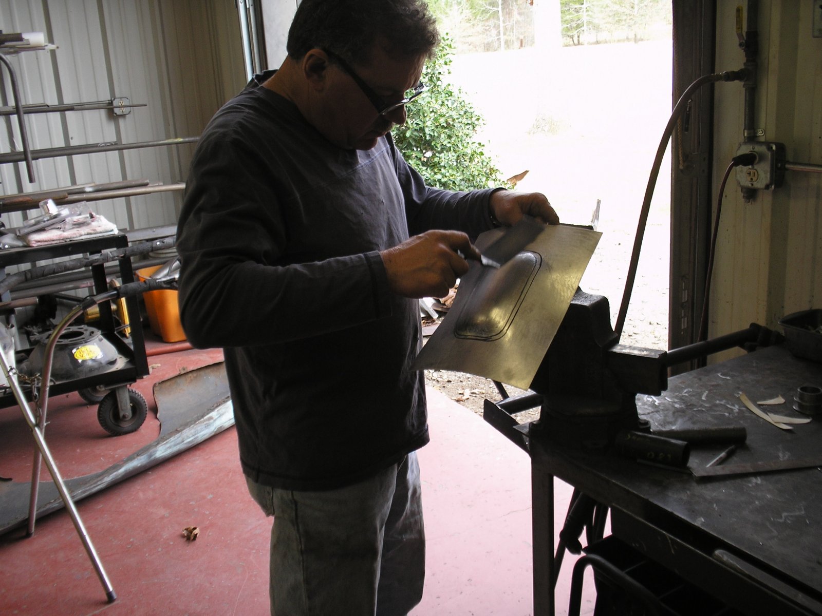

    The other tool is and old sheet metal *******, can't use a hammer any more because I'm trying to get rid of the hammer marks. studebaker 012.JPG
    AHotRod likes this.

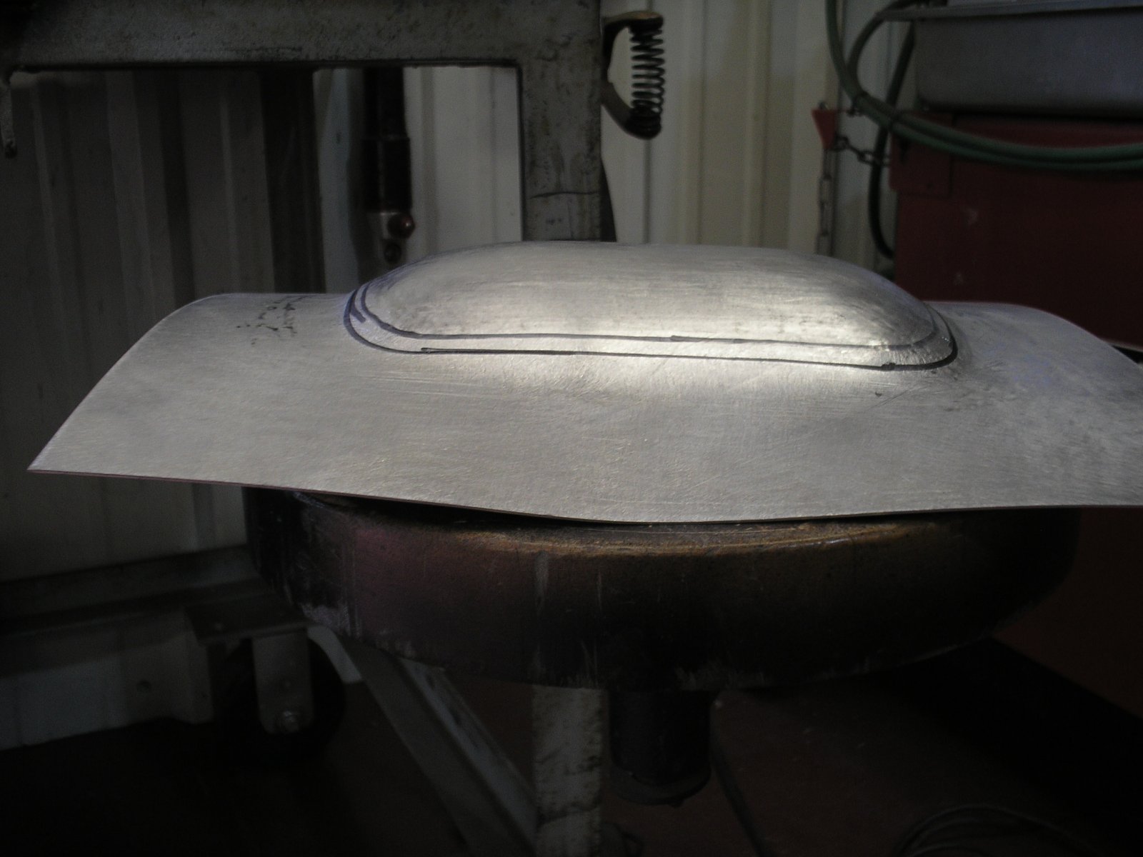

    ******* and dolly and a little time in the English wheel, the wheel will only do the very top. (this can be done with a dolly but the wheel is a little faster). Starting to look like something now. studebaker 010.JPG
    AHotRod likes this.

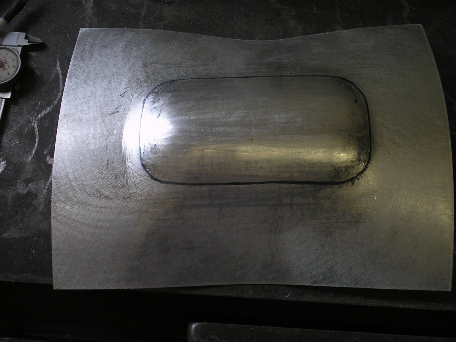

    now for a mark on the top side so I can start getting the shape right. studebaker 014.JPG

    Believe it or not it don't take long to get to this point but now the finishing takes a while. Just a lot of gentle taps with the *******. studebaker 015.JPG studebaker 017.JPG

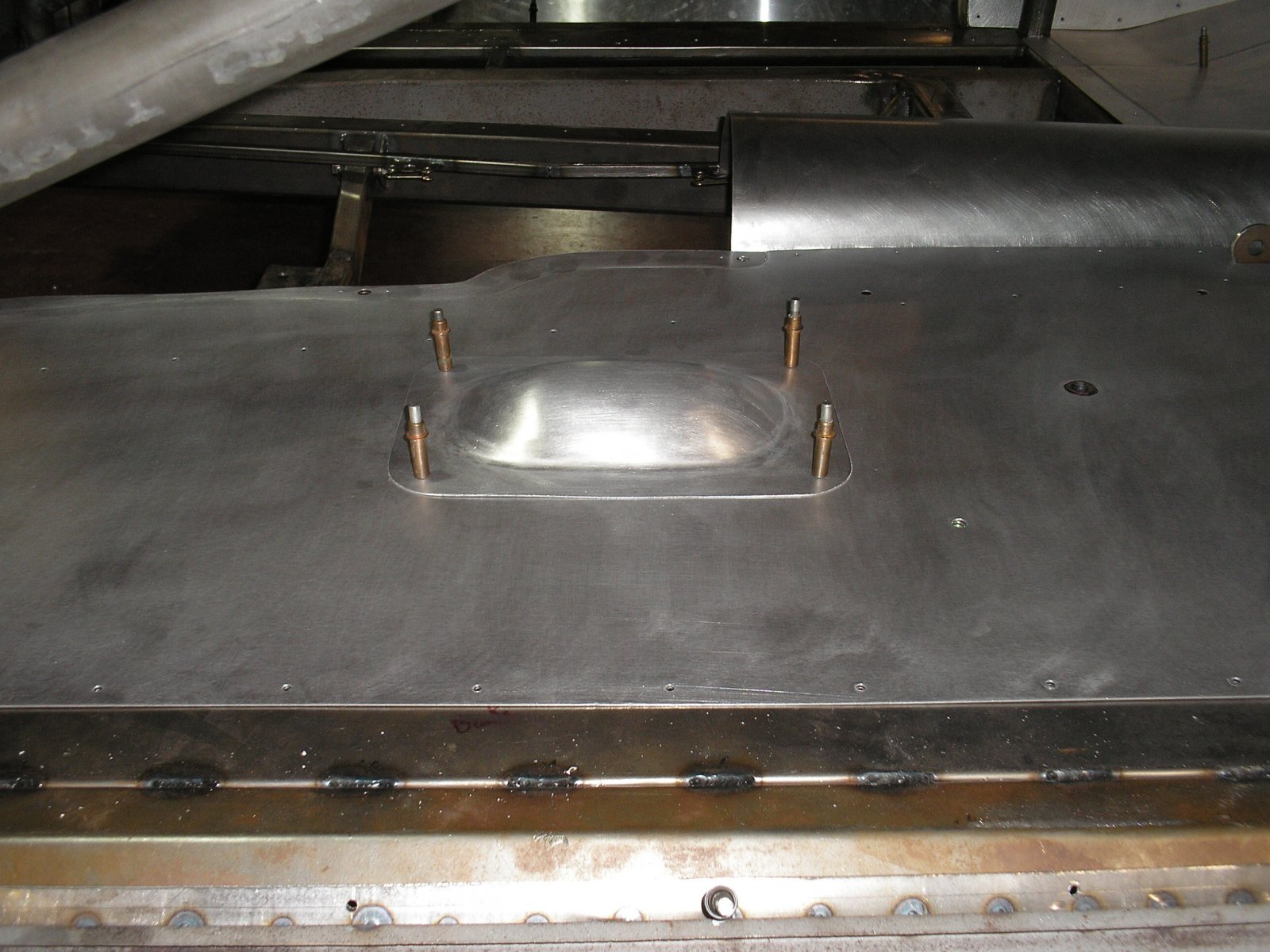

    The sides trimmed and checked for fit in the car. Still needs a few little touch ups
