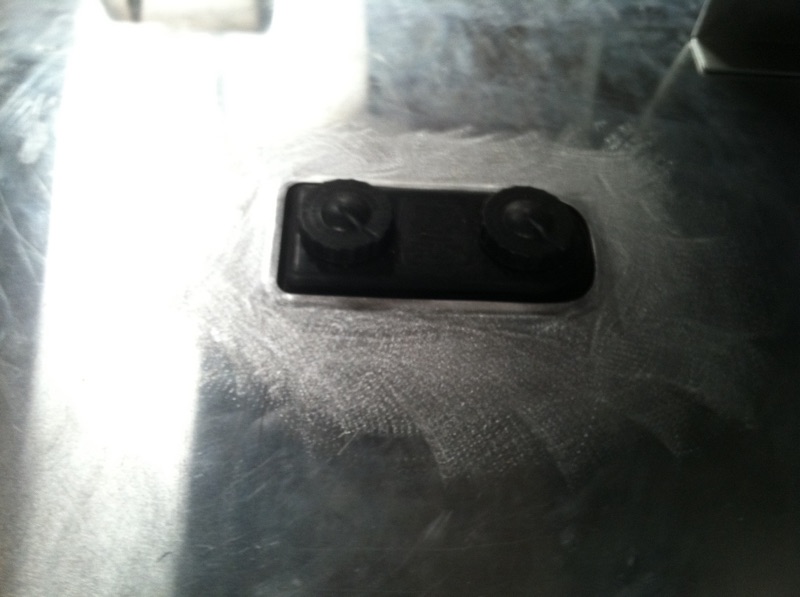

    Quain Stott
    A close up of one of the rubber radiator mounts. Of course the radiator will be painted black to look correct when finished. I didn't do the bad aluminum welding that's the way it was. studebaker 9 006.JPG .

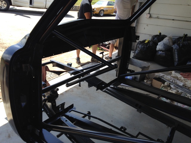

    I promised some pics of the studebaker as final assembly goes along so here we go. These next few are actually before it left my shop doing a test fit of the aluminum. The crazy humps all over the trans cover are for some way offset shifter linkage David had so we made it work. The master cylinder cover was hand hammered out earlier in the build thread. IMG_3185.jpg IMG_1711.jpg IMG_8826.jpg

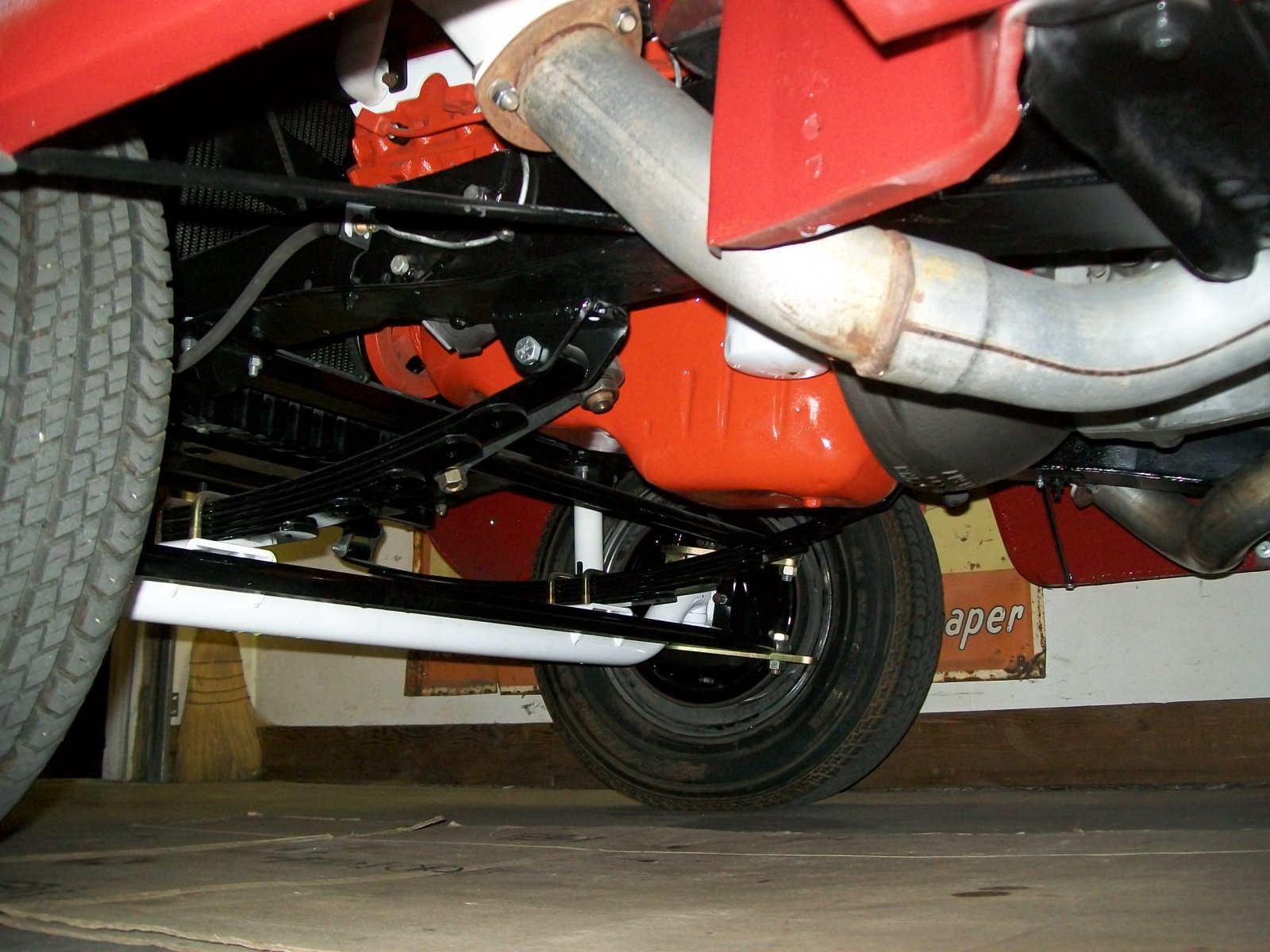

  28. Quain that is a beautiful car and you are a real craftsman. I don't know if you included more pics of the steering stabilizer but I was wondering if you could and also what part number you use. My 46 Pontiac has done it a couple of times to me- it has a 4" dropped axle with about 11 degrees of caster and all the steering is parallel and I think I am using those same steering arms you are. I have experienced the death wobble a couple of times and it scared the sh* 100_2226.JPG t out of me. It sort of came out of nowhere like you say and then won't do it for a long time. So I would love to add this to my car for sure. Any extra info would be great. Thanks and great job again! I wish I was closer I would love to race my car with you guys.
    Thanks- Adam Castle
  29. Quain Stott
    Joined: Nov 21, 2006
    Posts: 2,068
    Quain Stott
    Adam it's part # SSD 58 at auto zone. You can get it cheaper from Jegs but takes about 2 weeks to get it. So-cal has them chromed. They are for a early model Volkswagen so they are era correct. One end is bent and don't need to be, so I cut it off right at the bend and rose bud weld a female 3/8 rod end on it. Take care to let the shaft cool and spray water on it or what ever to keep the inside of the shock from getting hot. Make sure to have your wheels straight and center the shock in it's travel before mounting. I just mount one end to the tie rod tube (remember you have to be able to turn the tube to set toe end) and the other to the axle. I have mounted them to the steering arm coming off the spindle and the other to the axle. The mounts don't have to be strong because there is very little load on it but your problems will be gone. I'll have to get you some pics, if i forget remind me.
