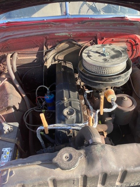

    One more..... The current power plant.... brace yourselves..... here it is: upload_2024-3-5_16-38-33.jpeg

  7. GordonC
    Joined: Mar 6, 2006
    Posts: 3,490
    GordonC
    NOW it's official!:D Looks like a good start!
