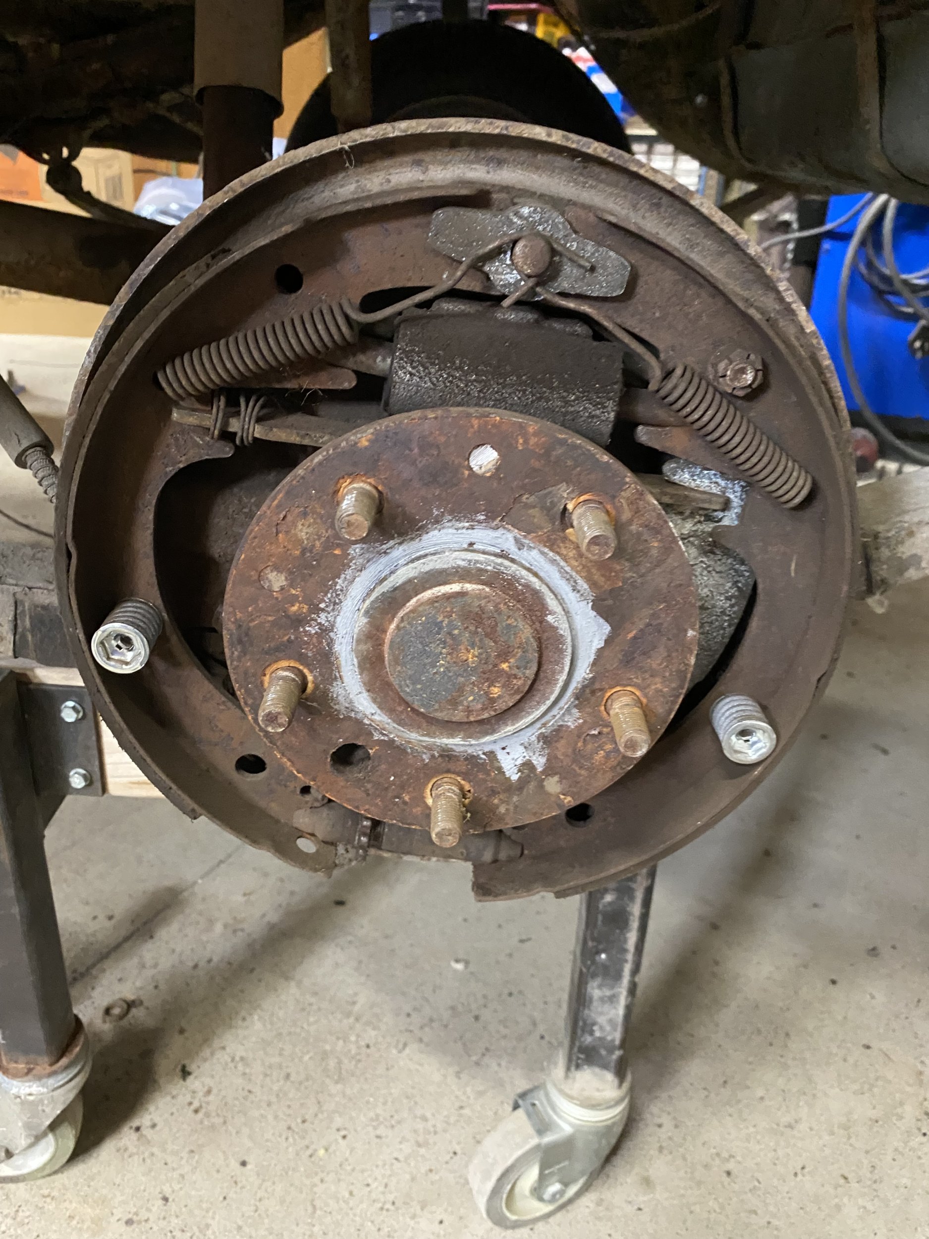

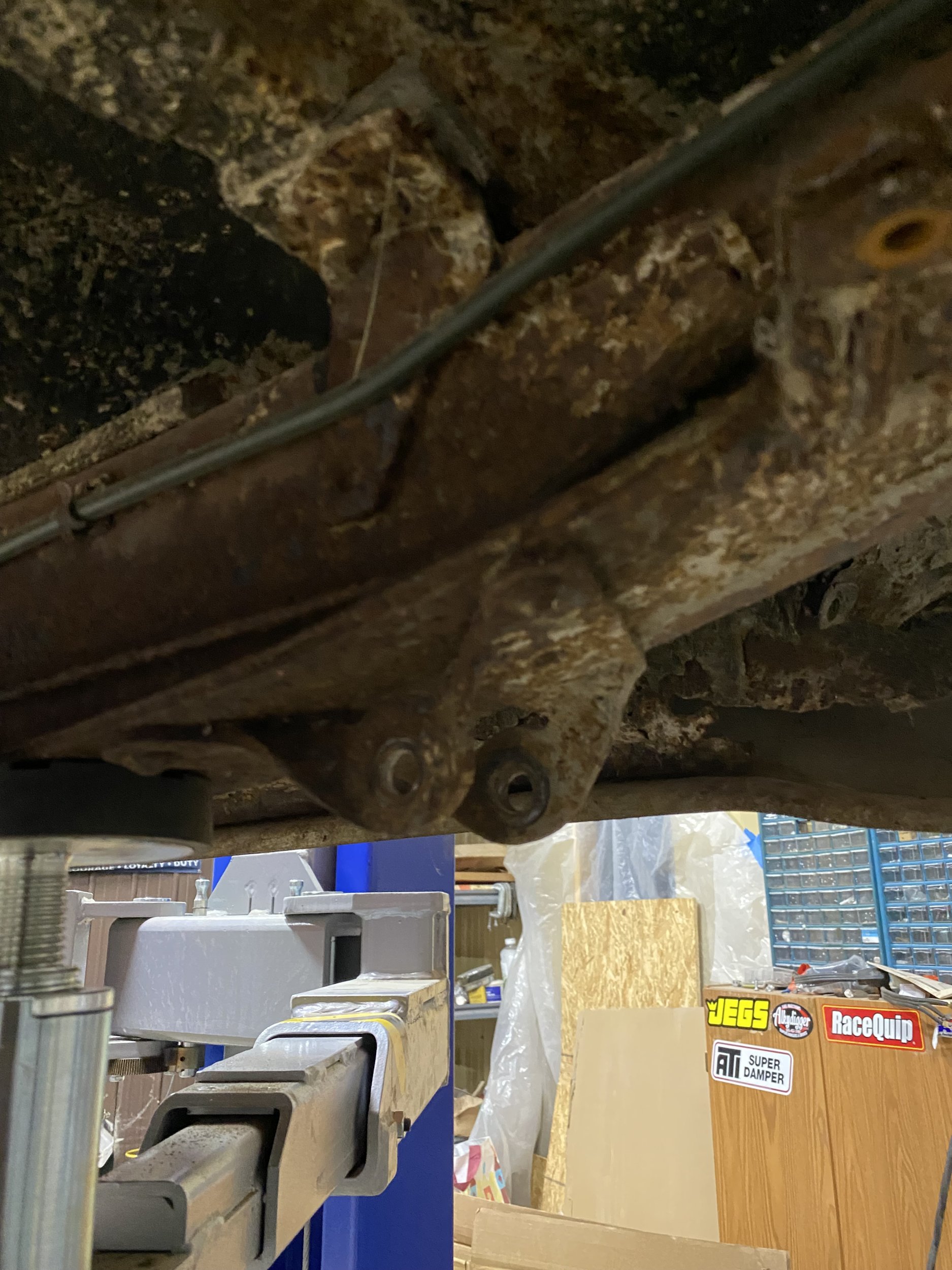

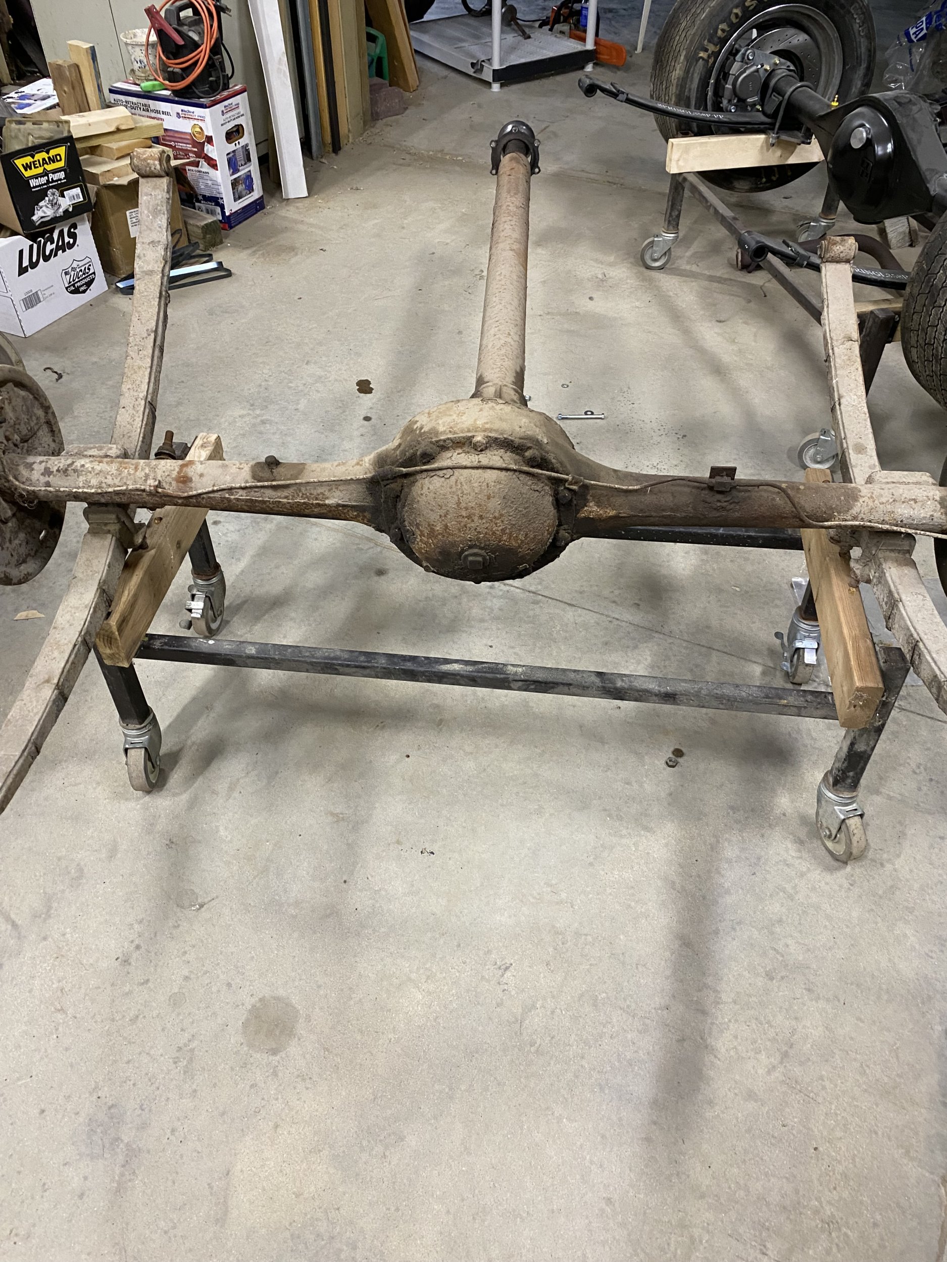

    Moving forward again. The rear end fought me not wanting to slip off the transmission. I guess it had been a while since it was apart. If I had it up where I could get at it, the angle of the dangle locked it in place. Since my help has been a constant no show I was a little cautious about trying to get it out while up. I made a dolly cart for everything to sit on and slide back with enough height to get under it. Drive the slip ball back and pulled the cart back with a come-along. It’s out. upload_2025-4-25_18-41-21.jpeg Brakes looked serviceable and started drilling off the spring mounts. upload_2025-4-25_18-39-42.jpeg

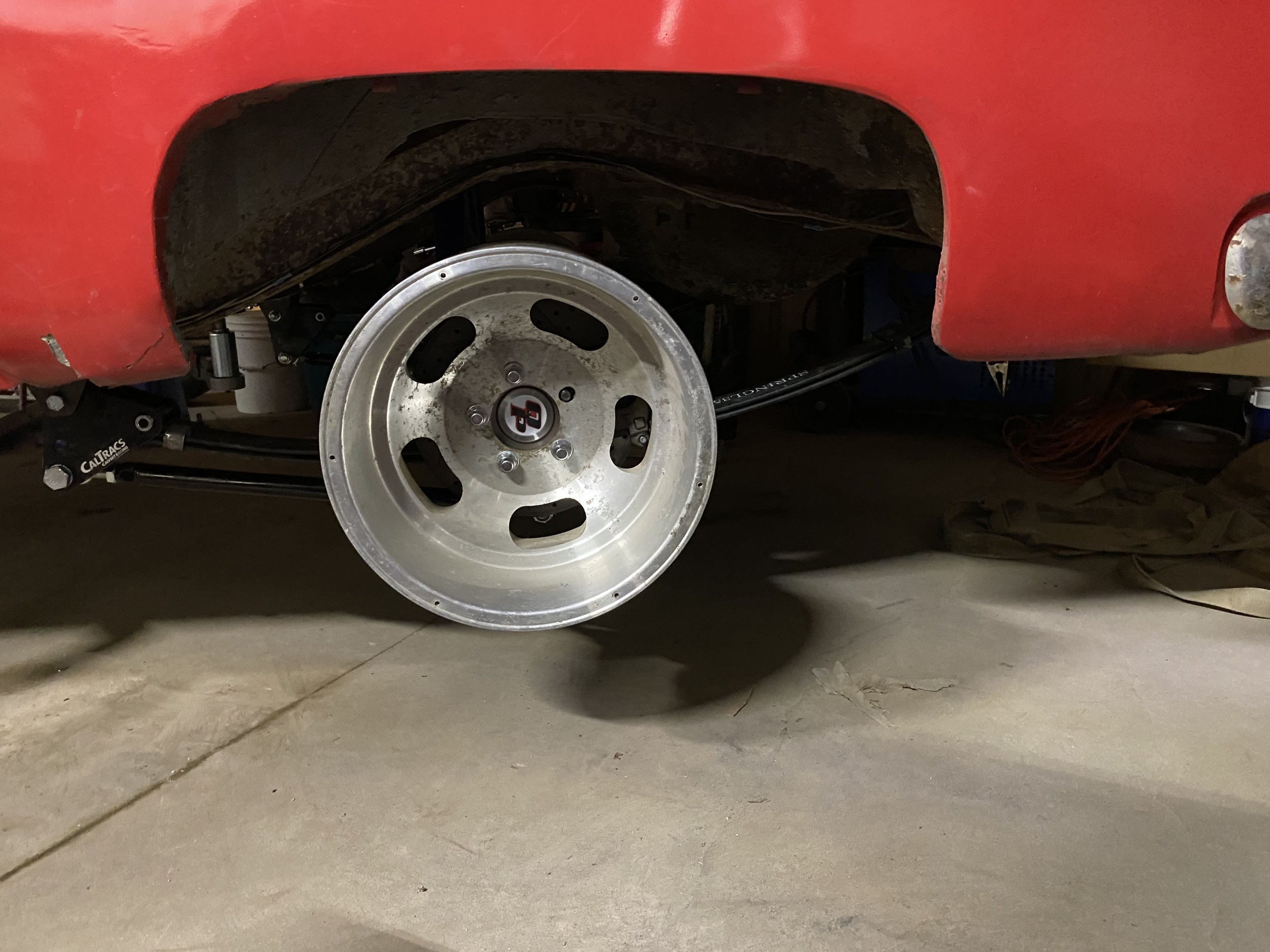

    Frame looks good so debating sand and paint, just paint, reinforced the frame and paint, or what. upload_2025-4-25_18-42-12.jpeg Rolled the 9 inch under to get thoughts on tires. These are too short but about the right width. I will rough in the spring mounts and Cal-traks then weld them and paint upload_2025-4-25_18-35-29.jpeg
    edit: Before you ask, the tires on the wheels are G60-15s. Not close to the 31s I want to run or the 29s I think are the minimum I will run.

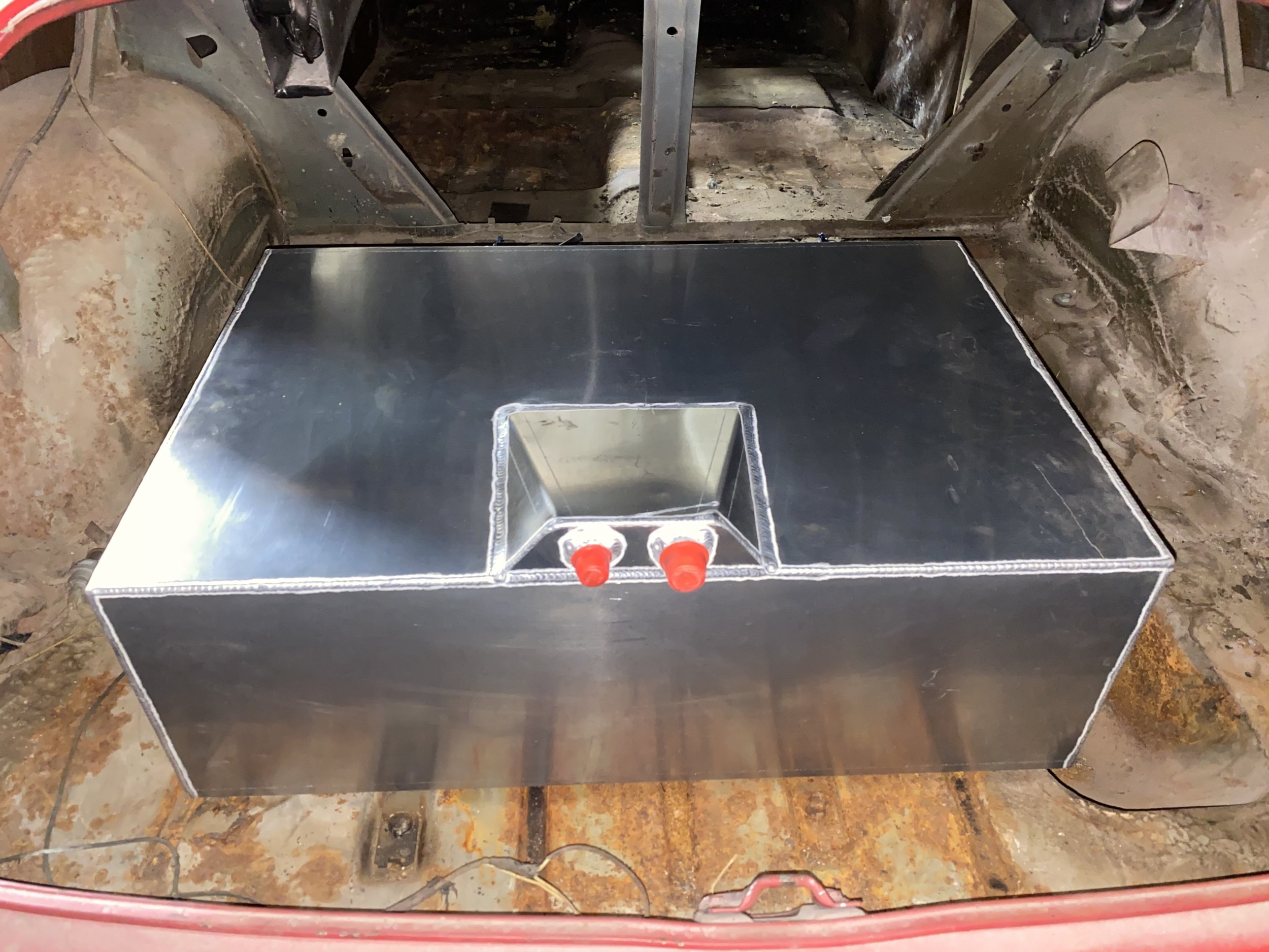

    upload_2025-5-27_1-23-21.jpeg upload_2025-5-26_22-19-33.jpeg Progress comes slowly but surely. Finally got the rear end under the car. CalTracs are on. Gas tank is out and I’m ready to mount the 25 gallon fuel cell and battery in the trunk. I think I need to cut the trunk floor and raise the fuel cell up to maintain clearance. And I’m trying to decide if I want the sump to the front or rear. I’m thinking rear with the pump mounted to the cross bar to slosh towards the pickup, but forward would be more out of the way. I found out two of my three options for rear wheels won’t work as it sits. The 10” Western slots fit great. The 8” ET slots have just a bit too much backspace and tires will rub the frame if I don’t remove the outer lip on the bottom. The 10” 5 spoke wheels have a step for the spokes that won’t clear the discs. And the radiusing of the rear quarters will require some extra metal fab to make it work since there is space between the outer fender and the outer wheel well. And with that thought I now realize the biggest hurdle is to stop over thinking every single aspect of this project. Time to just do it.

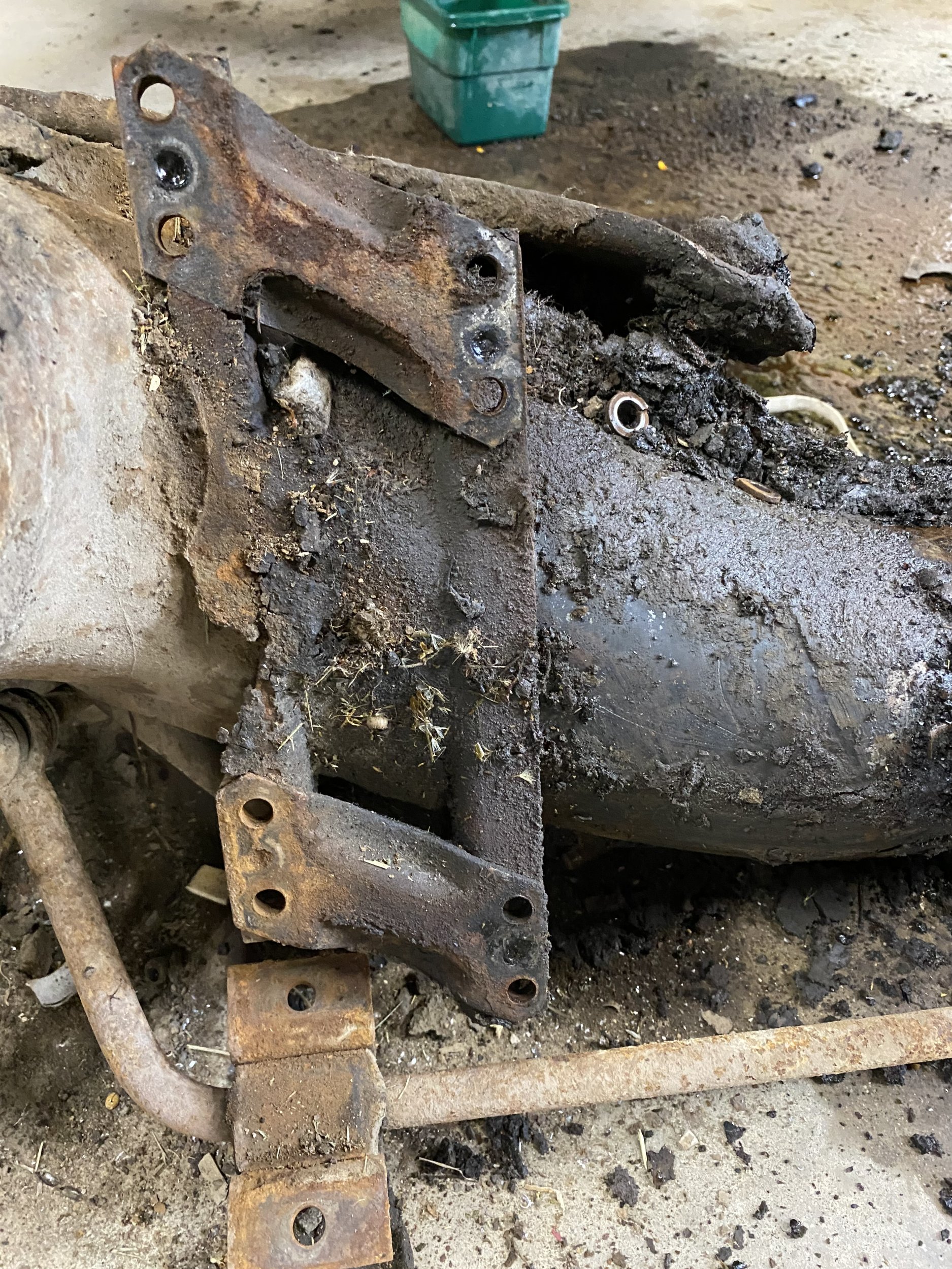

    Time to work on the front half. After a long struggle the engine and trans is out. New Yogi trans crossmember is on hand now. And today I dropped the front suspension. I have a definite plan going forward,so I will respectfully ask that this thread will be moved to the OT section. While the original suspension can be made to sort of work, it had too many issues to overcome. Not gravel road tough with the weight of the BBC, interference with the oil pan, and no power steering to name a few. So it will get a Heidt’s MII setup w/ power steering and disk brakes. It took about 10 bolts per side to drop the front suspension. Remove the brake lines and it dropped right out (Note: not in that order). I left the sway bar and tires on so I have a way to pull it out of the way. I will use a spare block to define what to do with the firewall once the suspension is installed.

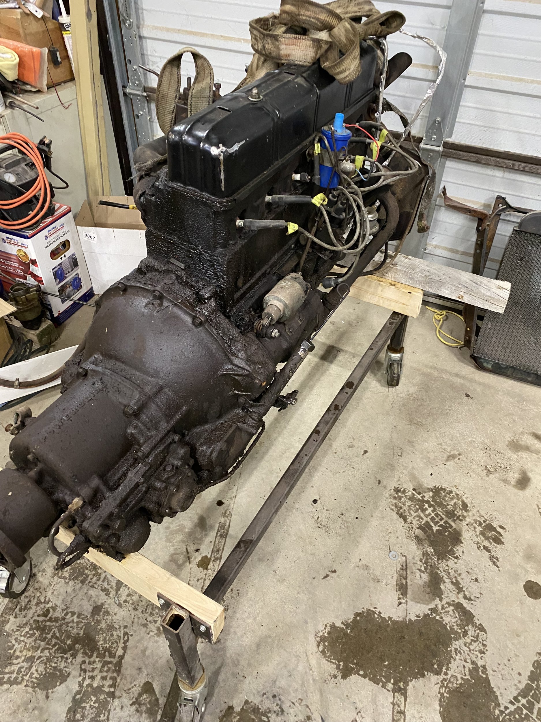

    Engine/trans is out on homemade dolly.
    Made a centerline for locating the new front end (may not be needed).
    disconnected the brake lines and lowered the lift in case CG causer to fall when the front dropped. Then unbolted the front end and down it came. (10 bolts per side into threaded backer plates.). Picture shows the 10 holes on the suspension.
    On the ground
    And now clean up and start building.
    Edit:? If you were wondering, it was good that I brought it down. The front lift arms had to be moved towards the back and it is still very light in the front.

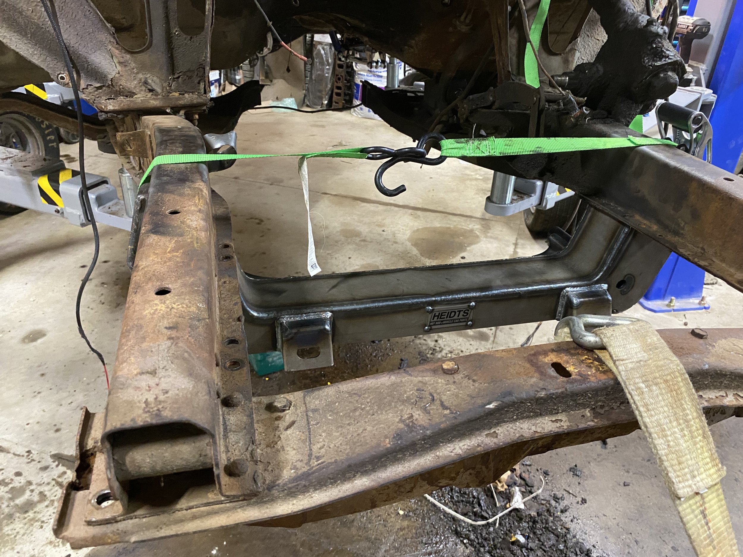

    Today I got the Heidt’s front crossmember trimmed and located. Now I can start assembly since I know it fits. Had to grind 1/4 inches to make it wide enough to fit the rails. Also have it 1/4 inch forward to match the original tire center line. I’ll tack it in place and hang parts on it before I finish welding it in place. Part of the measure 3 times and cut once ( ok until I get it right) process. If you’re wondering, the yellow strap at the very front is to anchor the front down. It’s a little light right now and will tip back with the slightest pressure up on the front or down on the back.

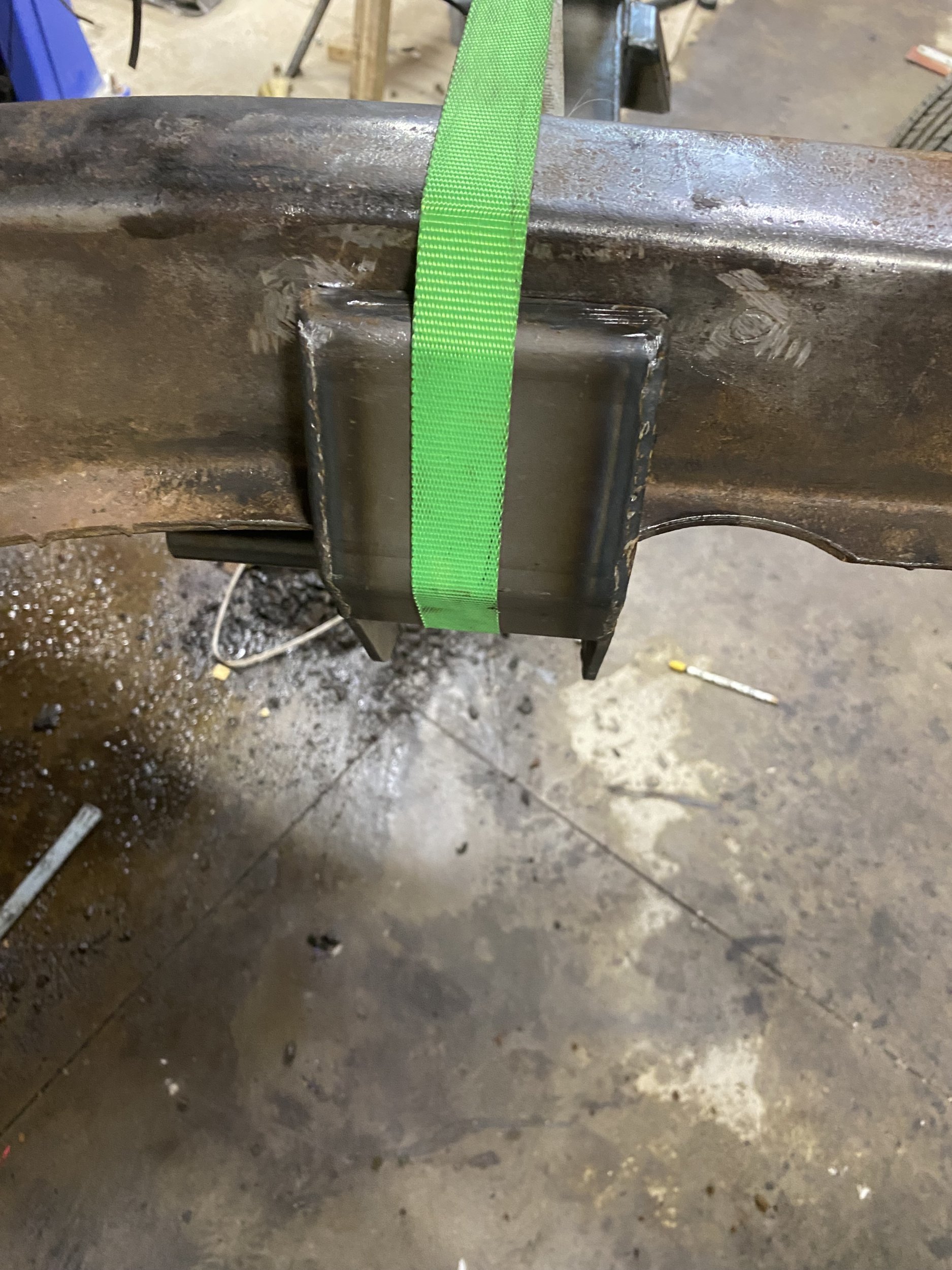

    To mount it you have to remove the locating brackets from the frame and notch the outside lower lip to clear the mount. the bracket is bottom outside of rail and the notch goes below it. The welds that secured it are visible by the green strap.
