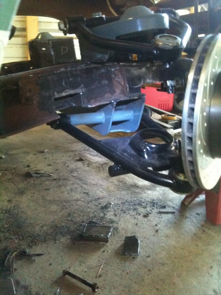

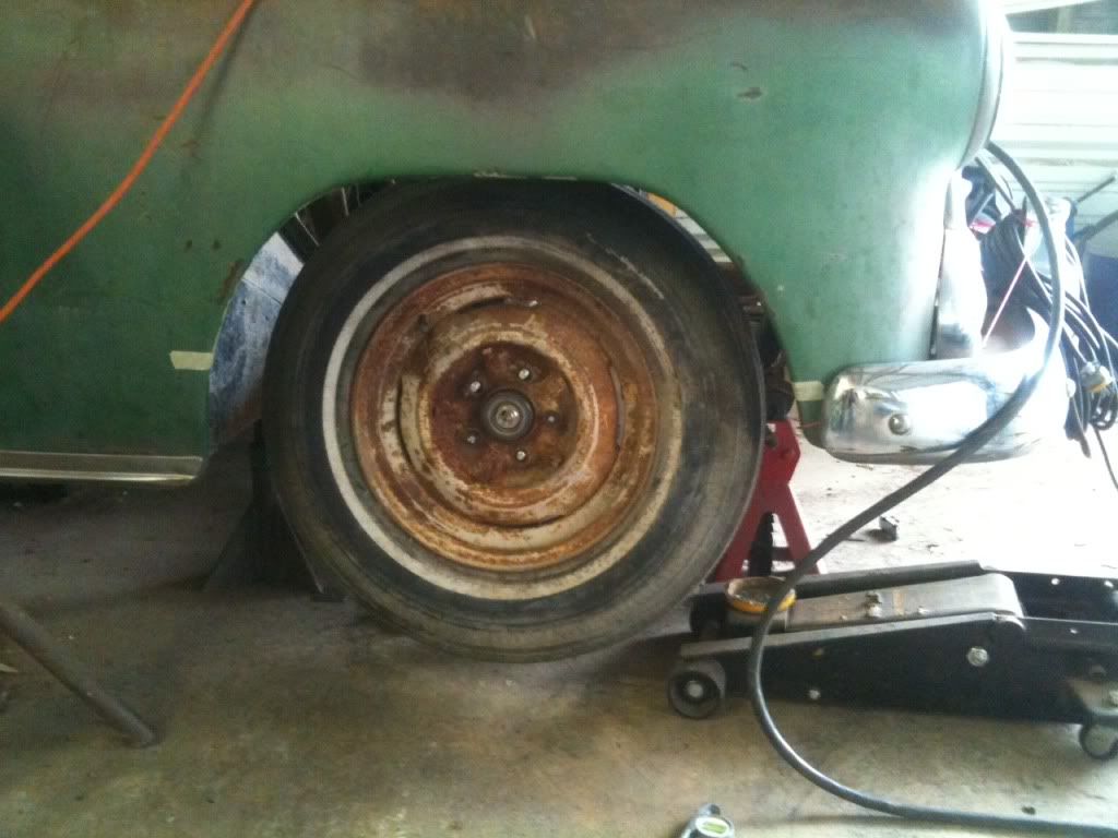

    i was spending too much time on the stock stuff and not getting anywhere. sold the wheels and bought m2 suspension. dont freak out i plan on reworking the a arms. just wanted something with most the work done. im getting 10" of travel and it lays on the crossmember with a 27" tall tire
    Lifted up
    Layed out with the tire turned pas lock
