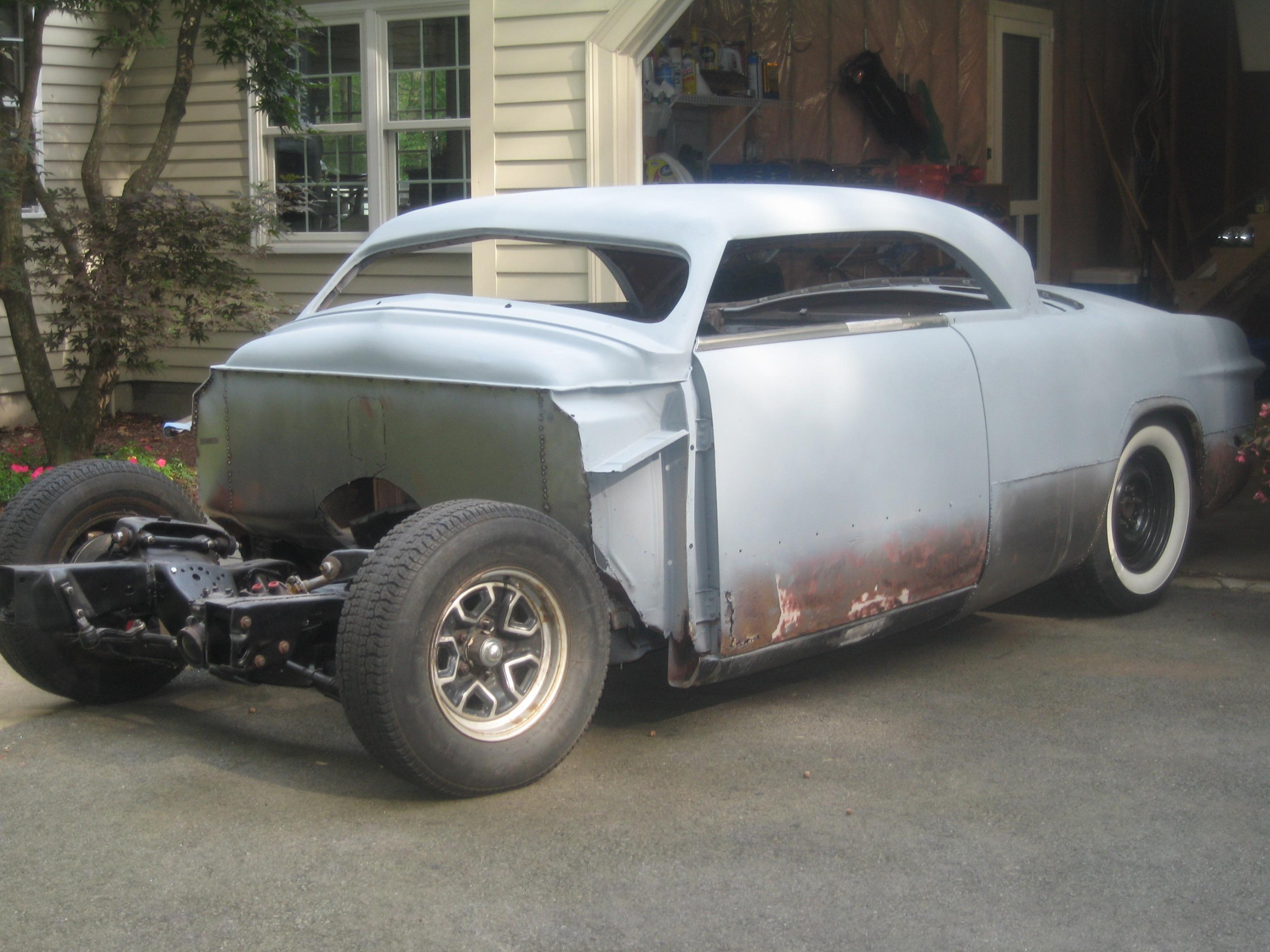

    Anyway- 51 vic that I bought and was already om Merc Marquis chassis and pan- too wide and too short. Quarters had been hacked off so the rear wheelbase would fit.
    I cut it all apart and started over w/ an 85 monte pan and stretched the Monte frame 6 inches.
    I used some leftover parts to make new quarters- you can see that I am still perfecting my welding so have quite a bit of grinding to do and will probabaly take 5 gallons of mud.
    I whacked the roof 6 inches and slid the rear window forward and had to fill a 6 inch gap between it and trunk.
    I removed the drip edge just above windshield and the sectioned an inch out as it was too heavy looking and now the side glass will appear at same level when stainless glass channels are in.
    This what I have so far from what everyone said was just a parts car.

    What are the wheel openings?
    Oh yeah, thanks for the pics!
  15. Hdonlybob
    Joined: Feb 1, 2005
    Posts: 4,135
    Hdonlybob
    Wow...way nice !!
    Great job on saving another butchered one....
  16. smooth50
    Joined: Oct 7, 2004
    Posts: 296
    smooth50
    from MASS
    Hey Keith,
    Those wheel openings are from 49-51 shoebox front fenders. I just flipped them side to side. The previous owner had cut them out as he was going to move them back on the front fenders to accomodate the shorter marquis wheel base. He was off to a reasonable start but the Marquis wheel base is too wide and too short. You should have seen this body hanging from the rafters in my garage when I cut it loose from the marquis pan and slid it out. I am too Impatient to stop and take pics, you know?

    Both quarters are ground and a coat of Mar glass has been finished out. rear bumper filler piece is molded in. so really just some skim coat in a couple areas. Drivers vent window is done. Column and seat are in for mock-up positioning, etc.
    I just picked up a "slightly used- Yeah right" 350 and 200-4r. Gonna give them the rattle can refresh soon.
    I need a name for this car...
    El bondo is taken..
    Shitbox is taken..
    How about the suede loafer

    I am in the process of puting a '51 Chevy coupe on the same exact chassis and floor pan ('82 Grand Prix, in my case). I've got a question for you: how did you locate the body on the floor pan before welding it all in place?
    I'm worried about getting the body too high, too low, or too far forward or backward when it's time to button it all up. I'm a smart and careful man so I know the real answer is "be really careful and look at everything before welding" but I'm hoping you came up with some clever tactic that made it less difficult?
  29. smooth50
    Joined: Oct 7, 2004
    Posts: 296
    smooth50
    from MASS
    Nothing clever here, I am too impatient for that.
    Measure, measure, and measure again.
    Really, I knew the chassis needed to be lengthened so I did that first. Then once I had the body suspended over the frame, I figured that I needed to lose the late model firewall and I still ended up changing how the late model pan is sitting on the late model frame. Once I figured ride height of body- really it was about looks but the fact that the late model pan sits inside of and lower that the related frame rails, you are able to really channel it down over the frame and pan quite a bit. I have to say that with the monte bench seat and tilt column, it sure is comfortable. I went with tilt purely out of function, I prefer the old school look but hey, this is a hodge podge of stuff and the exercise in the build is fun as hell.
    Oh, btw, if you are going to cut the stock floors out to use the late model pan then be sure to weld the doors shut with washers or scabs of steel. Dont open them up till body is securely welded to its new pan.
