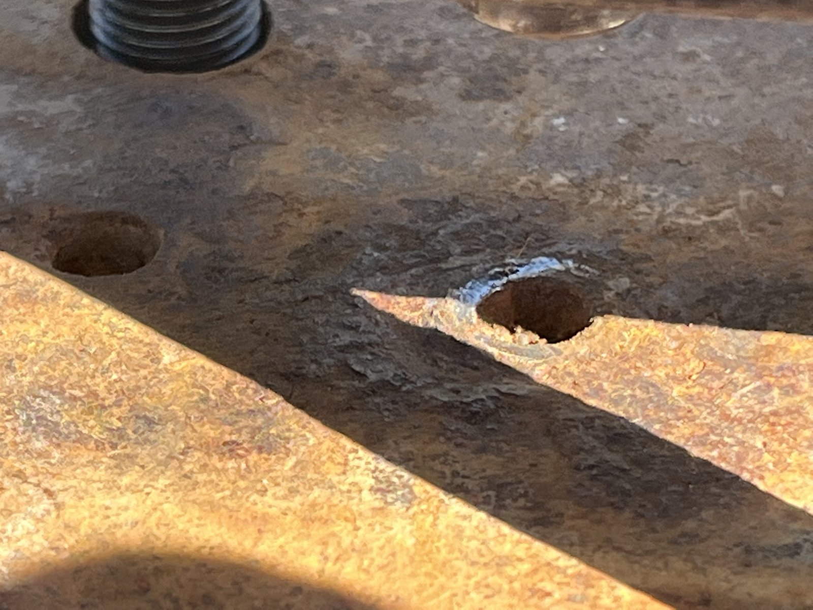

    Yes center spring bolt mating hole. cleaning it was my first thought but appears to be metal.. There’s a set of two holes each identical size. You can see in the image where I s****ed to bear metal at the pin diameter.

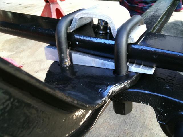

  9. There is a spring wedge that has a tab on the back to keep the axle at 7 degrees, the spring wedge has a hole for the bolt in the spring pack caster.jpg

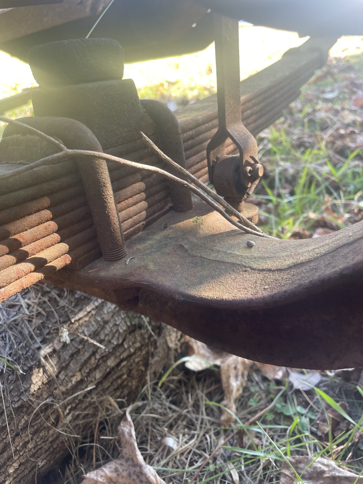

    random pic.
    I have a 49 gm truck axle set up outside. I can take a pic tomorrow if ya need it

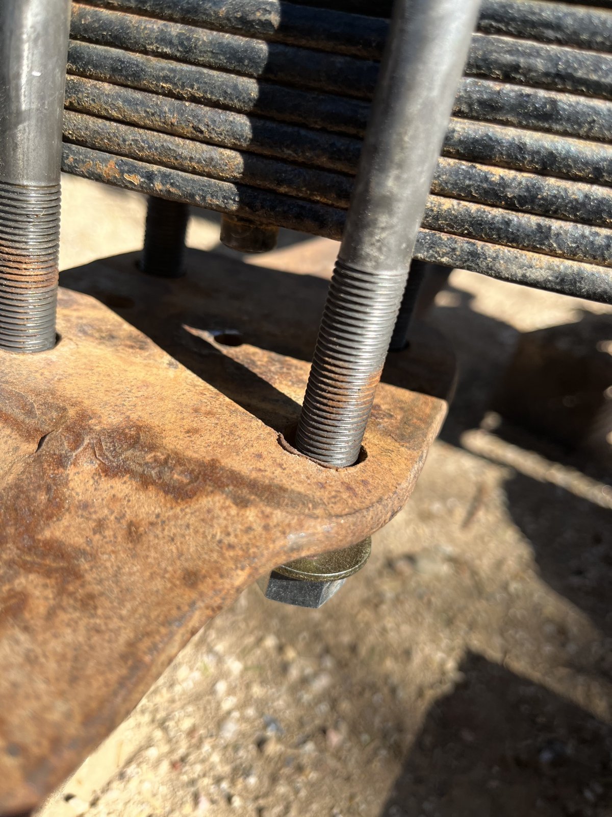

  17. Here is my 49 axle
    not much help

    I see the shim in that stack but have a hard time believing it’s enough to take up my leaf pin height. Thanks for the pic
    I know the springs that came with the truck were rebuilt so it’s not unlikely that’s some of my issue

    That center bolt hole looks like it’s rusty in there. I could check the size on a ‘55-9 front axle, but since it seems you’re now installing an axle, put a drill bit in the other side, see if it fits the side you’re having issues with.
    Ie if it’s 9/16th, then use the bit by hand to clean up/out the hole.
