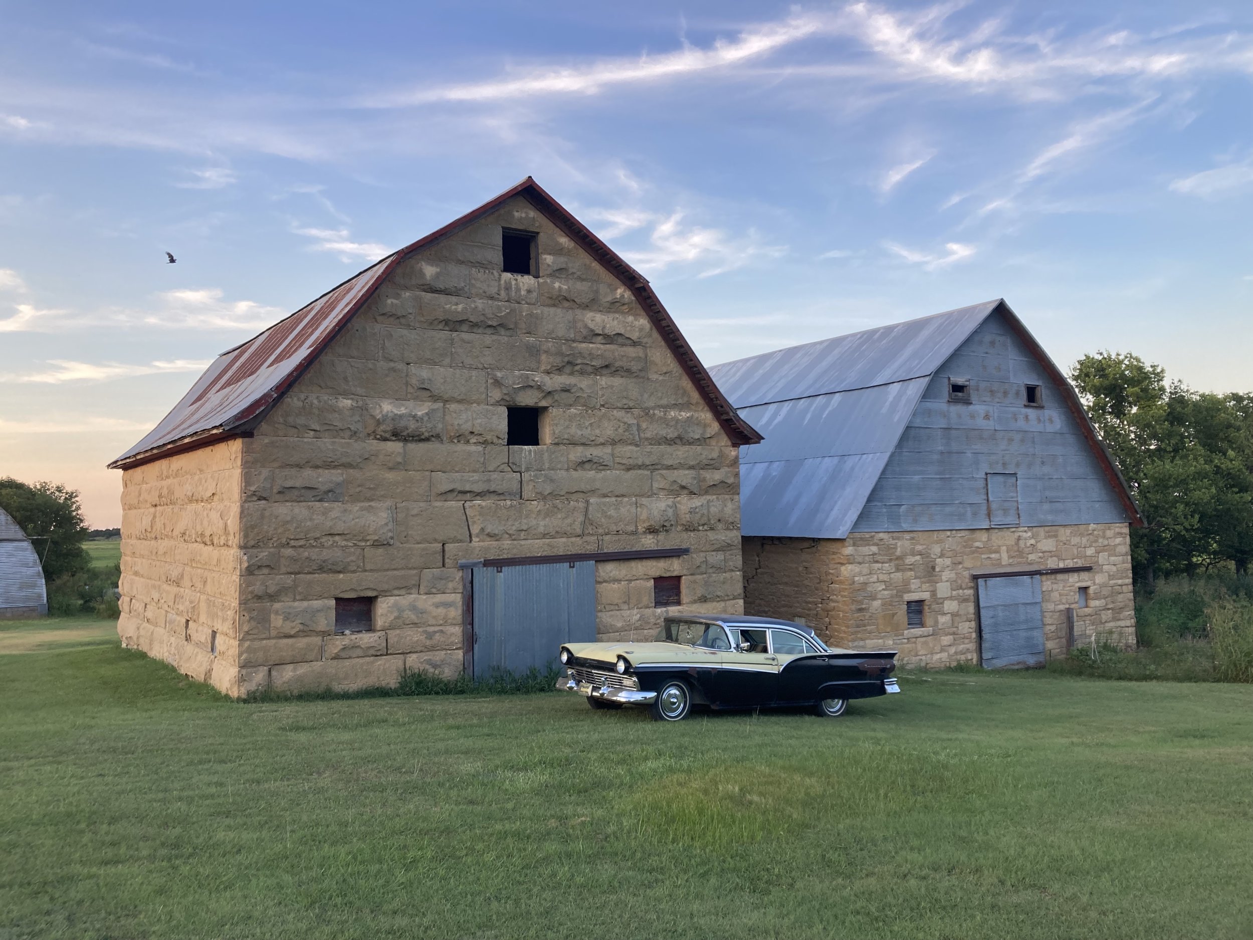

    Pictures from a couple of cruises in western PA this summer. Maybe some members know or own these cars?
    I wish getting information saved here from the 52-59 Ford social group stickies was as easy as posting these pictures. Can anyone help with that? Thanks.

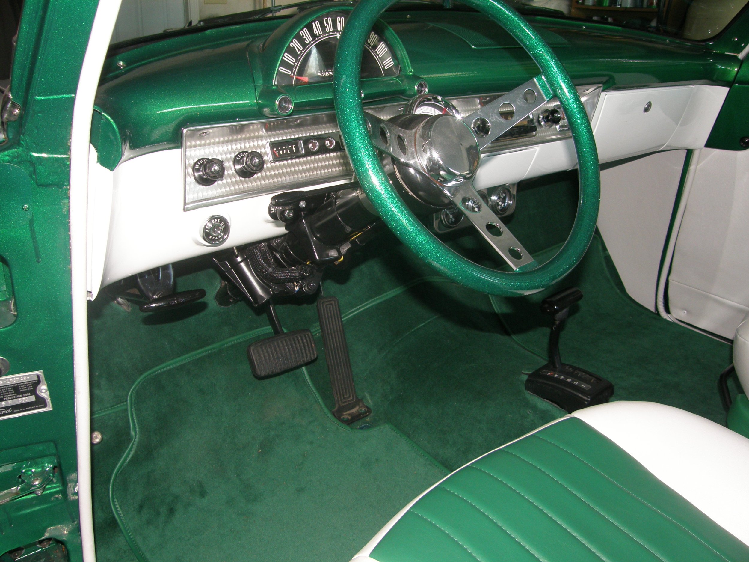

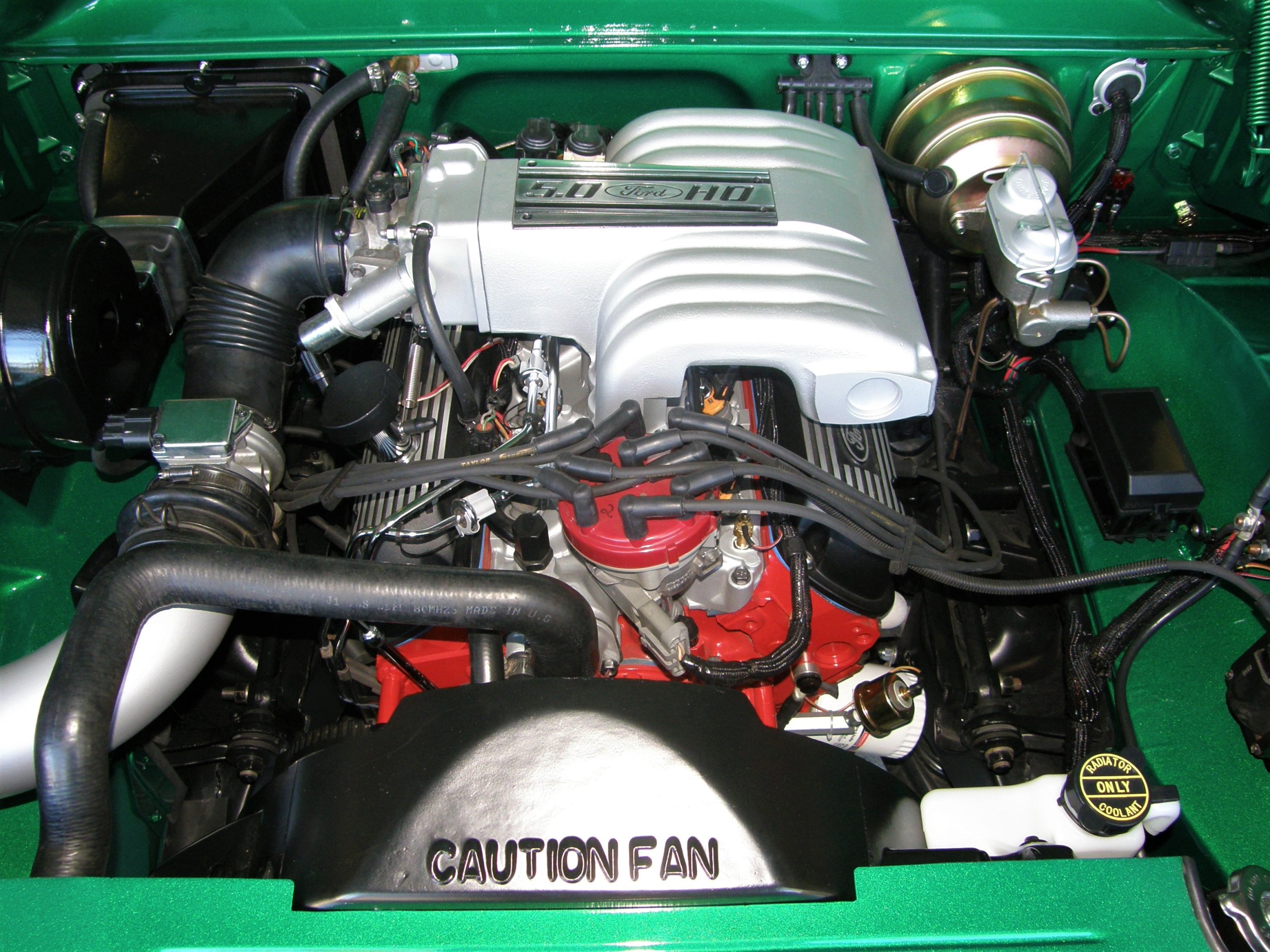

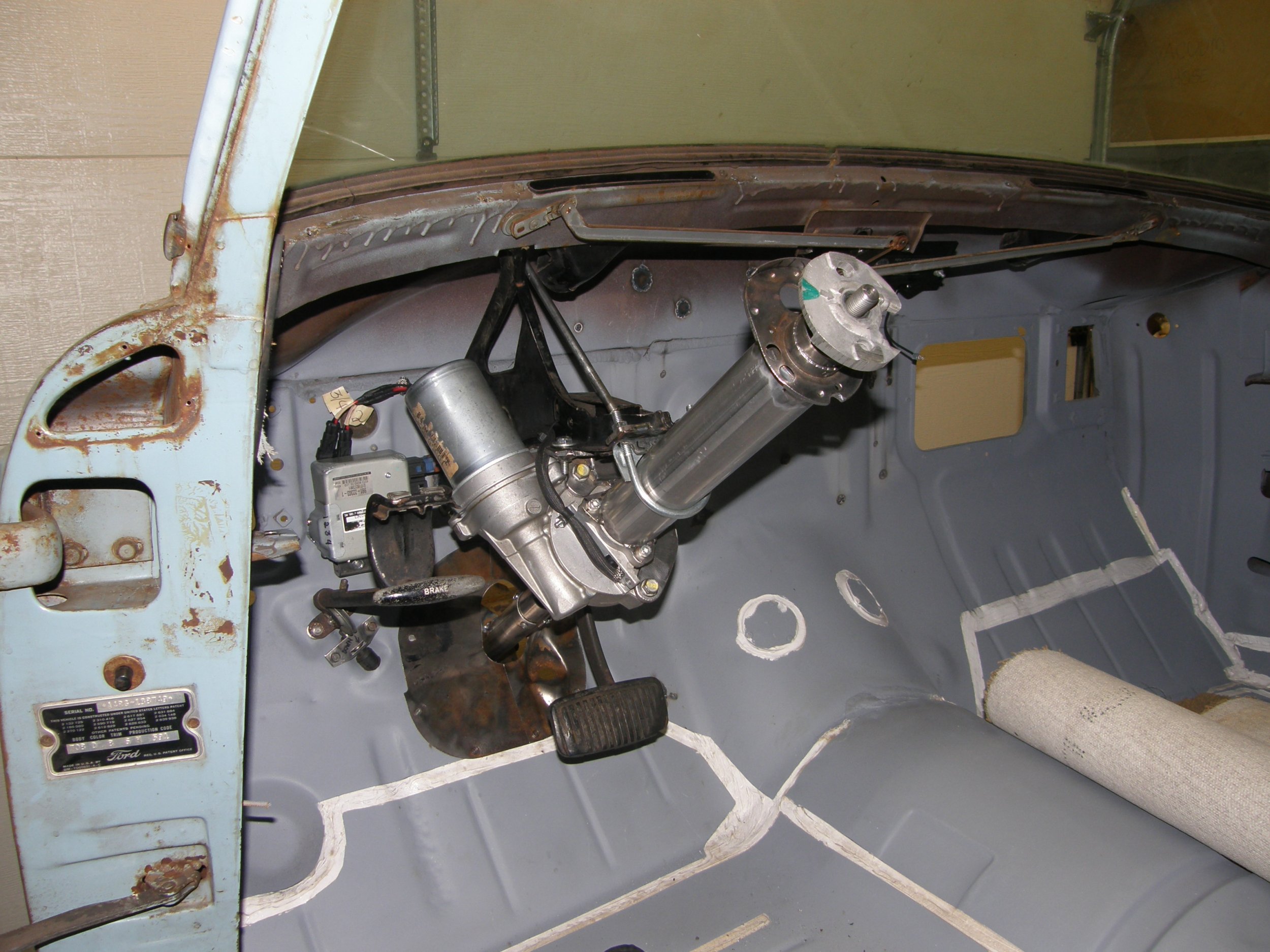

    Thanks corncob! Now I can post without fear of getting deleted!
    My build thread is in 'Off Topic' so I appreciate that. These are the two reasons why my posts got deleted on the main board and, I can see why...............
