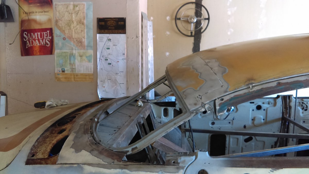

    This... This whole section proved to be a real pain in the ***. I'm adamant on keeping the stock rear gl*** uncut. I know, I create my own problems

    I read different ideas on how to suspend the roof. I ended up using bike hanging hooks and tie down straps. Good ol harbor freight! Since this entire operation is being performed solo, the straps worked out perfect. IMAG0006.jpg
    It was about this point I decided the top of the b pillars were going away. Along with all side gl***. Kinda cheating, but I like the idea of smooth shaved door sills. No window pinch on the soft part of your arm when you're trying to look cool.

  13. itsonsucka
    Joined: Apr 26, 2017
    Posts: 30
    itsonsucka
    How much did you shrink the rear of the roof to lay that window down
    Sent from my SM-G925W8 using Tapatalk

    Total drop on the roof was a little over 5". Removed about 4" of roof metal

    The Suburban in the background provided the material for the section between the trunk and window. I cut that roof off completely, like a 4 door k5. F it, steel is steel.
