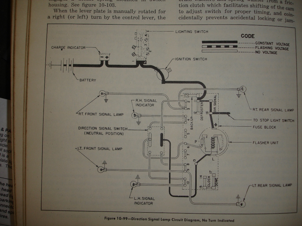

    i have 52&#8217; Buick and am putting in a Ron Francis wiring harness. <o:p></o:p>
    The kit is set up to use a newer style GM steering column. <o:p></o:p>
    I am using the original Buick column though. The turn signal switch has 6 wires coming of (diagram).<o:p></o:p>
    The Buick used to have 2 light bulbs each side. I am now using a single unit with a 2 filament bulb.<o:p></o:p>
    I got the old turn signal switch working but can&#8217;t figure out how to hook up the brake lights. When the turn signal is activated and I hit the brakes, the light just stays on and doesn&#8217;t flash like it should.<o:p></o:p>

    From the looks of that wiring diagram you will have to use a seperate bulb for the TS in the rear.
