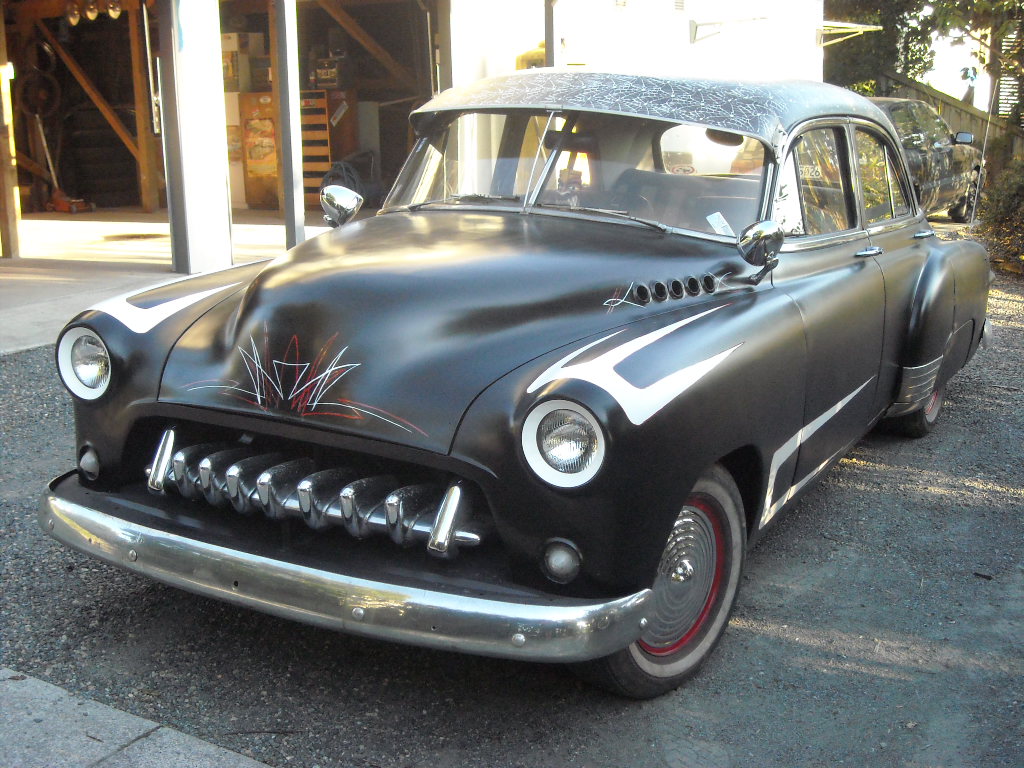

  23. Yes you do need to consider the width when looking at wheel offsets, but it can be done . I will dig out a photo of a'52 with jag front and add it here later tonight .
