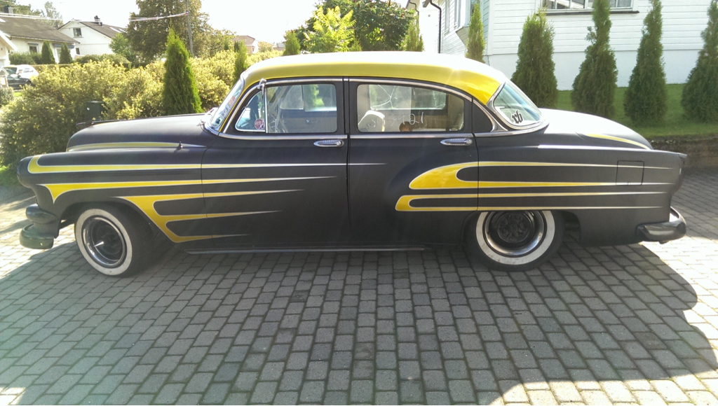

    Why dont use lowering blocks? Mine has about 3" blocks on nova rear end. No mods to the frame. And I think it's low enough to still be able to drive on all the ****ty roads around here.
    Another thing you must consider is the torque tube drivetrain if you stil running stock. It may hit the floor before you are hitting the frame....
    Picture of my car, it is a little lower in the front now as I have cut 1.5 round of coil as well. ImageUploadedByH.A.M.B.1453290080.382576.jpg

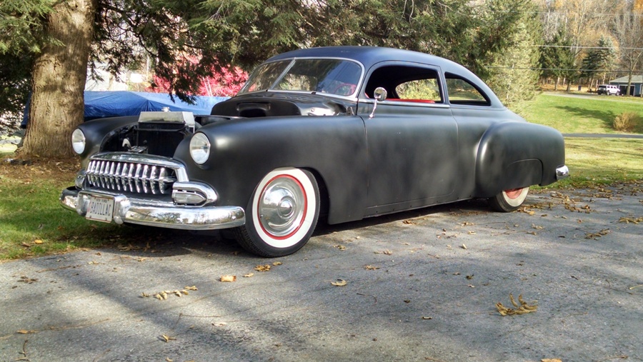

    Here's my wife's '51 with 3" lowering blocks on a stock rear. I think we cut 1.5 coils off the front. The ride was a little stiff, but not bad.

    GREAT looking scallops, Gleid. Love the gold!
    From the pic, it looks like even steep driveways are not a problem. Beautiful neighborhood!
    Unusual color choice...looks sharp!

    Thanks MO! Paint job was done by one Mitch Highley from Missouri. Very talented guy.
