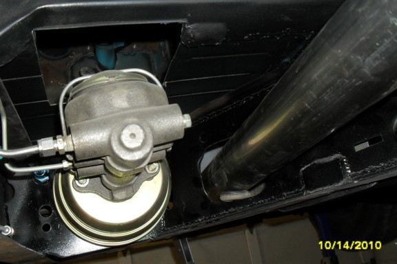

    I ran one in my 53 chevy wagon and my kit aligned with the factory hole (had to be enlarged). I created a skid plate to help minimize scrapping it on speed bumps as it does hang below the frame. I am currently looking at my opinions as I am in the process of installing a Mustang II set up under my 51 chevy. I have come to realize with how low my car will be (like my wagon or lower) I do not want to mess with a under floor unit this time and will probably go with either a Walton Fab set up (firewall) or an offset booster set up from ECI.
    Before I make my decision, I will find a 8" tube (diameter of Booster) to see If I can move it back further and up slightly (make a bump under the front seat) with an access hole maybe just behind the front seat (rear seat foot floor board or have it so if I slide the seat fully forward I can gain access) as I would prefer to not have it on the firewall (just finished smoothing it).

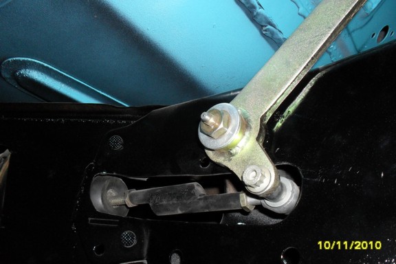

  11. I used a Pirate Jack setup in my 50 Pontiac - cut it up quite a bit and made my own booster mount - it's no lower than the frame. The door for the M/C is ahead of the seat (barely). Also, you have to run residual pressure valves - no big deal.

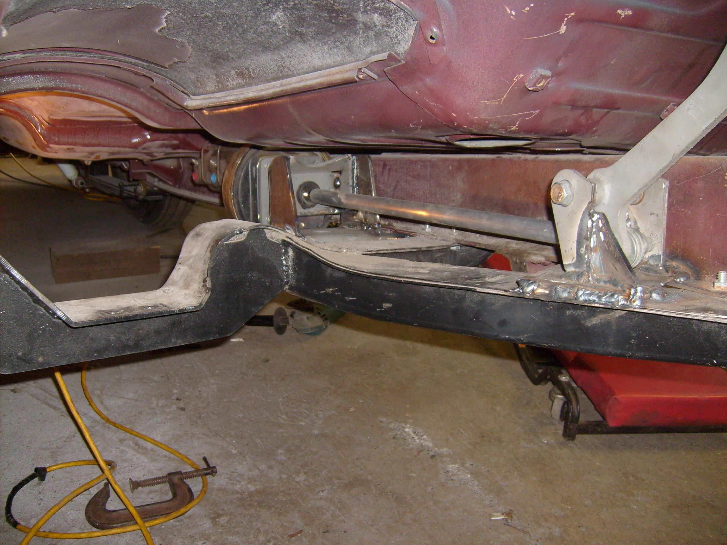

  13. No, it's just in front of the seat. The Pontiac chassis is different than the comparable Chevy years, as I found out after I got this car. I'm pretty sure you could squeeze it in a Chevy, though. I really ended up using the pedal, fabbing a shaft that passes through two layers of the chassis, and using the booster and M/C. The rear fitting is a SwageLock, so that I could run 1/4 lines to the rear. I actually like them better than AN in some apps.
