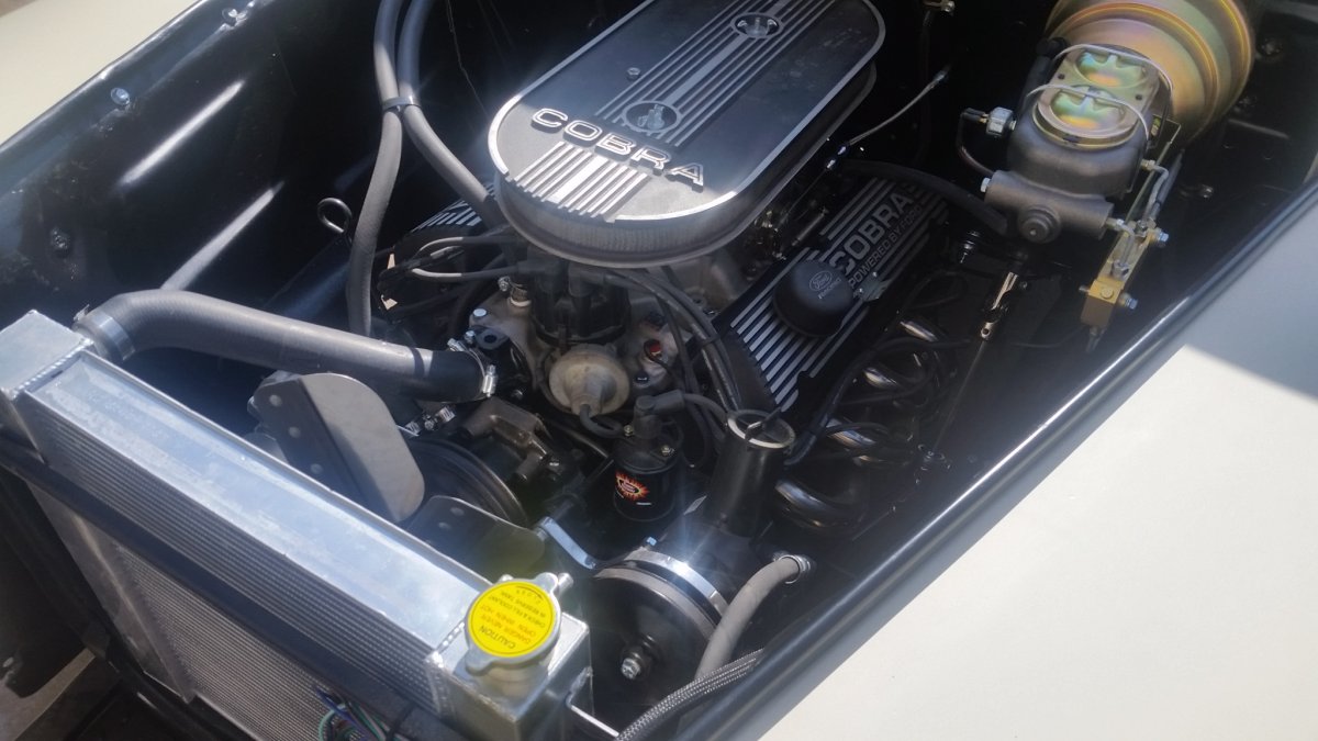

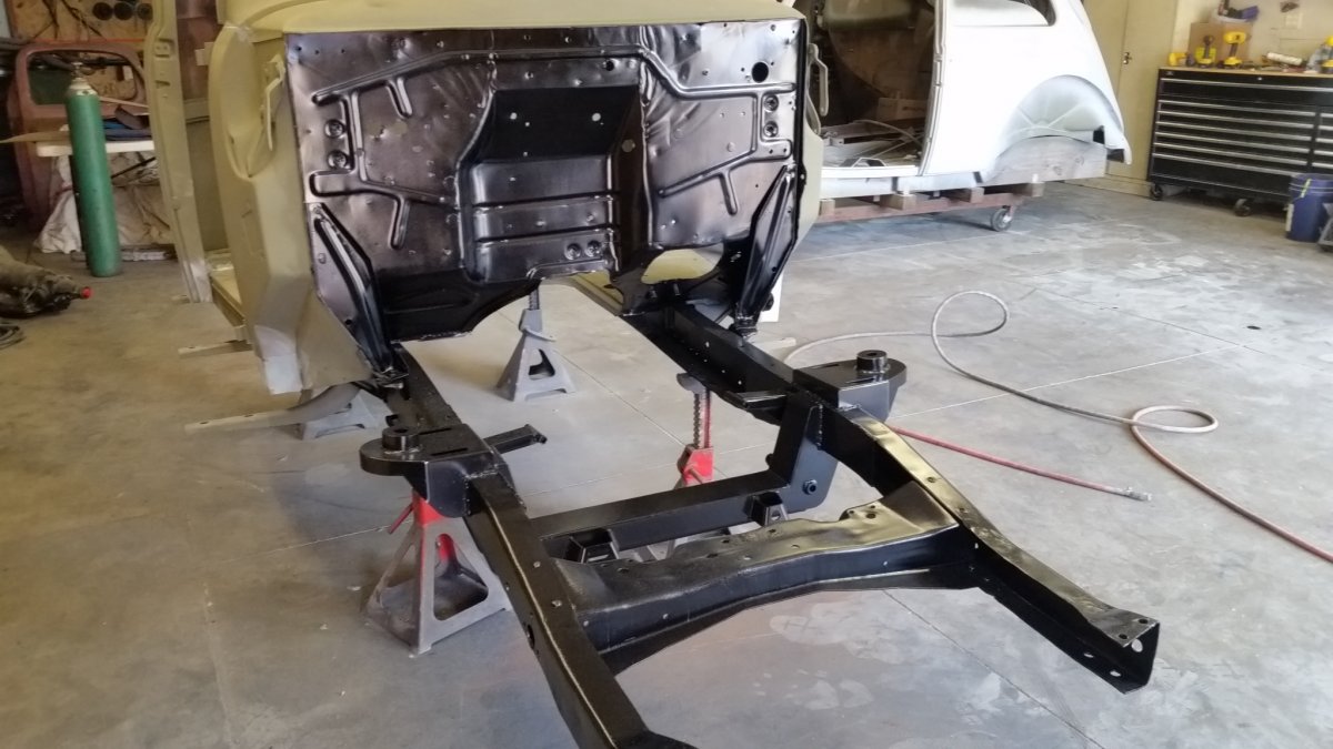

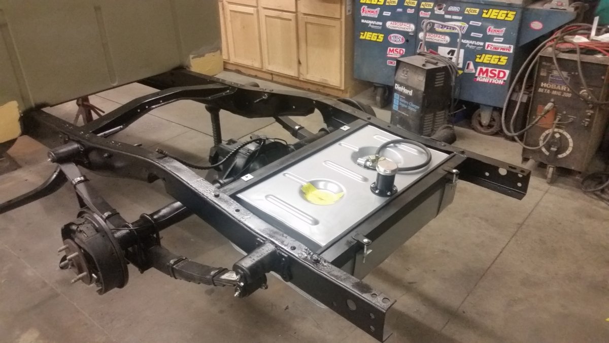

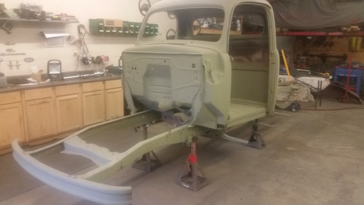

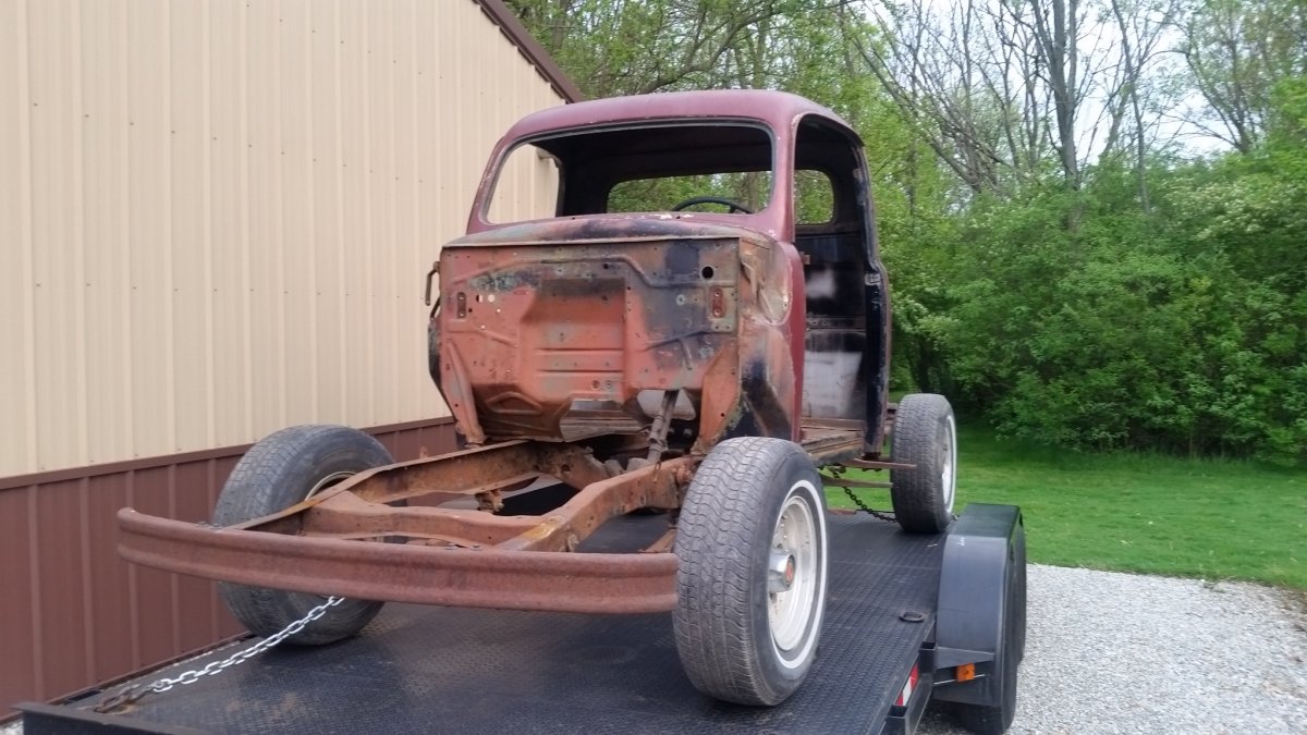

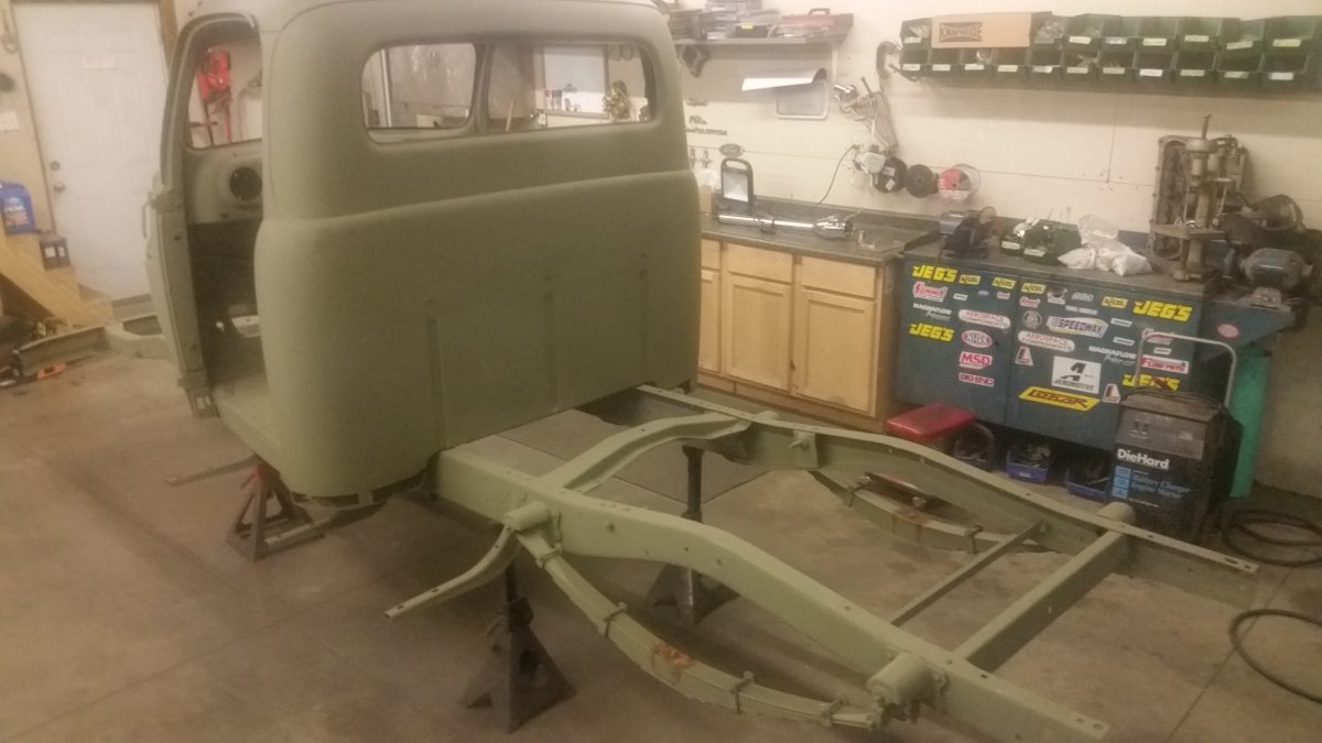

    Randy and I are working on another shop truck hopefully completed in the next month.
    Started out as a solid Indiana project neglected and moved outside until we took it on.
    As always, down to the frame that's sandblasted and painted after all new front and rear suspension is installed.
    302/AOD/8.8 posi rear.
    Body stays stock with all new gl*** and interior.
    More pics to come. 20170510_200310.jpg 20170510_200322.jpg 20170530_110203.jpg 20170811_104438.jpg

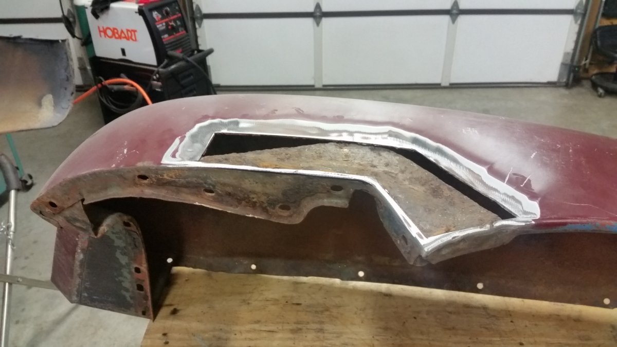

    VERY NICE!, where did you get the fender bottom sections?

    Early Ford Store.
    They're pricey but I was getting tired of making the bottoms. Worked out well.

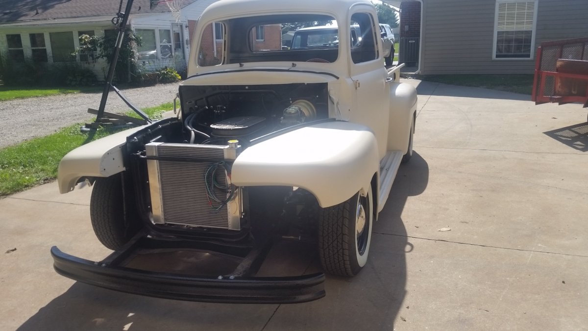

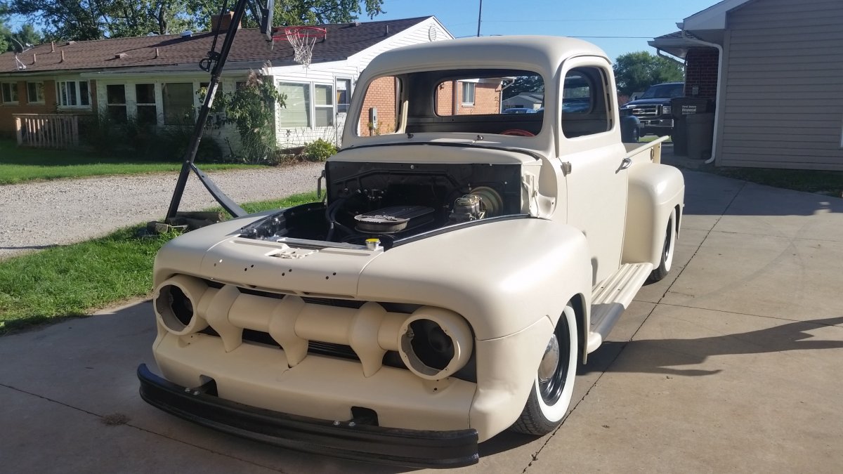

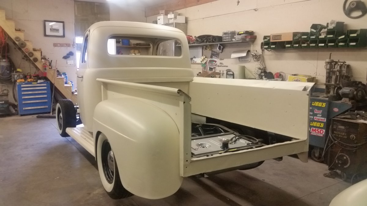

    Getting closer.
    Should be able to get exhaust done next week.
    It runs and stops. 20171009_185040.jpg 20171012_135753.jpg 20171012_135803.jpg 20171012_135827.jpg

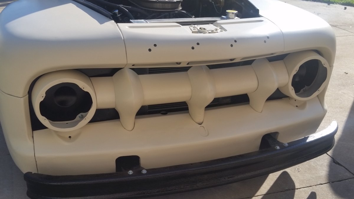

    20171014_162821.jpg Finishing up the nose today.
    Interior and gl*** next week.
    Evidently there is little interest in trucks here. Oh well, I'll keep posting til it's done. 20171014_162749.jpg 20171014_162715.jpg

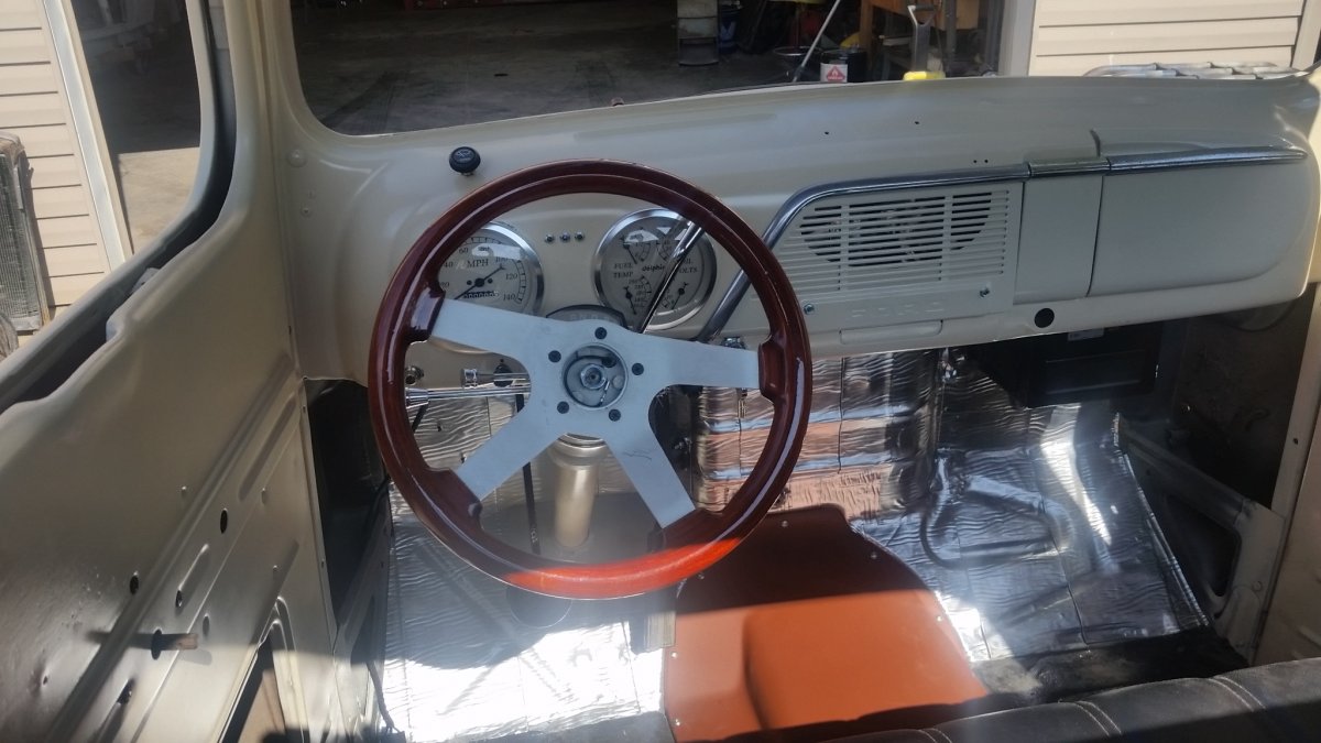

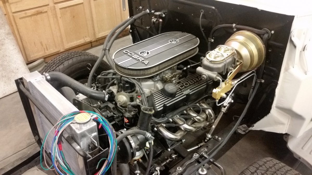

    Gas tank is a universal from Tanks Inc.
    Column is a CCP unit and gauges are Dolphins. Radiator is off Ebay 22"x19"

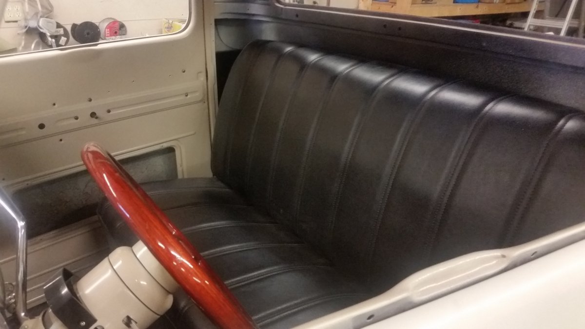

    The seat is stock but recut and padded.
    I cut the riser almost 3".
