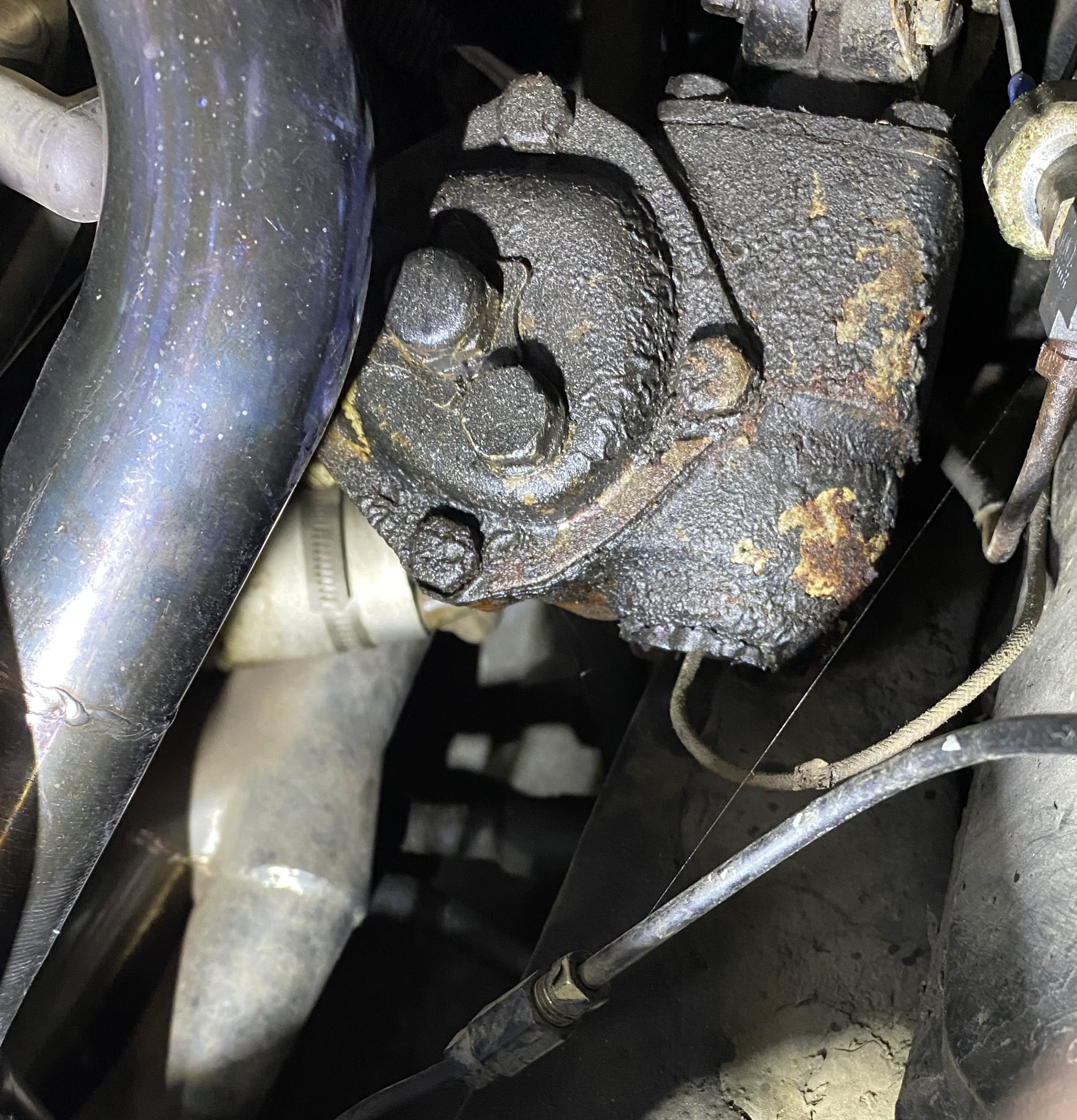

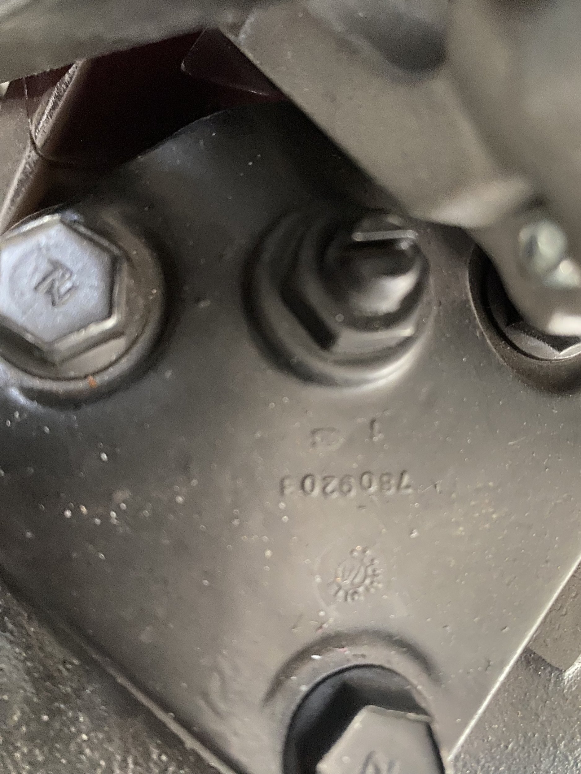

    I just picked up a 52 Ford Victoria today and the steering is really sloppy. The steering box is different than a shoebox in that it doesn’t have the screwdriver tang adjustment feature. There are 2 bolts on top instead. See pics. I also included a pic of the Vega box in my roadster to help explain. How is the 52 box adjusted?

  3. The adjuster with the slot is under the acorn style nut on the left with the star washer.
