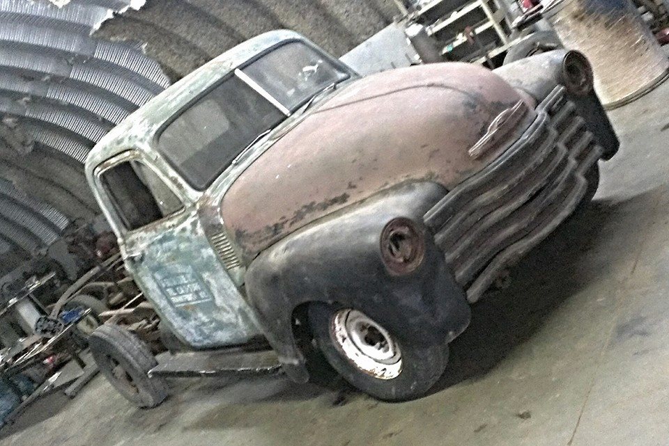

    the further I take it apart the more I'm worried I won't have much of a cab left to fix, I'll probably have to tack some braces between the door posts and so on before I ever attempt to lift it off the frame
    it doesn't look as bad in the pics as it really is, the area around the front cab mounts/door posts is in really bad shape, not much left holding it together. I think I may order patch panels for the parts that will show on the exterior and try to make the rest.

    one door, two pedals, and a few rusty bolts away from having the cab ready to pull off, I wanted to get the other door off too but it was hot and I had just finished a 12 hour shift.
    I need advice on the best way to brace the cab up to keep it stable and the best way to left it off the frame without damaging it. Where the front door post, rocker, and floor all meet, there's not a lot left and it's a really weak point and I don't want it to collapse when I lift it off.

    finally got the old bucket indoors before winter (took a while to clean the shop out)
    after a long drawn out battle (and probably drilling too many holes) I finally got the left cowl panel(?) off. I need advice on which company sells the best fitting replacement panels. I noticed in another thread where a person who got their panels from LMC had to extend them about an inch or so to make them fit right. I know a blue million places sell panels, I just want to get the best for my money.
    I got bored the other night and started doodling. This is by no means my final plan, but it's an idea and something to keep me motivated to work on it.
    and as always, any tips on how to get this thing back in one piece are welcome, thanks
