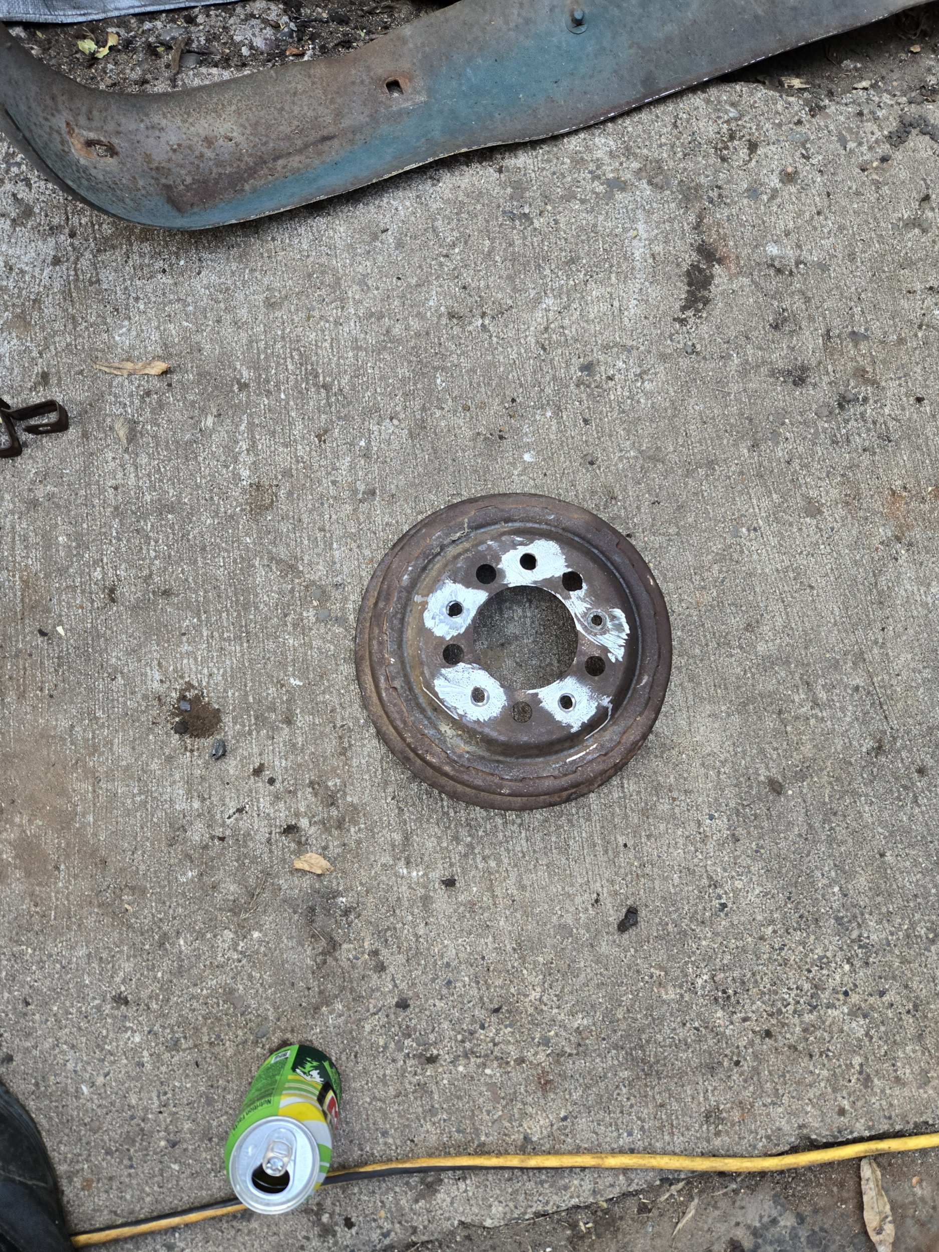

    So I am close to getting the j on the road. I am unable to get the rear drums off the car axle or the spare j axle I have. Fronts weren't to bad. The car axle drums spin freely with no binding. I extra axle was complete and brakes were locked and wouldn't budge. So........ on the spare axle I cut the rivets and rim locater then was able to work the drum off. They appear similar to my 55 chevy now. So here is my QUESTION, can I do the same thing to the set up in the car????? Most other drums on cars just slip on and off and now my spare j rearend is the same way. Do think this would be OK for the setup currently in the car????? I've been hesitant about doing it to the car set up but figured I'd try with the extra axle. I have tried hub pulleys, big hammers, loosening the castle nut and maintaining pressure.

    I am unfamiliar with Henry J's, but have seen applications where the drum is riveted (or screwed) to the hub. If this is the case, the above approach will probably only bend things with no positive result. A little more information from the O/P would be helpful. A couple of pictures would help.

    Rusty valley, thank you for adding this. That is exactly what I thought and why I decided to try it on spare rearend. Now the the drum just slips on and off like a normal more modern unit and the brakes are readily serviceable. The henry j uses screw in bolts/studs to hold the wheel on but the wheel is no problem getting on either. I really dont see any negative issues with the way I did it and that is the way my 51 chevy is set up and my sons 62 nova and 64 skylark, but really wanted to check with others before attempting the process on rearend thats in the car.. I obviously would use more care and caution on something I planed on actually using. Here are a couple pics

    As long as the drum registers on the center hole of the hub it should work fine.

    SUCCESS, I didcut the heads off the rivets carefully, then drilled the rivets slightly until until I could see it was about to release. Then moved to the next rivets. Repeat process. When I could see all 5 rivets were about to release then I lightly tapped with a hammer until they final released. Drum came right off. I was then able to do a brake job and replace the wheel cylinders. No problem at all. There was ******s of each rivets still pressed into the hub, so was able to locate the drum back onto these ******s, used 2 wheel bolts and adjusted the the brakes as needed. Removed wheel bolts and reinstalled wheels. DONE now I have a modern day serviceable setup. (This for the rear brakes) Front hubs and drums came right off no problem. Now I have all new brake lines, wheel cylinders, springs and hardware, shoes, power brake conversion, it's all new and the little bit I have diven the car itll stop really good. It's the first time this car has driven and stopped on its own in 30 years.
